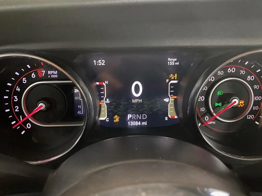

Does brake controller cause errors with ACC, stability control, when you press controller button?

Did you ever get yours working without the dash lighting up?

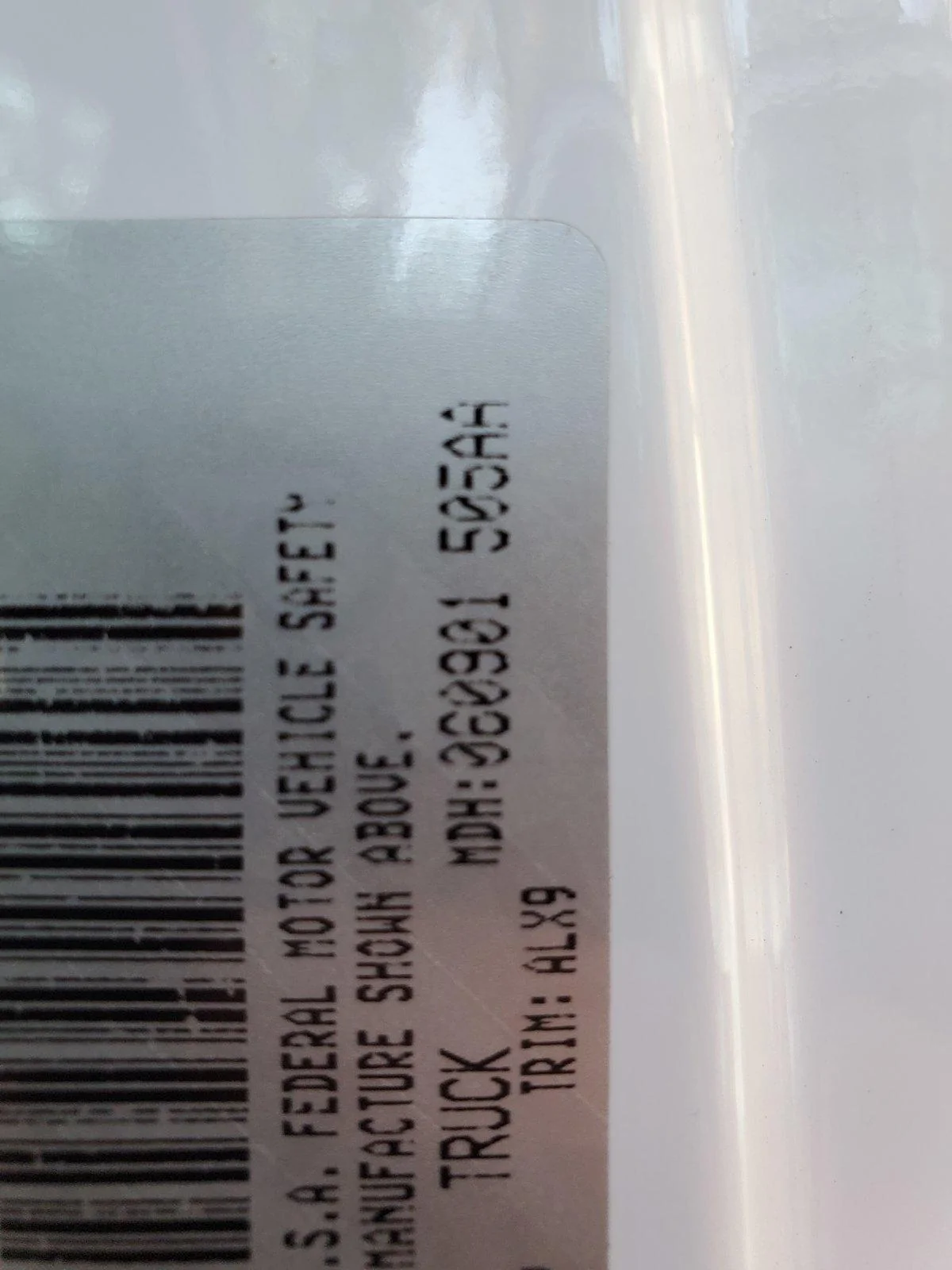

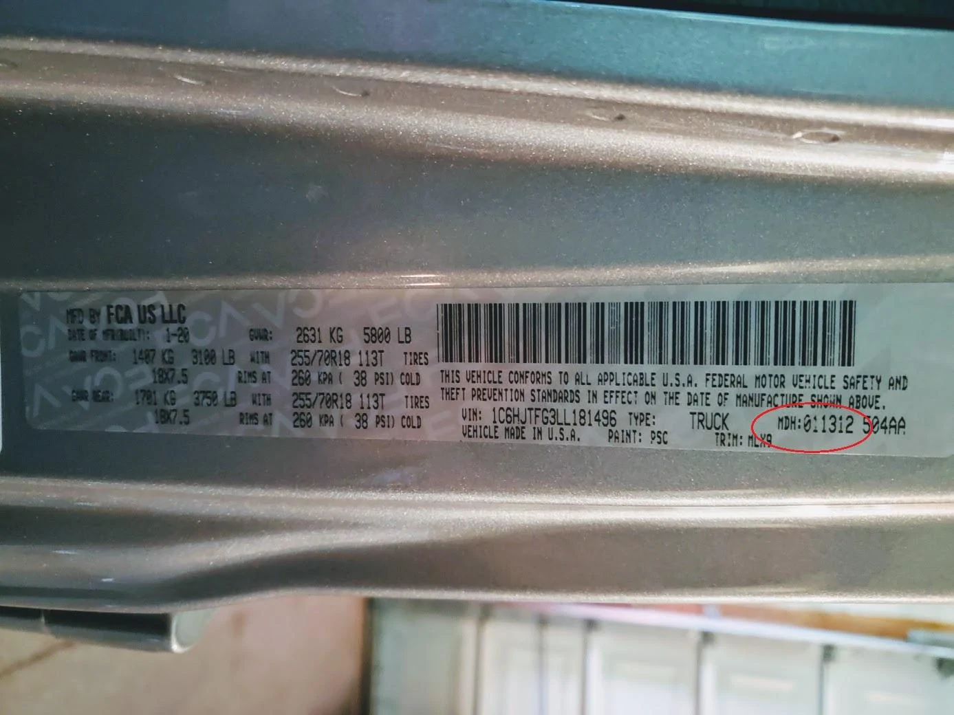

UserErrors?Build dateACC?LED lighting?
unixxxN11/04/21YY
