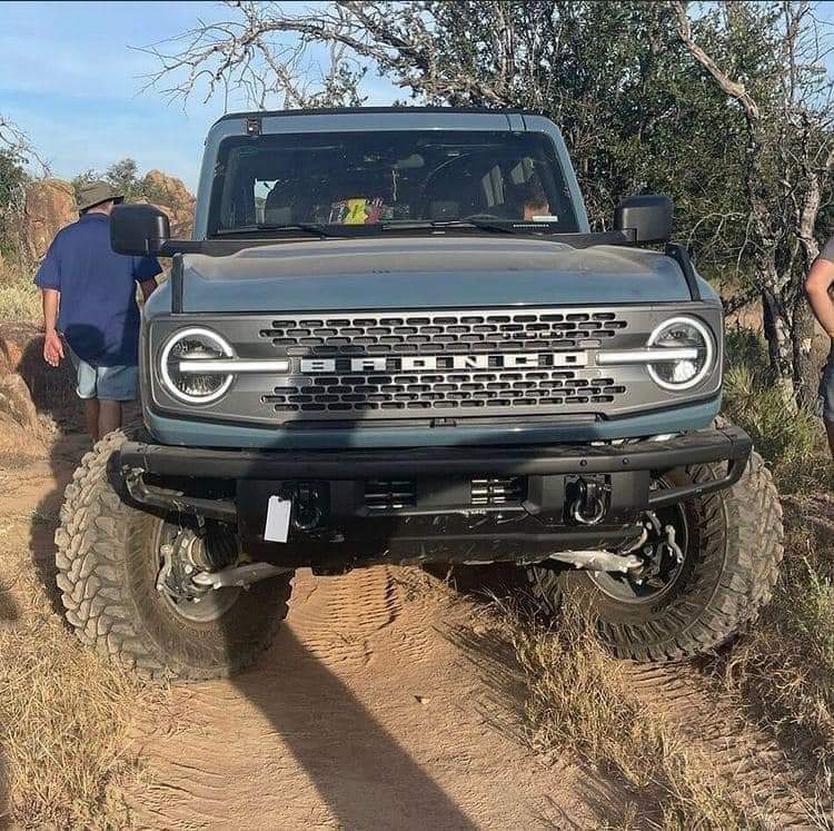

Your argument might be valid if Ford hadn't released the Bronco by showing it running around off road. They advertise it as an off road vehicle! In the case of the picture posted, the dealer refused to fix it because "the skid plates were scratched"! Ford jumped into the deep end without bothering to learn how to swim. Also, it isn't just the tie-rods that are breaking, the R&Ps are as well. IFS can be built to high standards but it cost 3 times what the vehicle cost in the first place.
Yes, someone will eventually come out with a better steering system, but until that happens, better treat it like a D30.
