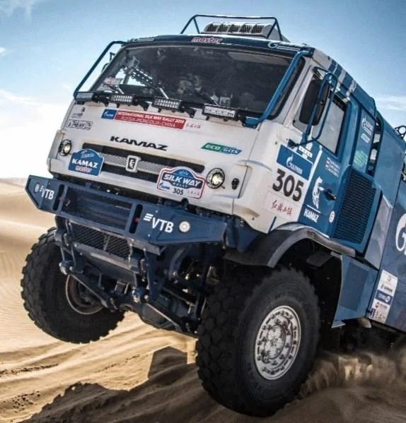

If you look at the set up on Dakar Rally trucks, they all have independent suspension on all ends. Of course they don’t climb trails, but do all terrain at very high speeds. Does not look that anyone has solid axles anymore.
I bolded the relavent point. High speed washboard is a much different requirement and stressor compared to rock climbing. I'd also mention that those are custom front suspensions with significantly strengthened 1 off components, steering racks etc, not mass produced cost effective parts.
Also the truck division is all solid front and rear, the car division not so much since they're basically prototype buggies but the trucks still roll on rhem

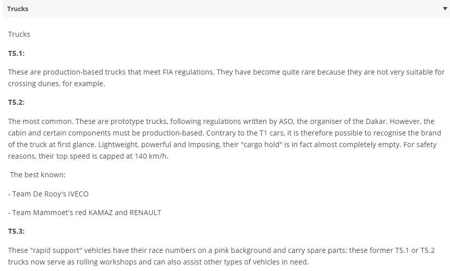

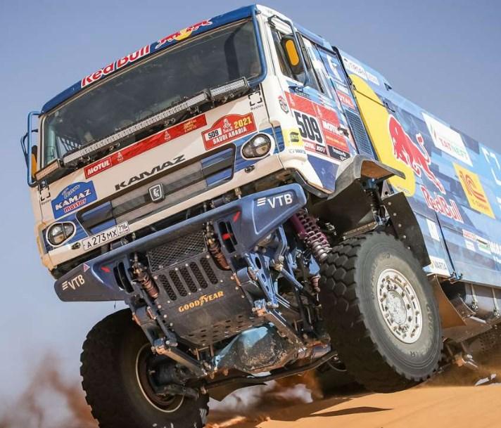

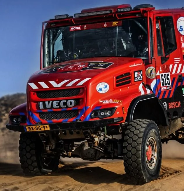

It appears all 'Dakar Trucks' have solid front axles.
'Truck class' from the official Dakar Website
Jeep Gladiator Poor Confused Bronco t5-class
Some examples
Jeep Gladiator Poor Confused Bronco t5-1
Jeep Gladiator Poor Confused Bronco t5-6
Jeep Gladiator Poor Confused Bronco t5-2
Great video

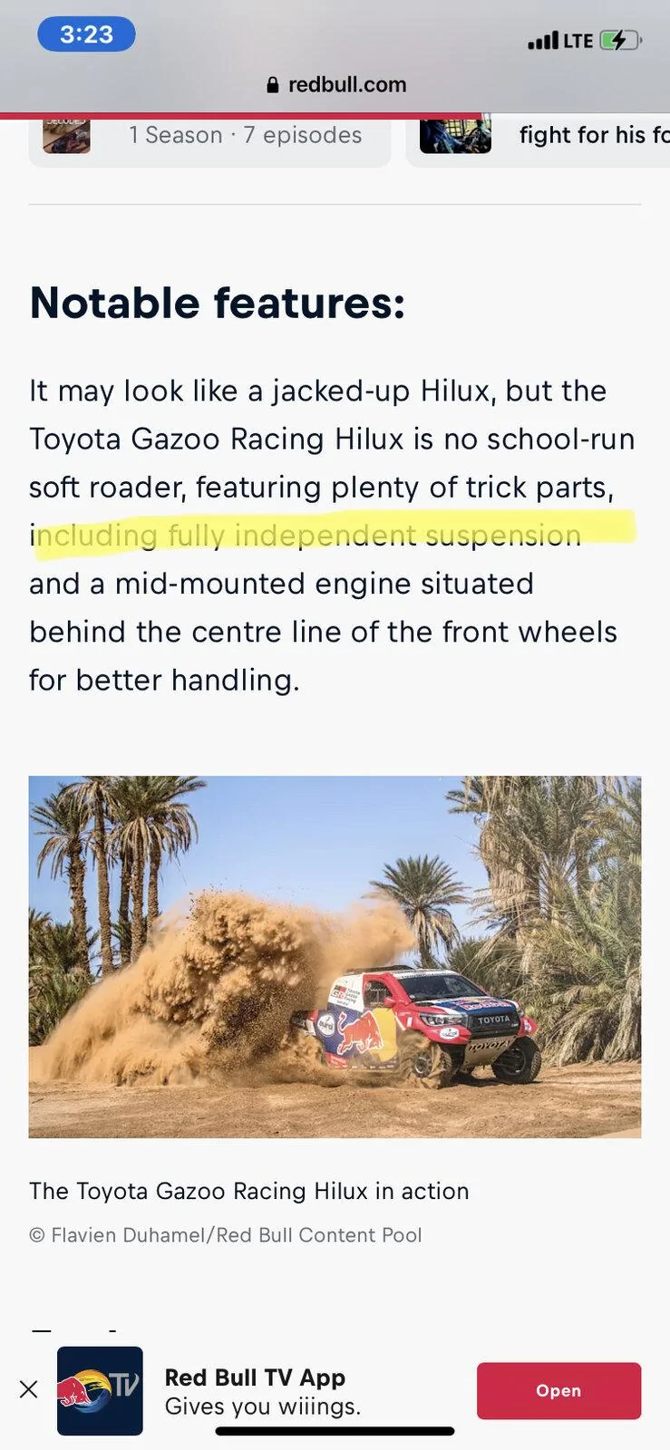

Big trucks yes, pickups like toyota hilux/tacoma not anymore. I think they swept the podium. But hey, there are nothing left from regular truck, fully racing machines. Looks like independent suspension is advantage for them.
Jeep Gladiator Poor Confused Bronco 4368F8D8-84B8-486B-B998-D2EAA2BC3C31
That thing is as much Hilux as my gladiator lol. Mid engined rally truck, crazy.
I know, right? Some modified gladiators in this forum probably would do better than hiluxes in Dakar.
