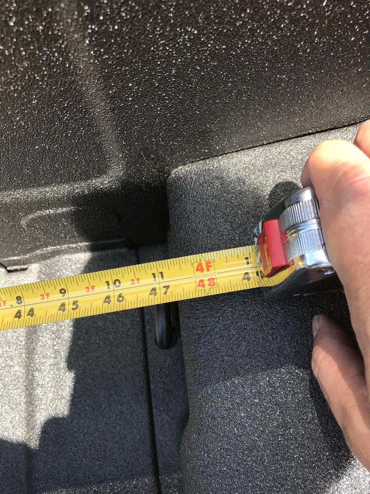

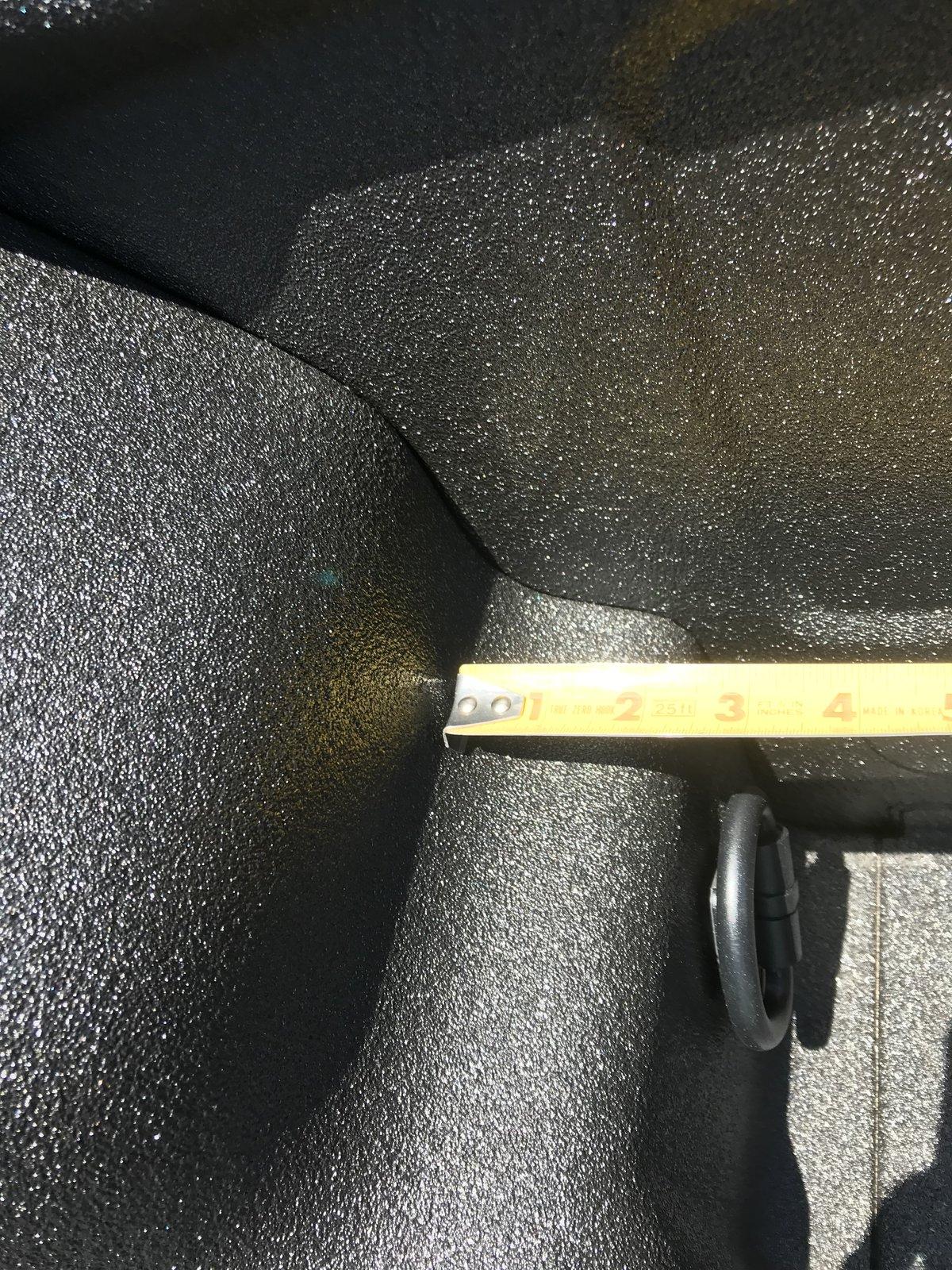

Ok folks I now have an answer to the question. And Iron Wolfpack huge apologies. I incorrectly thought that the silver truck in top picture was a Gladiator. Now looking closer I can now see that it is not a Gladiator, my bad.
Earlier today I got a call from a local dealer to let me know that he just got 2 Gladiators in. I took a tape measure to the bed and a sheet of plywood will fit, will have to sit on the little lip beside the gas pipe buldge. And you really will have to put a piece of 2X4 across the wheel wells as plywood would just barely sit on the passenger side wheel well. And this is why you would really need to put a 2X4 across the bed over the wheel wells plus the supports that Jeep advised about in their bed loading instructions.

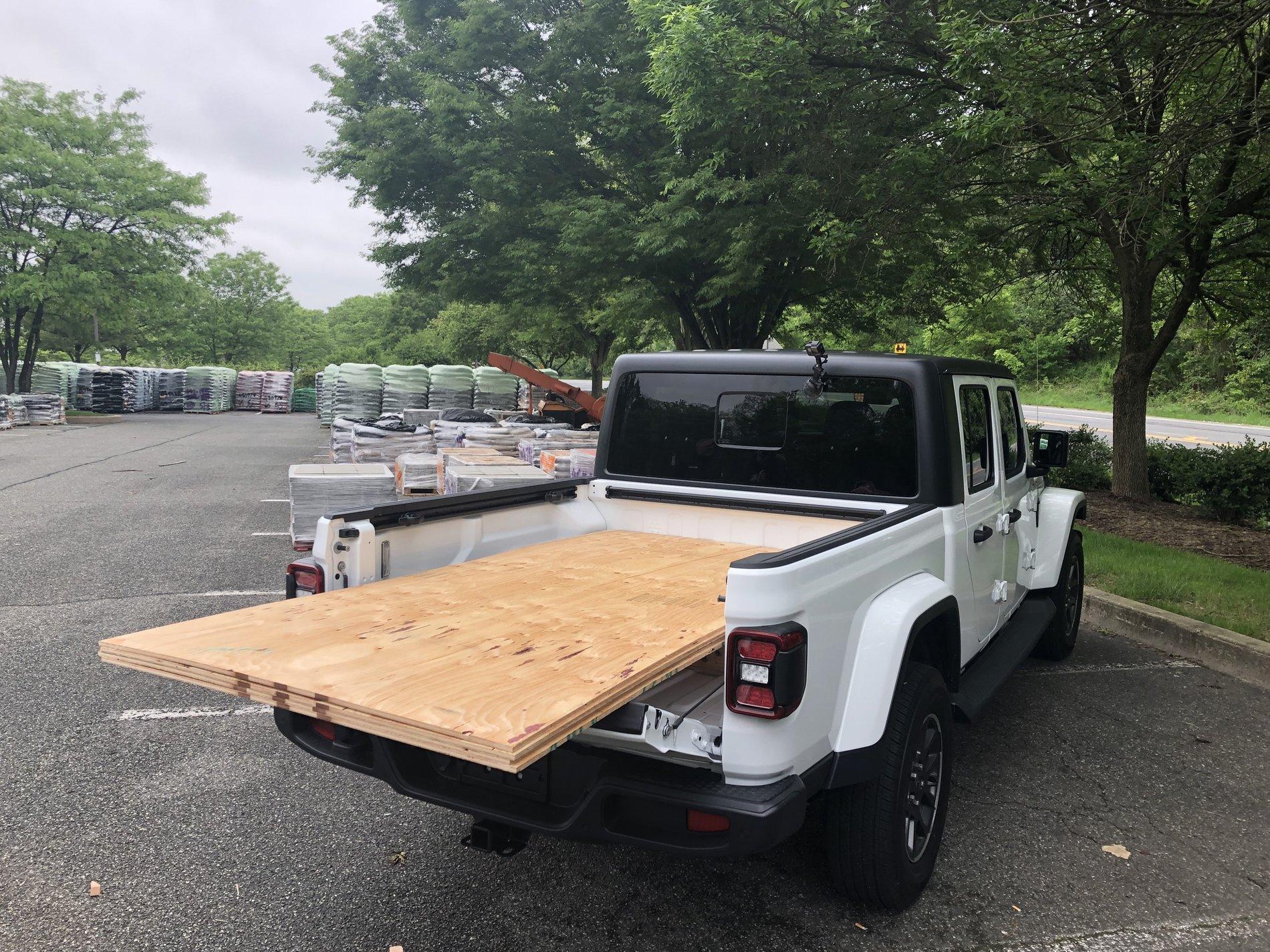

A full 4x8 sheet of plywood fits just fine in the bed... ask me how i know! :like:
It doesn't hit the fuel filler bump at all.
Winner Winner Chicken Dinner!
Though I do disagree with the comment that "you are ready to haul all the plywood that you need." There is a 300 lb limit in the "plywood" position...
So now that the owners manual is out (https://www.jeepgladiatorforum.com/forum/threads/gladiator-owners-manual-download-in-pdf.15679/), here's some PLYWOOD details.
  • The manual states that PLYWOOD should be supported as shown.
  • Max payload for the mid tailgate position is 300 lb. 3/4" PLYWOOD is about 60 lb/sheet, which means you can only carry 5 sheets of 3/4".
