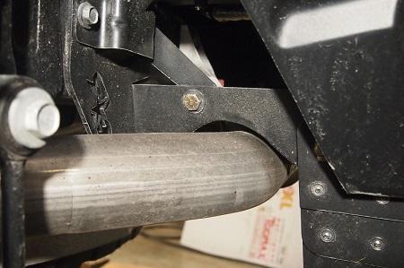

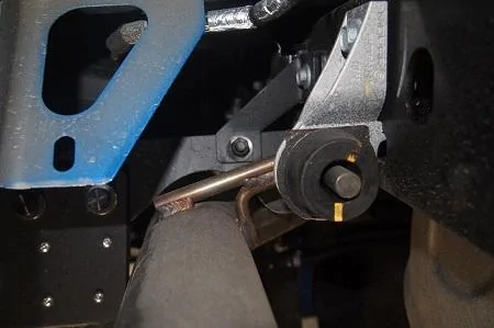

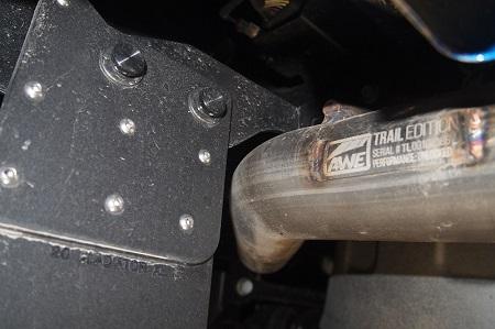

Have had the AWE Trail Edition system installed on my Mojave for two weeks & around 750 miles so far, and couldn't be happier. It's just the sound I was looking for, and the tone is getting even better as the miles go by! :like:
It did require a little "super customizing" to the driver side rear RokBlokz mount bracket for clearance, which I expected thanks to Kurt P's installation review video on another thread.
All in all, not a big deal. Just took a little extra time, and a little creative hacksaw action in the vise. Attached are a few pix of the trim job for clearance, Clarence. ;)
Happy you're happy, and nice trim job! Look's good. :like:

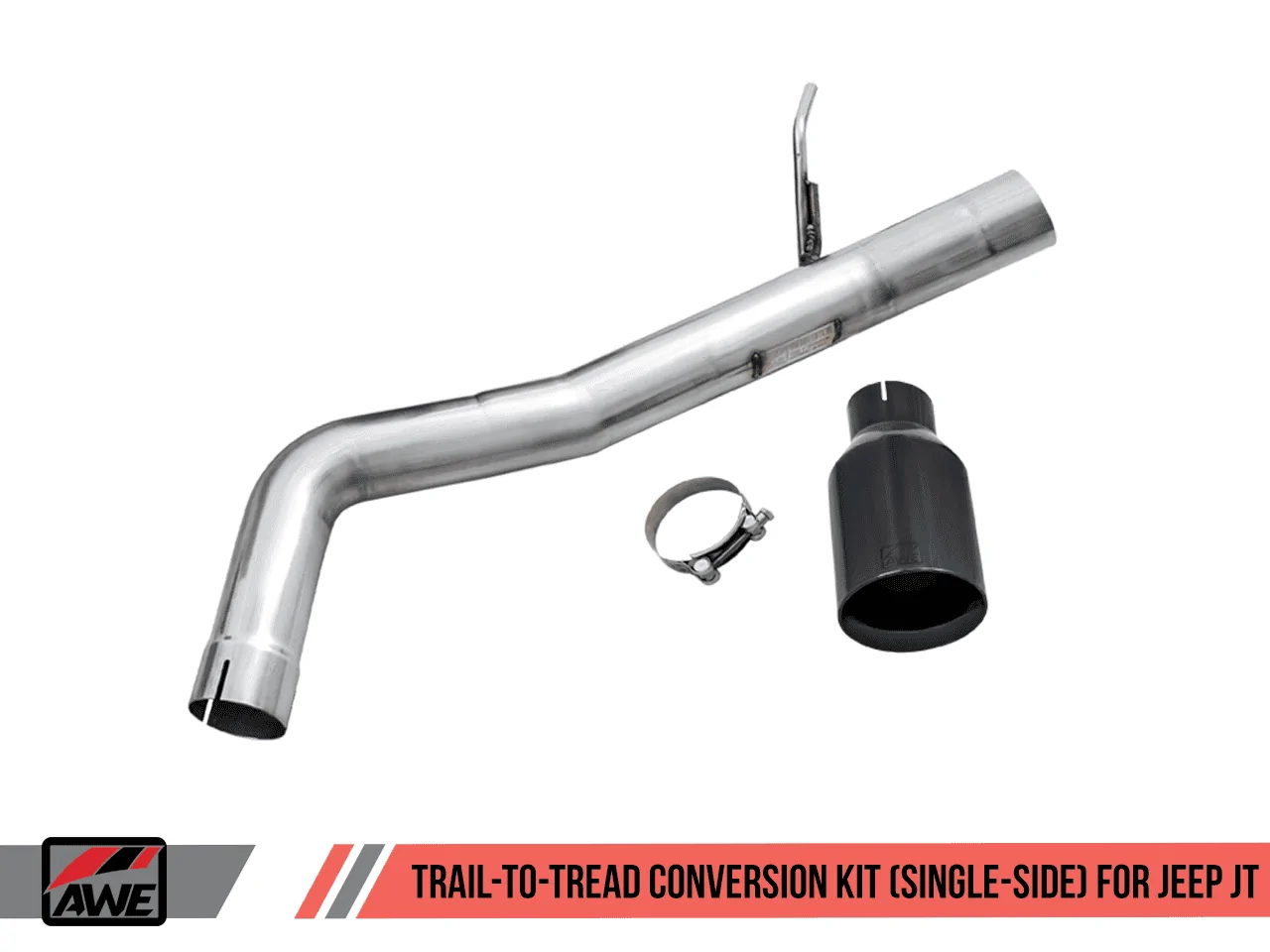

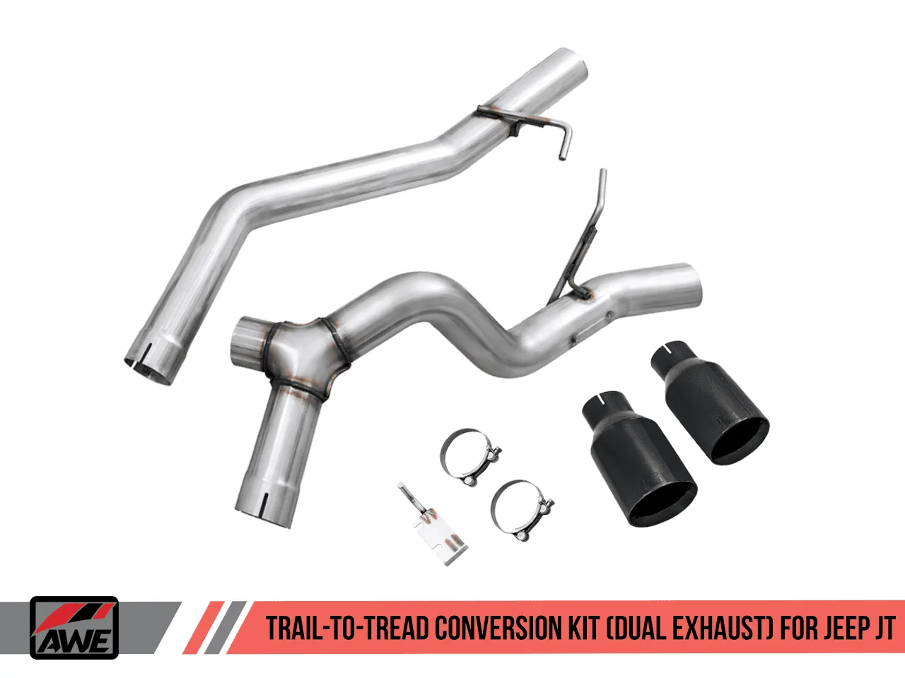

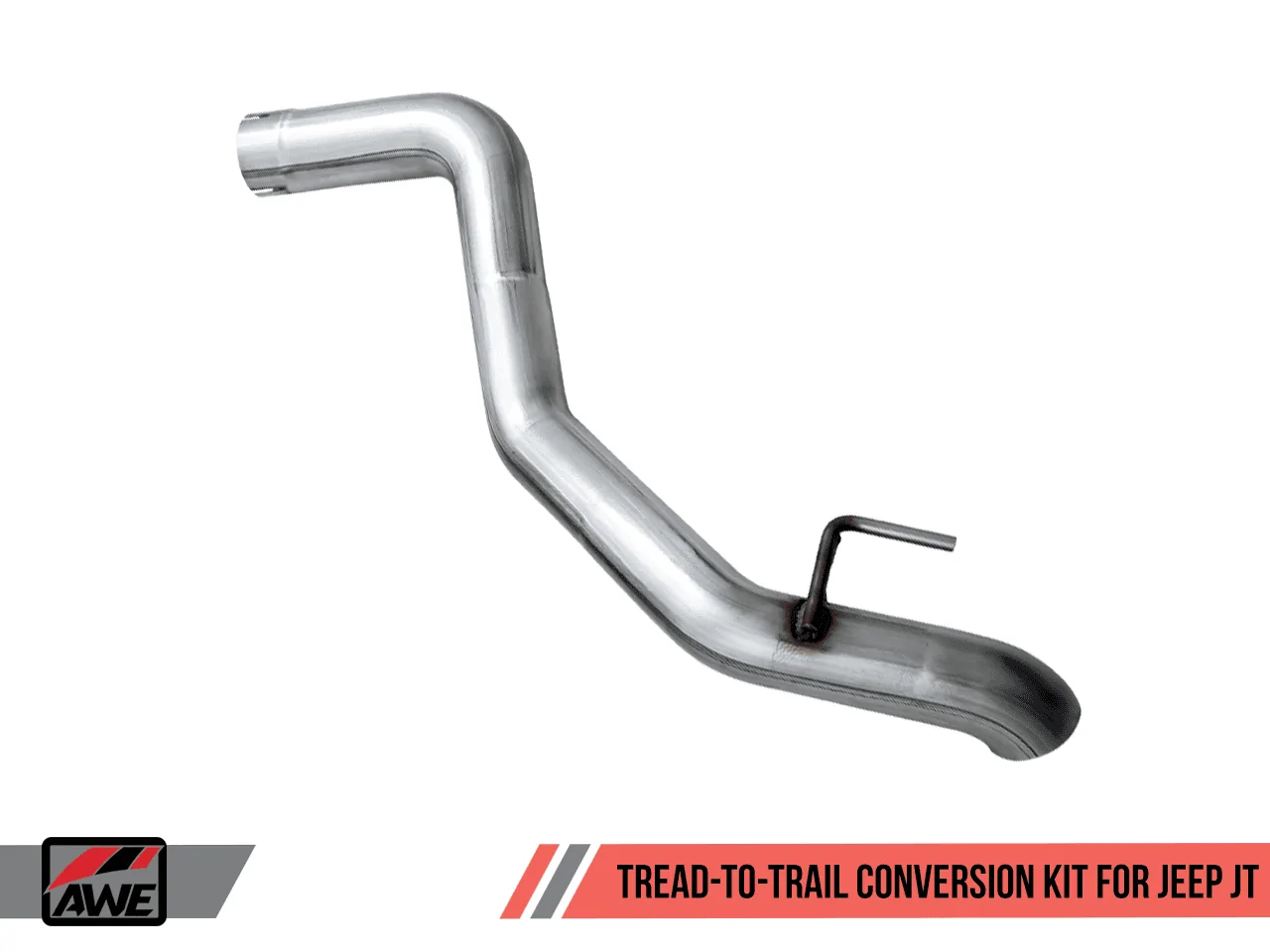

We're proud to present the new AWE Exhaust Conversion Kits for the Jeep JT Gladiator, available now:
  • Easily convert an existing AWE single or dual side Tread Edition into a Trall Edition, or an existing Tread Edition into a Trail Edition
  • Pure bolt-on, no-cutting required
  • Perfect Fitment Guaranteed
  • AWE No CEL Guarantee
  • Lifetime warranty
Why you would want this?
This product gives you the ability to choose your look between single or dual outlet, or prep your rig for the off road adventure you've been planning by simply replacing the outlet configuration of your system.
Jeep Gladiator Presenting the AWE Exhaust Suite for the JT Gladiator. Available now. [Images, Videos, Sound Clips, Dyno] 1f8625f9-6330-4d7a-84fc-14bda12c41c1
Jeep Gladiator Presenting the AWE Exhaust Suite for the JT Gladiator. Available now. [Images, Videos, Sound Clips, Dyno] 91e710ed-5986-4917-b621-e441ac7a10d5
Jeep Gladiator Presenting the AWE Exhaust Suite for the JT Gladiator. Available now. [Images, Videos, Sound Clips, Dyno] d59de03f-f7ae-413c-8828-f38a6f6bb785
