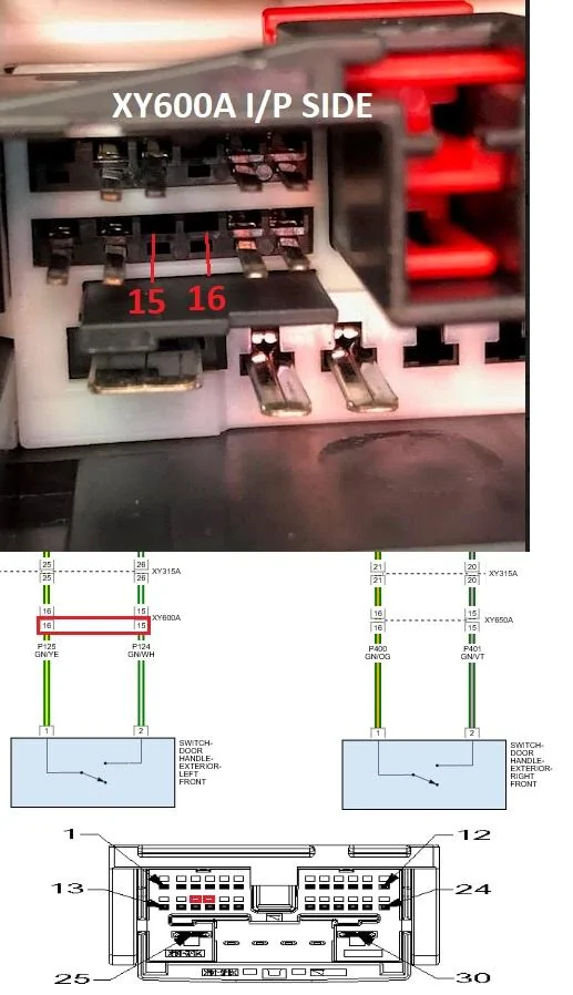

He is a VERY knowledgeable guy but yea....prolly wrong.
how would I know for sure?
Post #190 in this very thread will tell you which wires to look for in the door harness. No one will be able to look through the internet at your truck and tell you if the wires are there.
Gregj
40,514
54,043
My bet is he's referring to the wiring under the dash, from the door harness.
That DOES exist on Overland where it doesn't on sport.
It makes sense he's thinking of that wire.
Sport owners need to do additional wiring if I have that part correct.
Overland owners only need to add the door wiring harness, the dash harness has the wires.

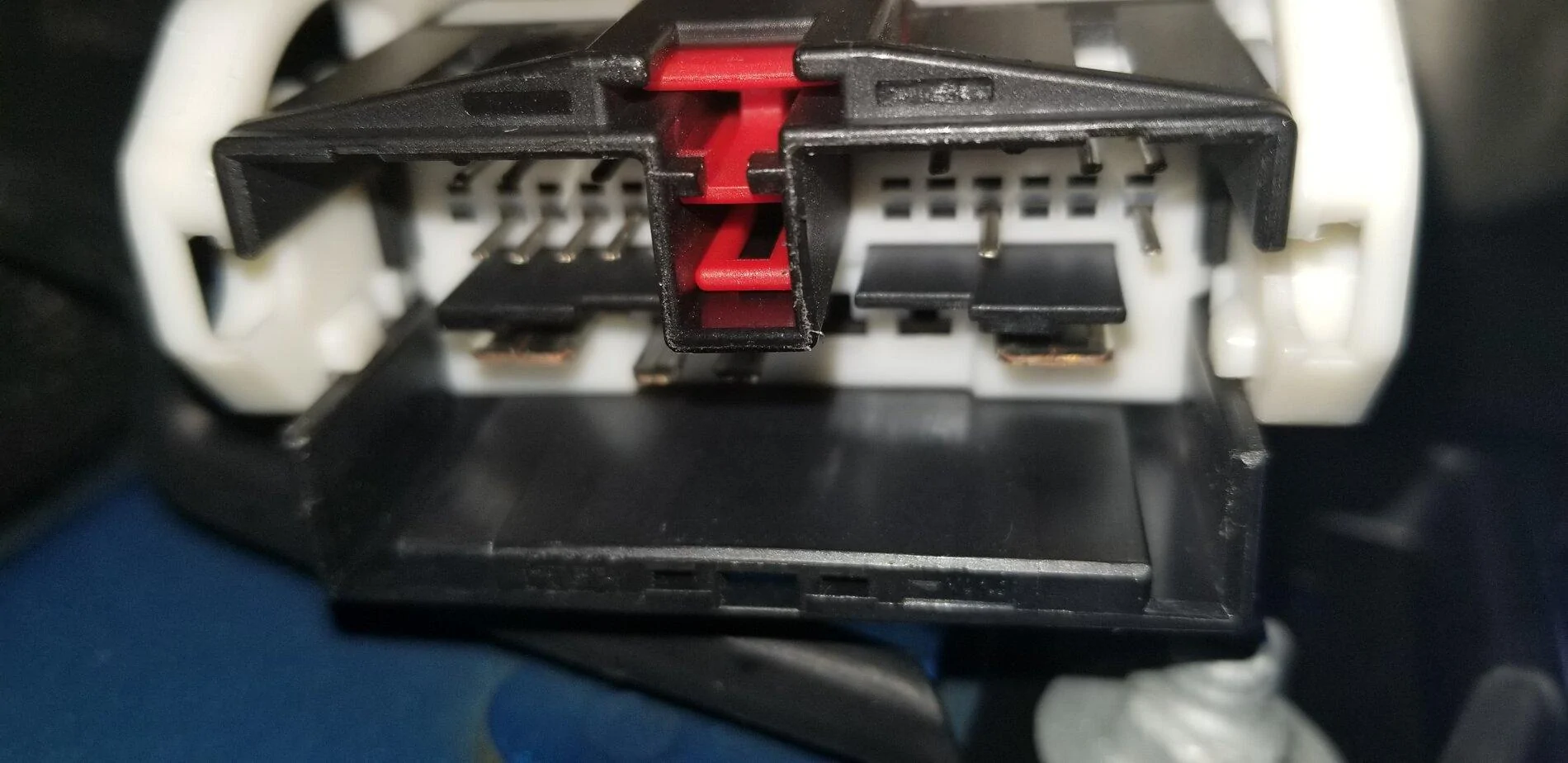

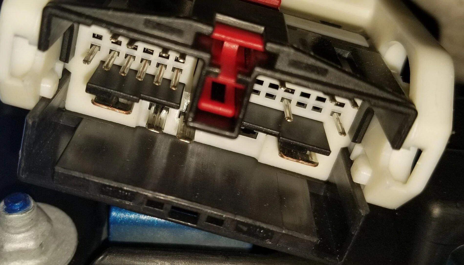

Now I'm confused...
According to this post on the JL Forums, it says that Sport S needs additional wiring installed for this mod to work... I've ripped/uploaded the photo from that post below:
Jeep Gladiator Proximity door locks retrofit on Wrangler/Gladiator, someone figured it out (DIY writeup) XY600AIP
Yet, when I look at the driver side connector on my Sport S, it appears as follows:
Jeep Gladiator Proximity door locks retrofit on Wrangler/Gladiator, someone figured it out (DIY writeup) 20201118_145624
Edit: Passenger side:
Jeep Gladiator Proximity door locks retrofit on Wrangler/Gladiator, someone figured it out (DIY writeup) 20201118_153344
Does this mean my Sport S already has the wiring in place???
40,514
54,043
Now I'm confused...
Wow, sure looks like it..........
