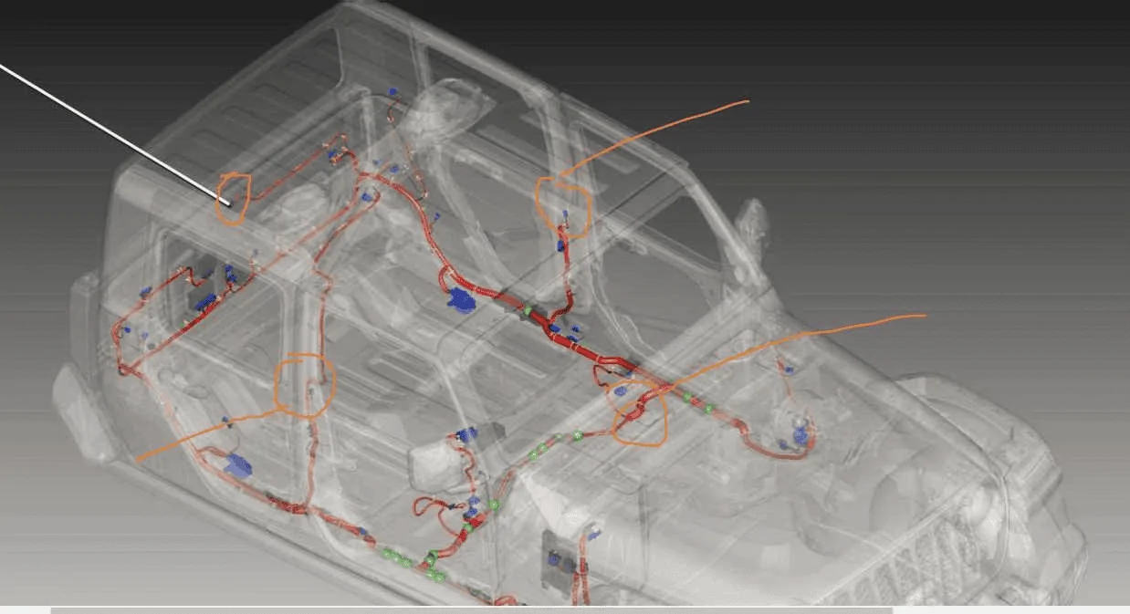

Ok, I got the 2 new sensors now I need a nice day off to play with the wiring and placement.. making my bubble bigger with 1 by the tailgate from the center rear connection is going to be my first attempt..
If you add the new antenna by the tailgate, and connect it to the center rear antenna in the cab, that won’t work for a proximity tailgate handle. The antenna at rear center in the cab is for detecting the fob inside the vehicle to be able to start it. If your tailgate antenna is tied to that one, and you are near the tailgate with the fob, there will be no response from the tailgate handle switch (lock/unlock) because the hub will think the fob is inside the vehicle and go into fobik safe mode. You must tie into one of the door antennas. Or, you could try using the dedicated rear liftgate/bumper antenna circuits on the C2 RF Hub connector, which would be pin 8 for the antenna signal, and pin 20 for the antenna return.

I thought the antenna behind the HVAC control was the one used for starting, if i remember right the jeep wont start for my wife when her purse is in the back seat with the FOB.
Gregj
Both front and rear antennas inside the vehicle are for starting and fobik safe, and won’t pick up for proximity handles. The ones in the doors are for outside proximity.
what's the location of the RF Hub?

Talk about a pain to try to get to that spot. Got to the one between the doors have to figure out some connection pins to fit in.
Which connector, specifically? I can get you the part number for the terminals.

The passenger side antenna connection it’s got a purple tab.
