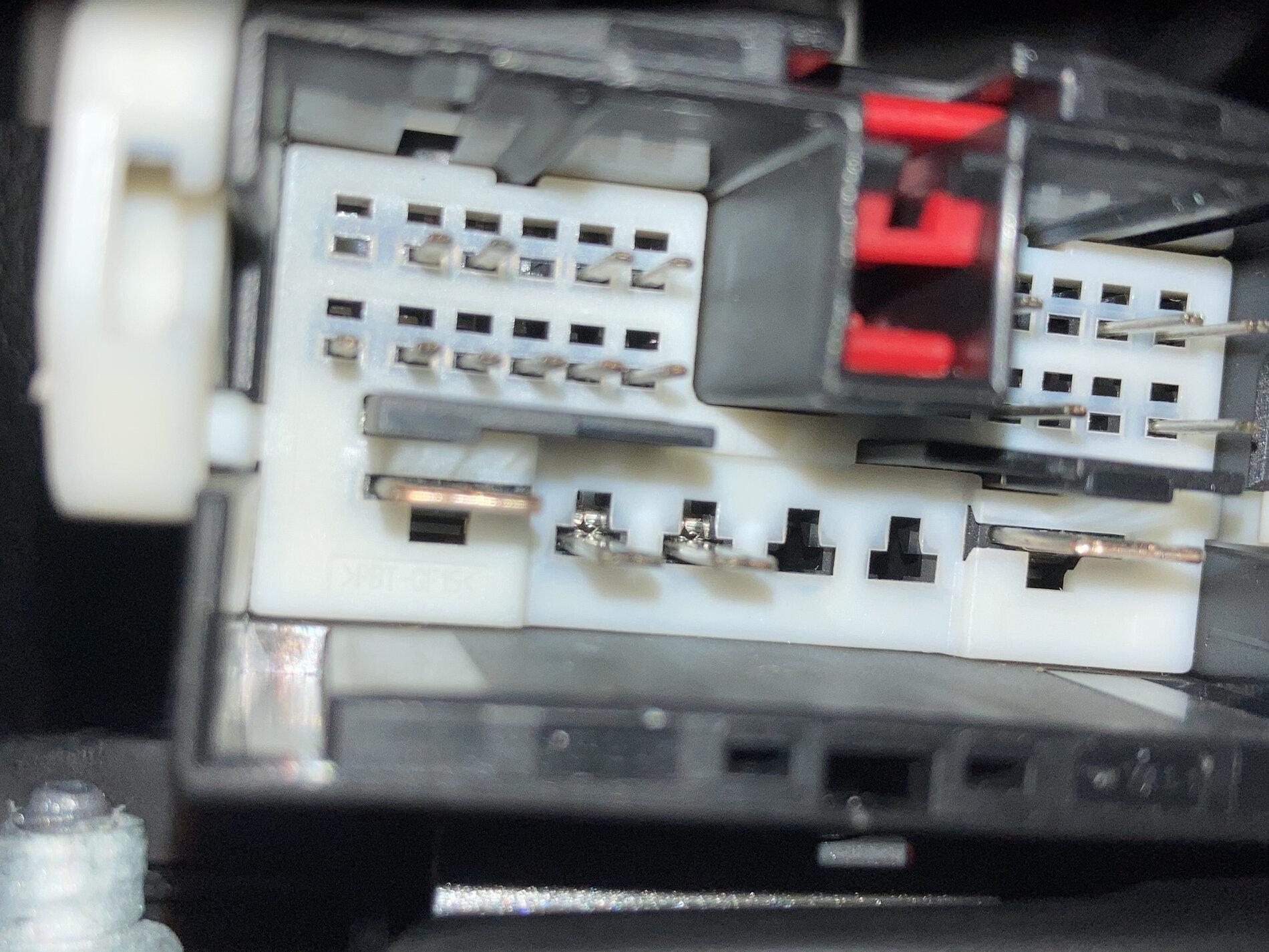

Hey Joebaseball, which pins did you bend? I installed the drivers (LF) side handle, cap, 333AF cable harness, programmed prox entry using Tazer a couple of days ago and get NOTHING from the handle.
Not trying to be condescending, but did you have your key on you when you tried it? And when you enabled it with the Tazer, did you do a full reboot after you made the change? Again, not trying to be condescending, just trying to help make sure nothing was overlooked.

1) look on the body side of the door connector for pins in the location in the photo.
2)yes that should be all you need
3)so far there have been no reports of success with the Tazer but I don’t think they would put it out without testing it.
4)Blind Spot Monitoring.
HTH

Thanks for providing this image. I just checked and it appears mine has the pins in locations 15 & 16 (image below). That said, no jumper would be required and I can just order the kit?

Great question, but if you are able to bend the harness from the Jeep to get a good clear picture it'll be quite obvious. I got the best picture in the daylight and simply twisted it a 1/4 turn or so. I actually had 2-3 bent. I just used a screwdriver to line them up with the others. Once I did the door lock all the sudden started working. I had previously already programmed the door via JScan.
Now I see why you said 'if you are able...'. I was finally able to capture a clear enough picture that identified two bent pins. It didn't start working just yet but I'll give it some time. Thanks for the advice.
Hey there. Yep, I had my giant keyfob in my front pocket so I'd be close to the door and have done several full reboots after I made the programming change. It seems to have stuck (it's enabled on the 8.4 " screen) and has been in that state for a couple of days.

Yeah, I'm an Iphone guy, she's Samsung. After several blurry shots I gave up and used hers. The Samsung seems to be better at closeups. In order to get a good head-on shot I could only get a couple inches away. Once I had a clear pic, as Greg on here suggested, it was pretty obvious I had a pin issue. Amazing those pins are so sensitive in an area that could be heavily used.
My iPhone, and my aging eyes, didn't cut it and had to borrow my son's Samsung! I'm very concerned about those sensitive pins as well. I'm usually pretty cautious about seating or unseating connectors and would have thought Jeep would have beefed up this connector. Don't remember even being slightly concerned about this disconnect on my 09 Wrangler.
Did you remember to set the AP1 (left) /AP2 (right) antenna to Smart Switch?
I found out it doesn’t work without the associated antenna enabled.

Did you remember to set the AF1 (left) /AF2 (right) antenna to Smart Switch?

Hi Kevin, I think those are JSCAN settings, correct? I'm not familiar with any antenna settings using a Tazer MINI.
Looks like you just need the parts and some programming.
Yes, JScan.
With JScan you need to enable the passive entry, turn on the UConnect passive entry setting, and enable the appropriate antennas.
How many settings does the Tazer have?
40,514
54,044
AP1 Left front > smart switch
AP2 right front > smart switch
Passive entry present > yes/ active
Passive entry CSM > yes/ active
