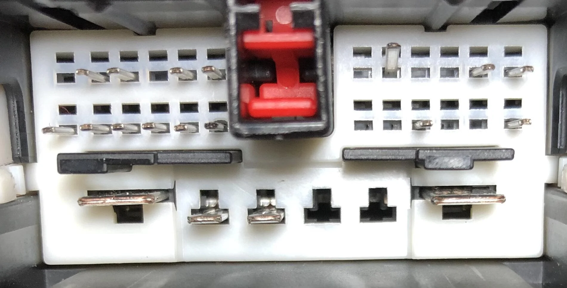

My iPhone, and my aging eyes, didn't cut it and had to borrow my son's Samsung! I'm very concerned about those sensitive pins as well. I'm usually pretty cautious about seating or unseating connectors and would have thought Jeep would have beefed up this connector. Don't remember even being slightly concerned about this disconnect on my 09 Wrangler.
Took the door apart again and checked for anything obvious...nothing. I was just about to ohm out the cable when I decided to de-program passive entry on the Tazer, let it sit for an hour, and re-programmed it. Everything works perfectly now...
