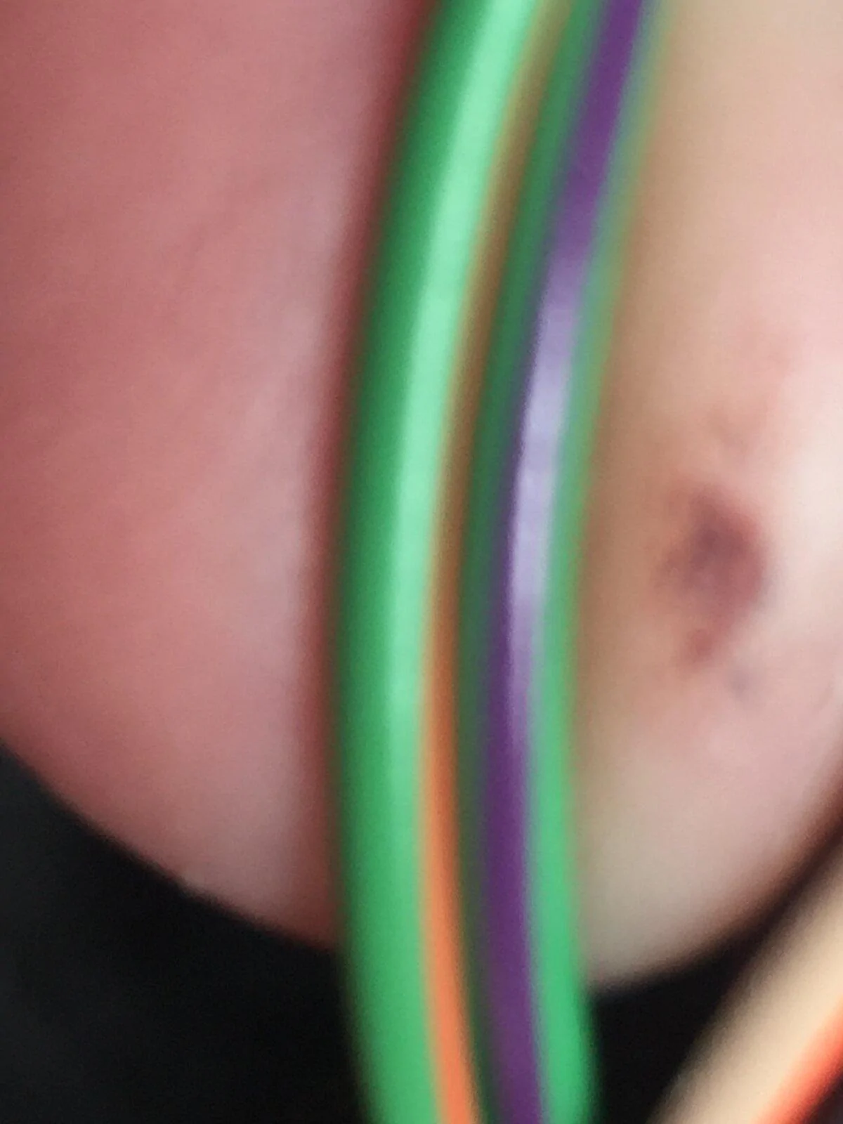

Passenger side is green/orange and green/violet. Kind of blurry but here they are.

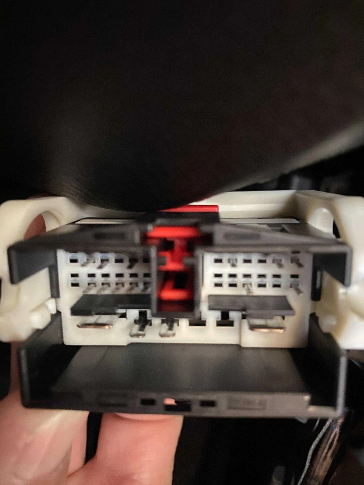

Passenger side interior plug looks to have 15/16 pins but I'm not seeing green/orange and green/violet on the door side. It looks like I've got grn/white in pin 16

I went and looked again and don’t see a green/white in there. I do see a white/green but it is on the other side of the connector, also a green/blue but it is a heavy gauge wire in the top row.

Chances are you don't have pins 15 & 16 on the door side: that's what the new door harness provides. You can simply look at the connector to see.

I'd be thoroughly shocked if any 2020 JT had those wires in the DOOR harness.
Cabin harness through the dash, yes, door harnesses in the doors, pretty sure that's a negative.
So far no one has found any 2020 JT to have those wires already existing in the DOOR harnesses.
