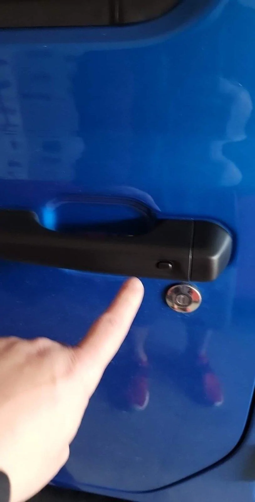

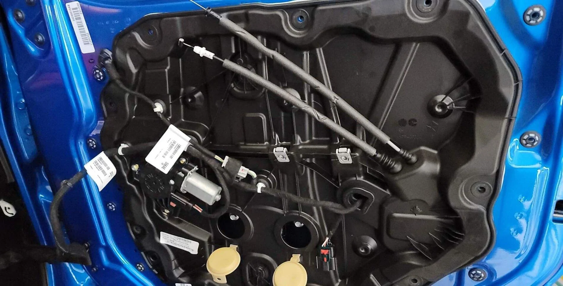

Finally got mine after almost 2 months. I ordered couple days before christmas on the same day I bought my gladiator.
The only thing my Mojave didn't come with just about was proximity key. I got it knocked out today and enabled with jscan. Wasn't hard at all. Just gotta take your time getting everything apart and replacing the door harness.
In regards to the window bolts. pick up on the window. it's the window blue and white bracket binding on the bolt when you are backing it out. They were no problem though. Just take your time.
And save money and just do it with jscan. no need for dealer or expensive tazer.
