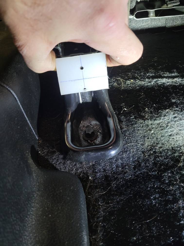

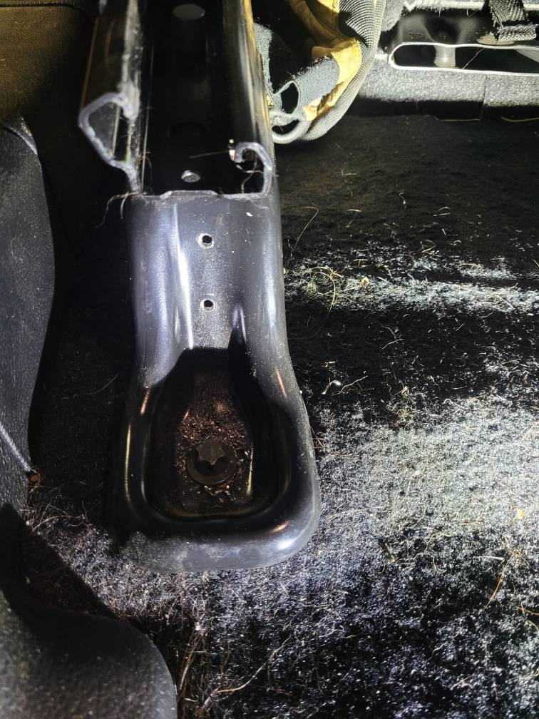

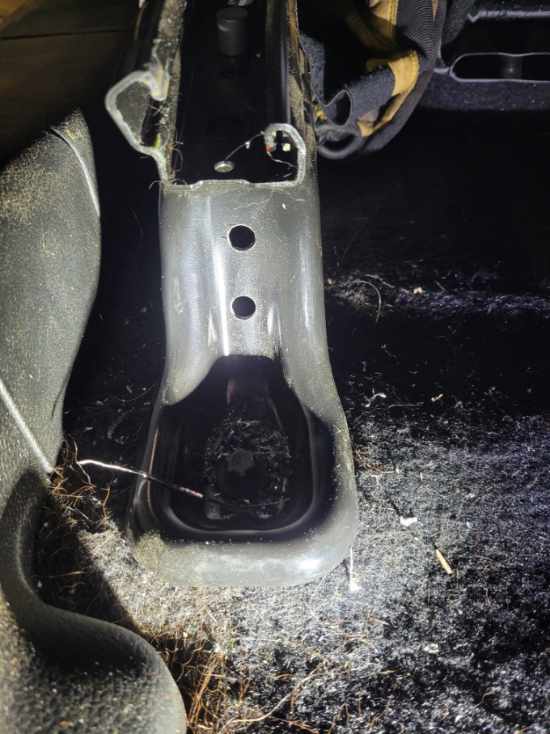

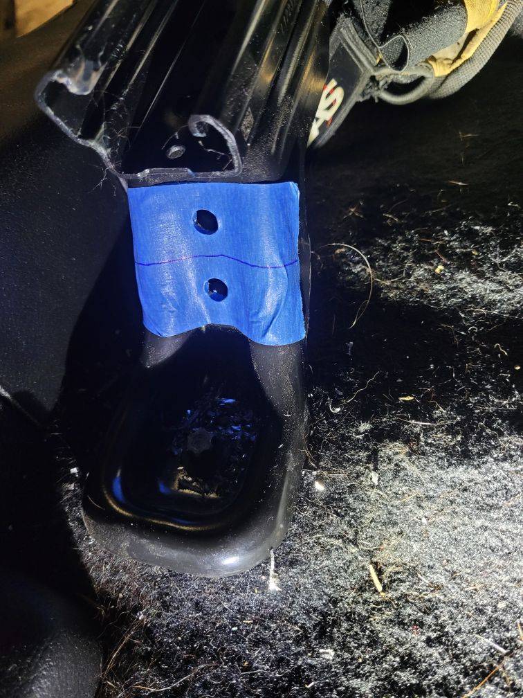

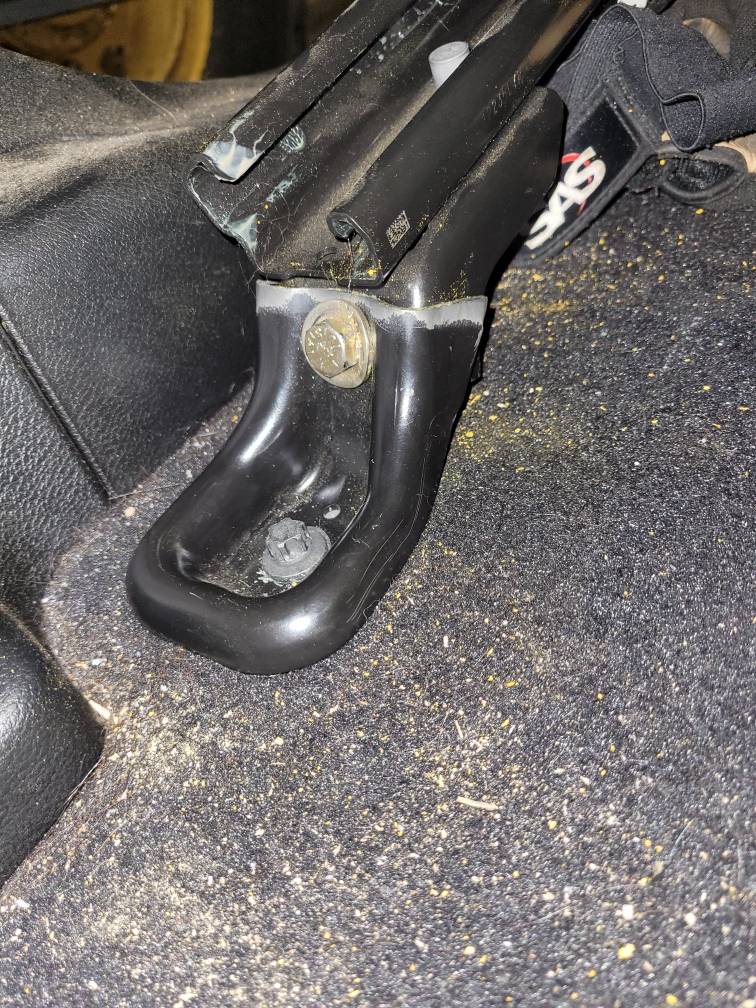

Here you go. I've gone back and adjusted the holes to lower the rear of the seat some more. I'd suggest 5/8 or 3/4 inch between the holes and cut line. A total of 1 1/4 or 1 1/2 inches between holes. Distance between the holes on the jig, will be the approximate drop of the rear of the seat.
2/12/23
DIY seat slammer.
Originally I did the "seat jackers", liked the angle, but didn't liked the "raised" feeling I got.
Made a little jig, spaced the holes by 1 inch. Hold it up against the slider and mark the holes. 0.5 inches from top edge to first hole, 0.5 inches to ink line, 0.5 inches to second hole.
Drill the holes.
Drill out to 5/16.
Line up the tape with the holes and then cut along the ink line.
Then I removed the lower portion of the leg. Deburred everything. Bent the points on the lower portion out slightly.
Placed the lower potion over the upper, aligned the holes I drilled, add a 5/16 bolt, reinstall the lower bolt into the floor. Slowly tighten both bolts until everything is tight.
I love the angle and now I don't feel like I'm sitting too high.
Try at your own risk, I take no responsibility. But I love mine.

I made a complete knock off set of DDI brackets and spacers with the intent of cutting the rail and slamming it. After seeing RudeJeepin’s post a while back, I did the diy slammed version just to see if I liked it. I felt like this way, I could ā€œfixā€ the rail back to stock height easier if I didn’t like it. I originally dropped it 1 1/4ā€ but felt that was too much so I used one of my knock off spacers to come back up 3/8ā€ for a total slam of 7/8ā€. Feels just right for me. Seats are still uncomfortable padding wise, but at least the angle feels better.
