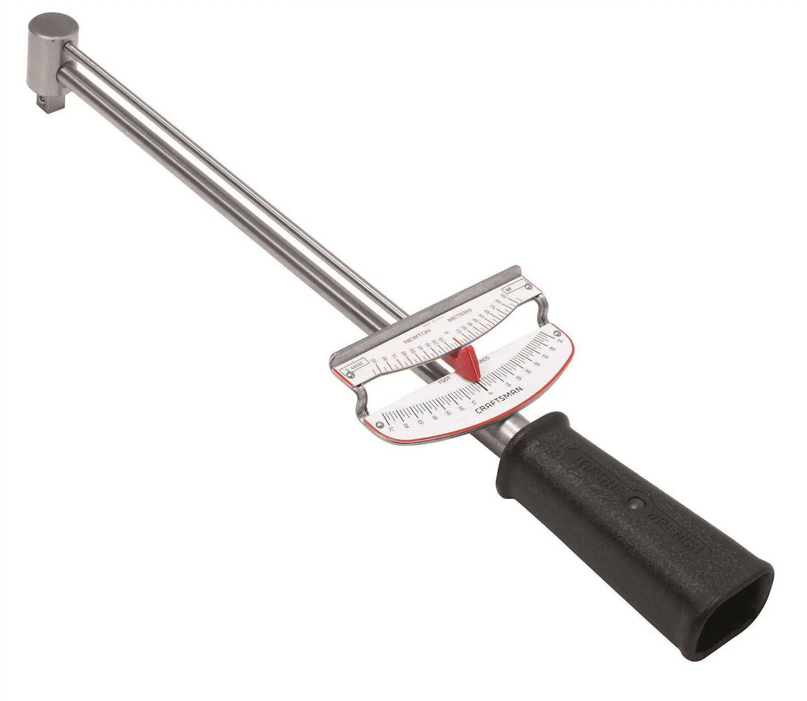

In my youth I used this (and I still have it and use it):
Jeep Gladiator Rant on Buying a Torque Wrench: How Frustrating! shc-944690_xv_xl
Calibration was eyeballing the pointer to see if it was at 0.
I am always distrustful of clicker torque wrenches, though I have several of them. With a beam wrench you can see it getting close. With a clicker you don't know how much farther you have to go before it clicks. Sometimes I feel like I'm putting on more torque than what I set it to (probably not, though, in reality) and I'll dial it back a bit just to hear it click, then I'll set it back to where it should be and continue on.

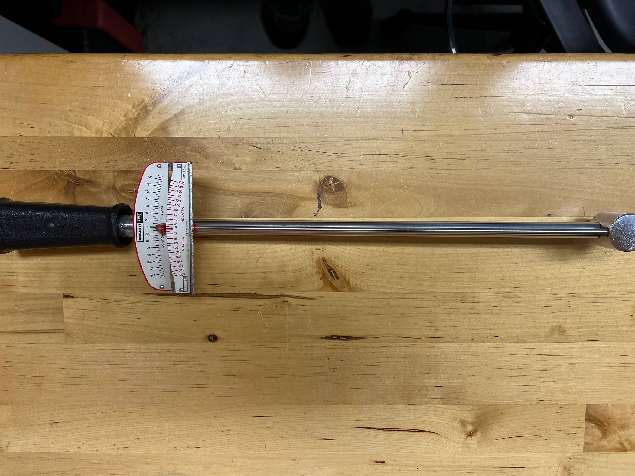

Still have mine also. I probably purchased this one in the early 80s.
Jeep Gladiator Rant on Buying a Torque Wrench: How Frustrating! IMG_3459

If you have a 8 point socket that will couple together the drive heads of both your beam and clicker torque wrench, you can do a "poor man's" calibration check of your clicker against the beam"
Clicker torque wrenches are usually pretty good so long as they are not dropped and not stored in anything but their lowest setting for long term storage. The thread torsion rod inside clicker torque wrenches will take a seat if not stored in their lowest setting and they occasionally need to be turned through there lowest to highest setting a handful of times ever so often to redistribute the factor lube on those thread. Buying used clicker torque wrenches is a pig in a poke situation for these various reasons of not knowing how they were used and store.
