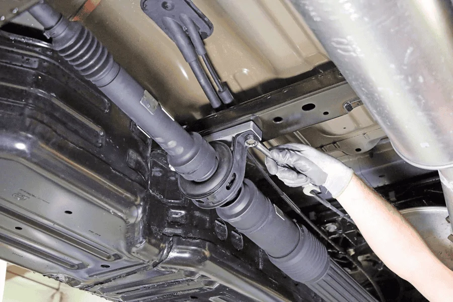

I changed my front driveshaft to an Adams.
The rear driveshaft angle is easily solved with a rockjock driveshaft carrier bearing spacer. This is easy to install and you can keep the rear drive shaft.
