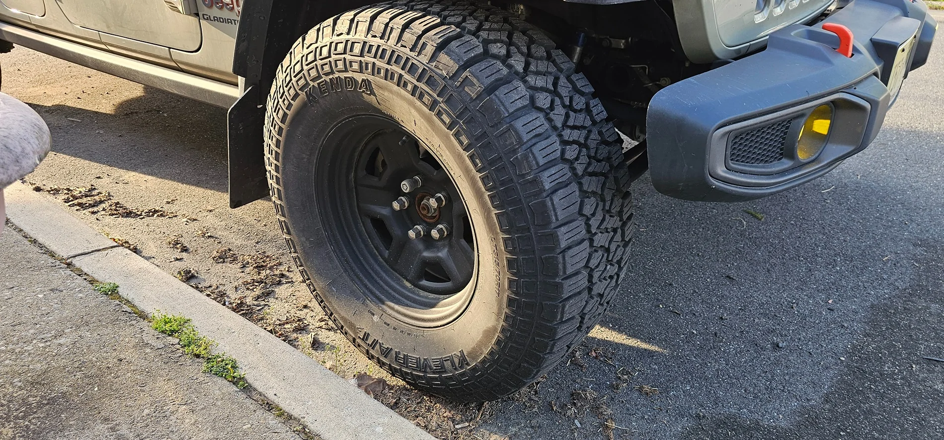

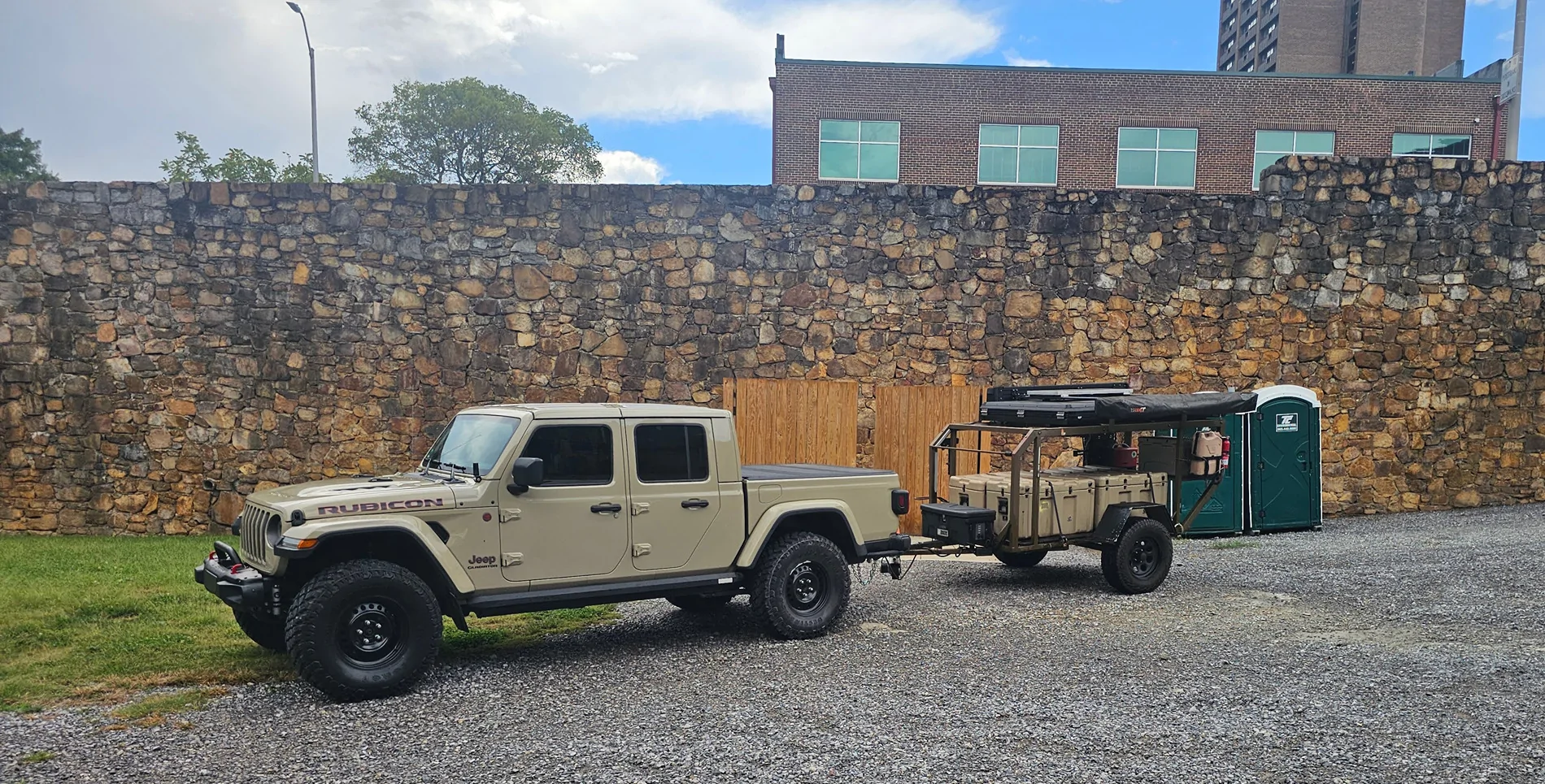

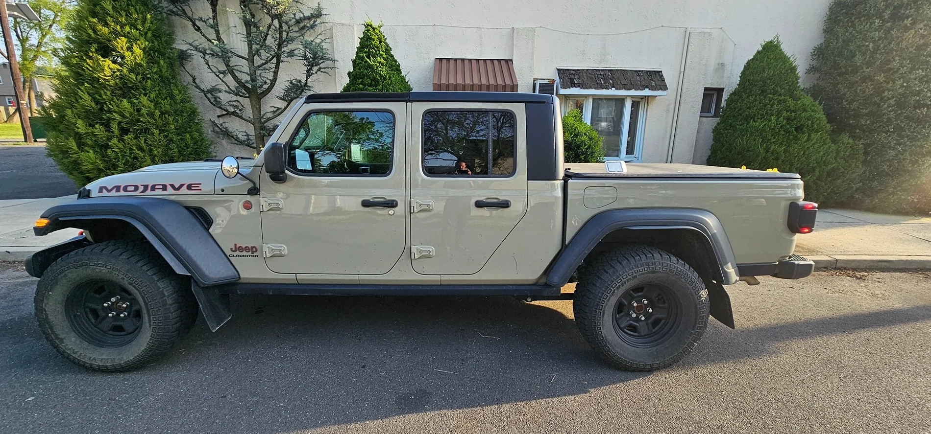

TACTIK 5 Spoke Classic Wheel 17x9
They are +6 and poke a little more than i'd like, but they work. The temporarily out of stocks usually don't last that long. They used to be a lot cheaper. I bought mine for like 72/ea on sale. I think they used to list for 85 or 90
As a bonus, you can see what they look like on a Gobi here:
Jeep Gladiator Recommend Inexpensive (not cheap) Off Road only Wheels for 35x12.5x17 20240428_182210
Jeep Gladiator Recommend Inexpensive (not cheap) Off Road only Wheels for 35x12.5x17 20240428_182323
