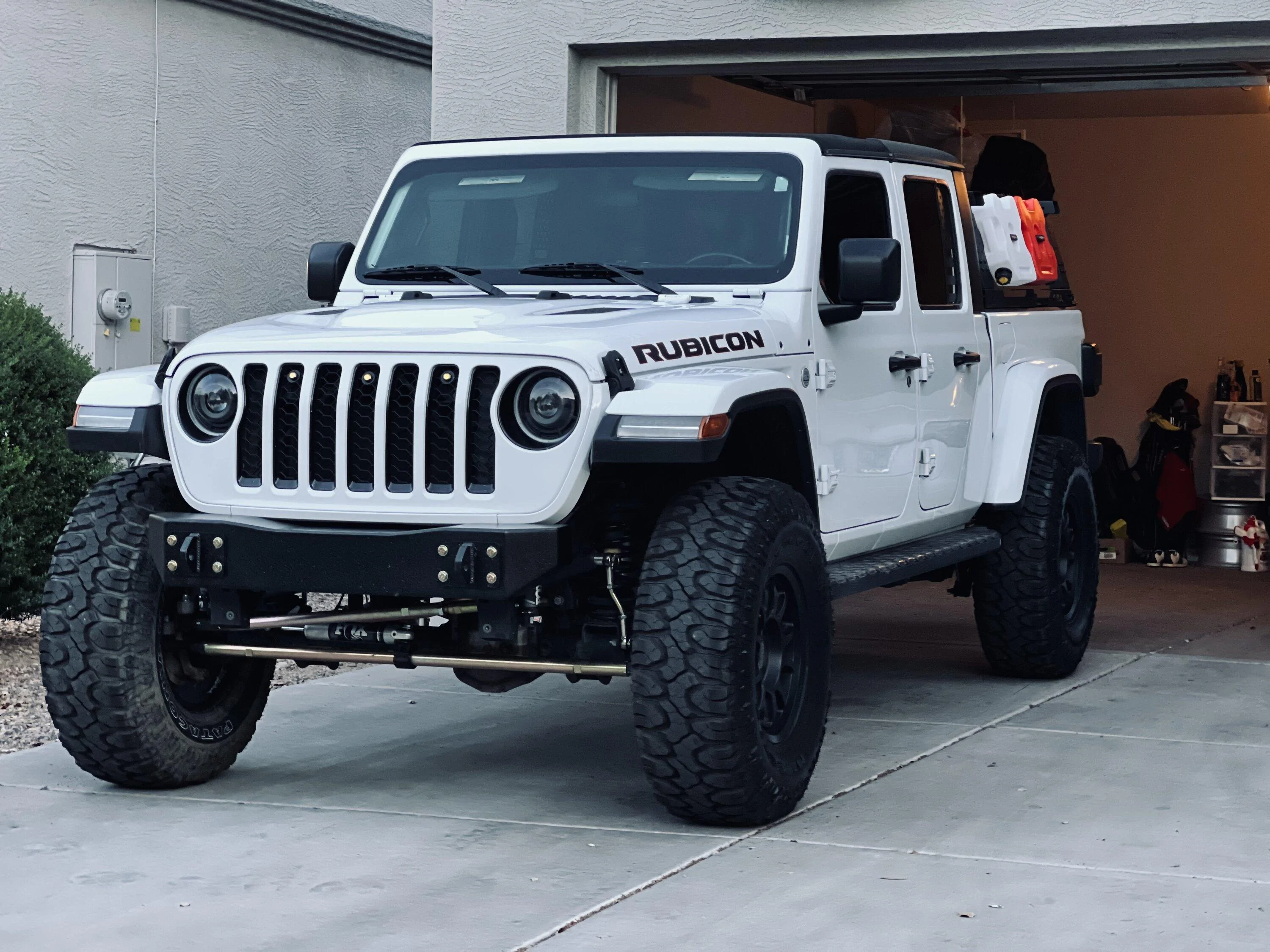

Over 10k miles on mine. I added the longer Mopar LCA’s and adjustable track bar. Rides great and no issues from me. Will eventually go to a spring lift for more height but no complaints from me. 37s as well.

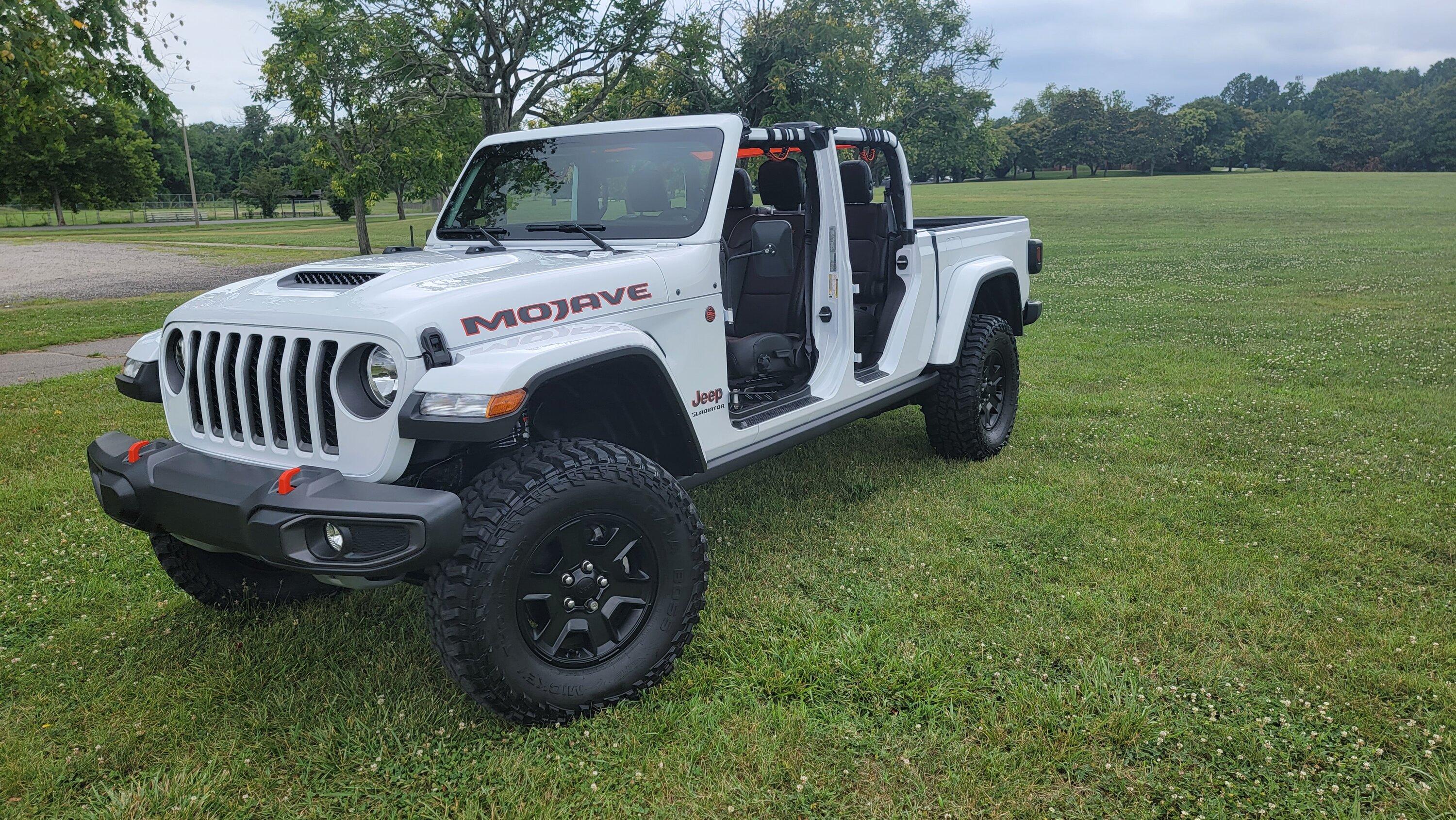

No issues w mine. No noticible difference in ride to me. I already had Jscan, so I didn't include the Pro Cal tuner. 35" 12.50 M/Ts. Still pondering wheels.

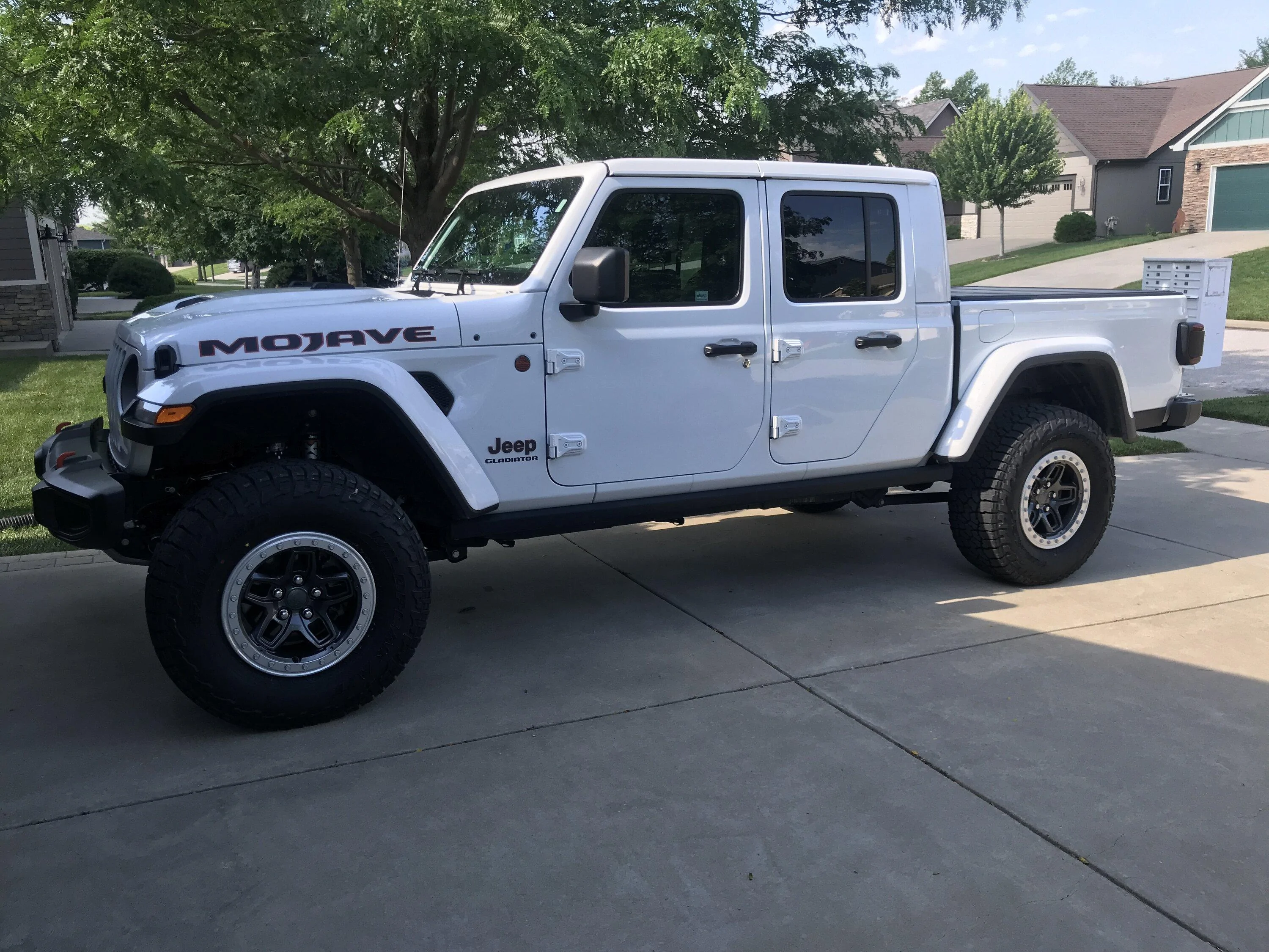

I've had mine about a month. Also installed the geo correction brackets. I stuck with a spacer lift to be able to keep my stock Mojave fox shocks and springs. No issues so far and I think it looks great with a little bigger of a tire. I have lt315s on mine. The procal tuner was nice and I was able to correct the speedo reading. Haven't needed to regear yet.
