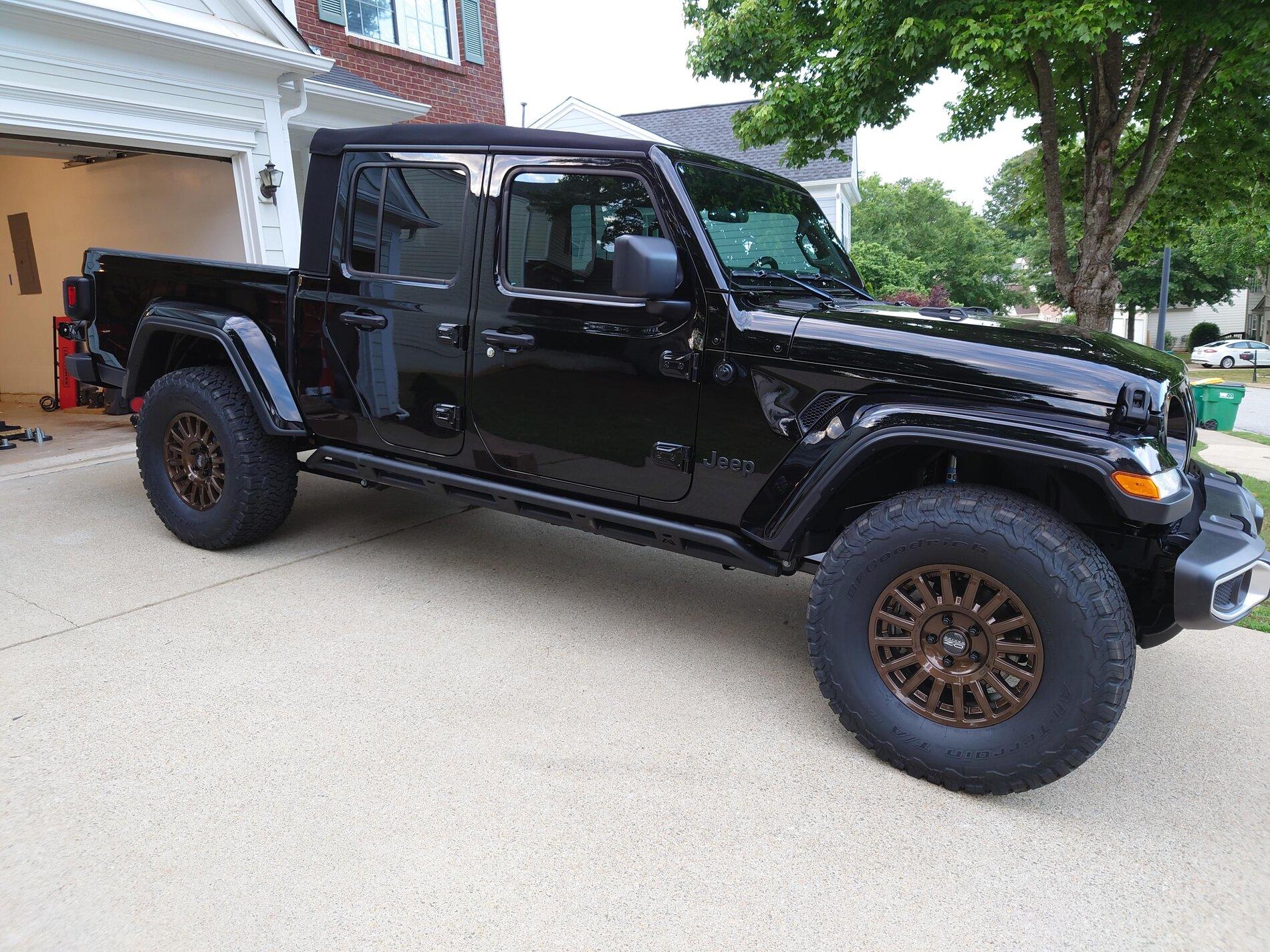

Aonarch
Alec
May 13, 2021
596
715
GA/ MT
Engineer
Fab Fours Rock Sliders. I just installed them and I am happy with the quality. Install was painless.
But if you do not have Rubicon rails from the factory you will need 8 M8x1.25x30 bolts and washers.

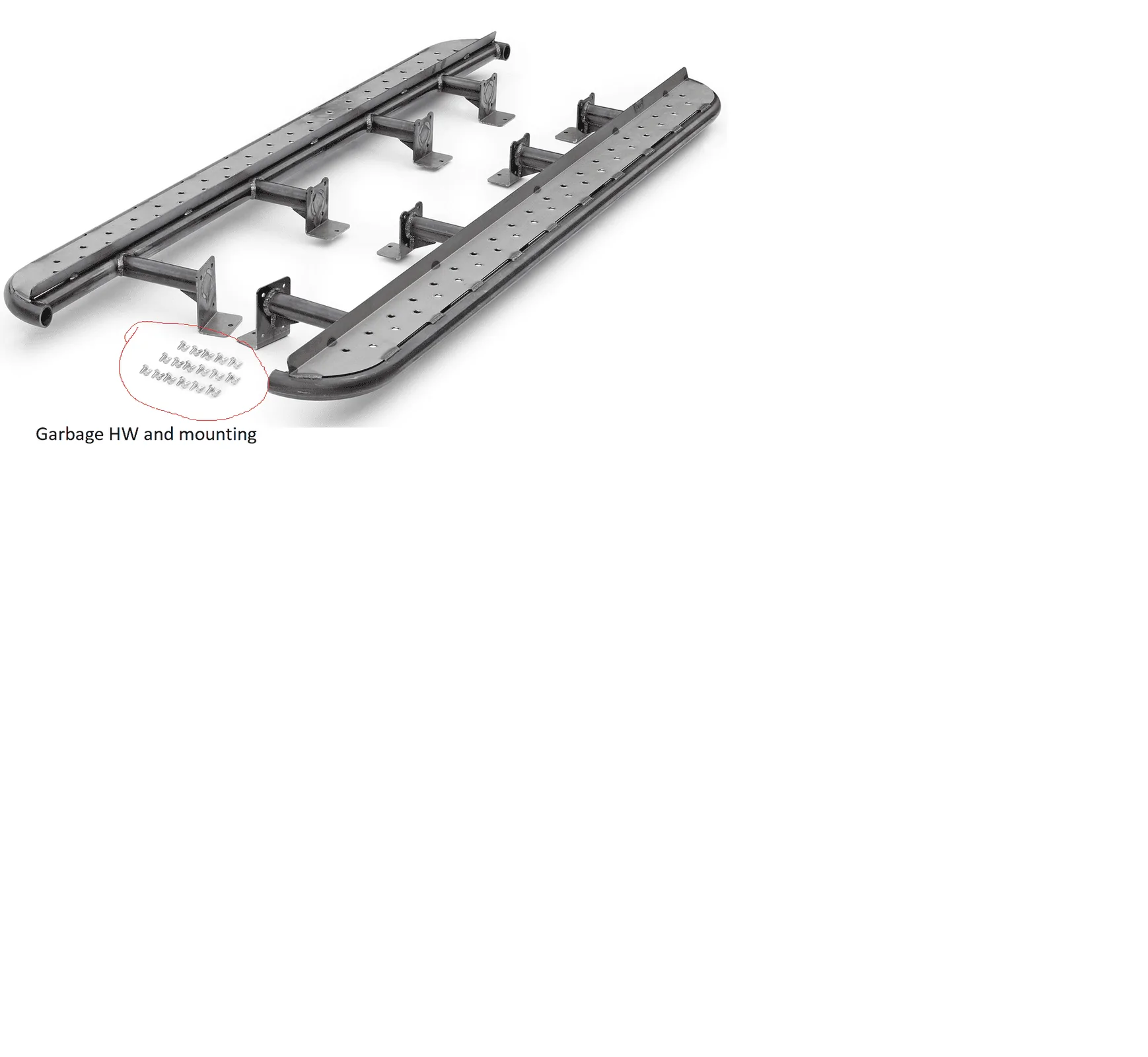

DankjeeP
Keith
Jan 13, 2021
841
910
USA
'21 JTR, '98 XJ, '17 FLHXS
HW Engineer
Any product with such a ridiculous attachment method.
Old thread, but I'm with you in rock country SoCal. Rocks can be brutal. The design of these rails looks awesome until you look at the mounting HW. Why would they do such a thing?? But others may not look for these things not knowing what can happen. If they went through the frame and added plates to the other side, they would probably be solid. Or some other method, but these little bolts are a joke.
