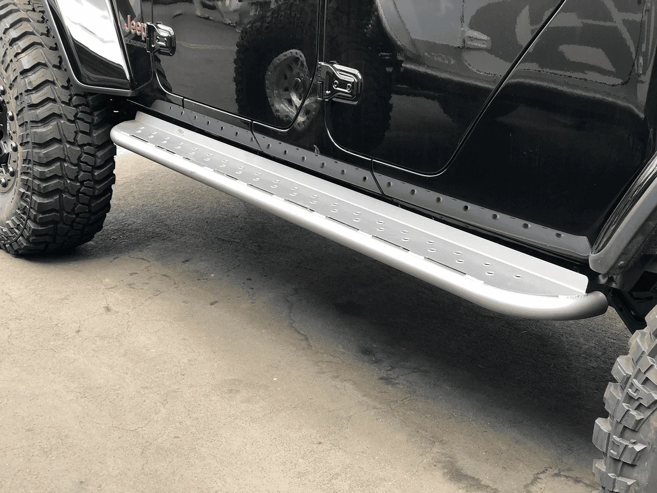

Thanks - great pics. I see you added some grip tape. Was planning on doing the same. Putting in my order right now though I am getting angled down.
Yeah, the finish is really nice on the RH rails but it’s not that textured and can be slippery if wet. Plus, this keeps the unnecessary scratches from dirt/rocks in the shoes from being ground into the finish. They are rock sliders, they are supposed to take abuse but I don’t want to cause it just getting in/out regularly. More importantly, I don’t want someone slipping and getting hurt.

Yep - and in any event keeping the finish intact helps reduce rust issues. But agree totally on eliminating slippage.

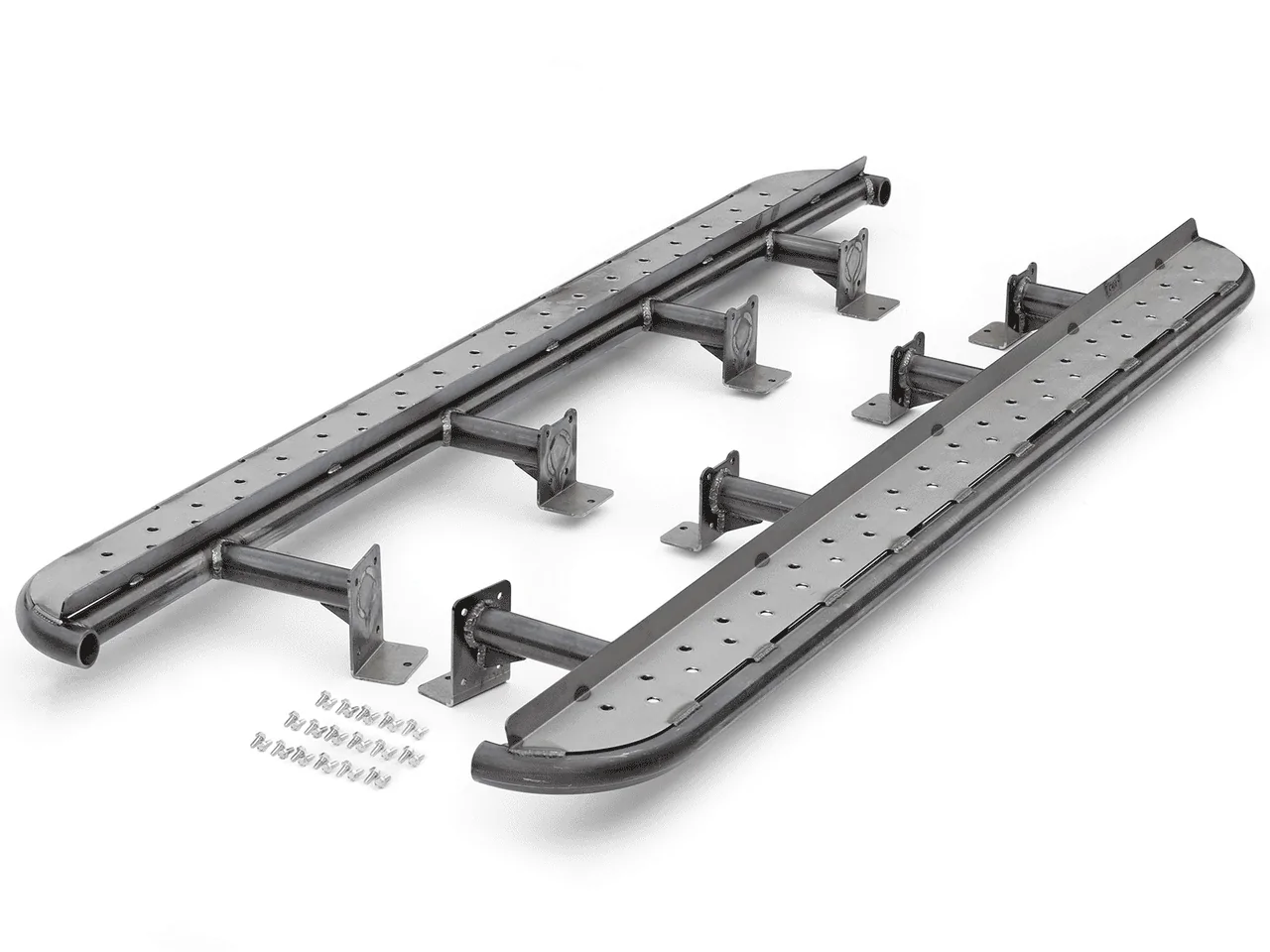

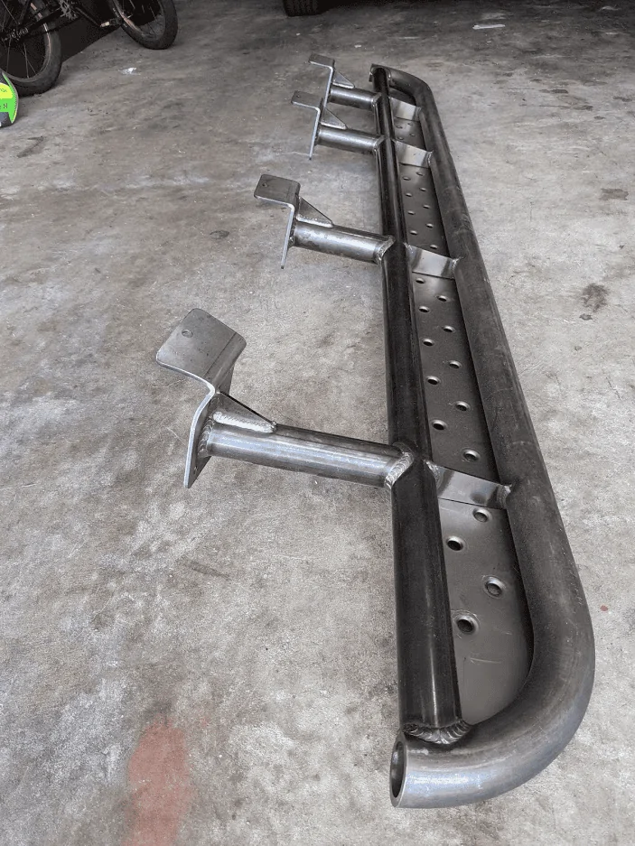

Ugh. FMWallet. I wasn't really convinced the Expedition One rockers were going to do what I wanted them to do. And the company wasn't answering any emails. So I sucked it up and ordered the GenRight.
The Expedition Ones looked like they bolted to the underside of the tub and not the frame at all and they wouldn't answer my questions. Last thing I want is 150lbs of sliders showing up that I end up not wanting and the headache of fighting them to return them.
So these are just the ones I want for what I need. I guess they can charge this much because they're the only ones doing it right.

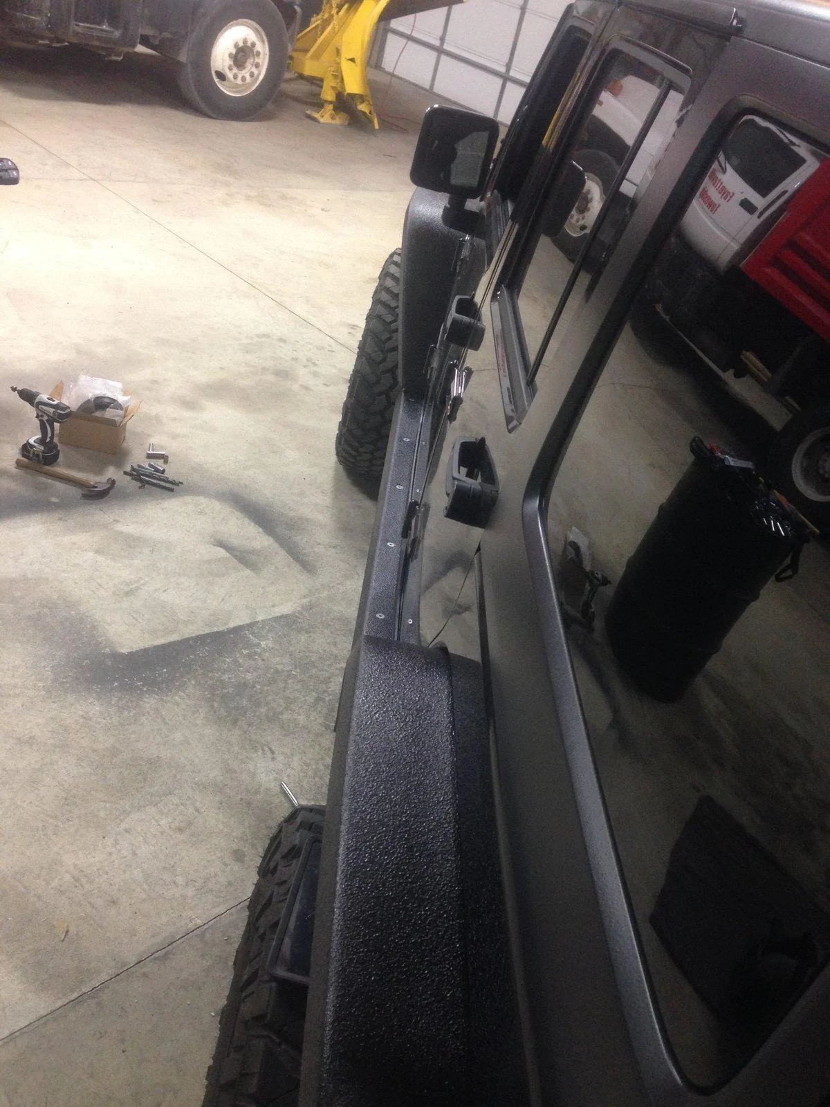

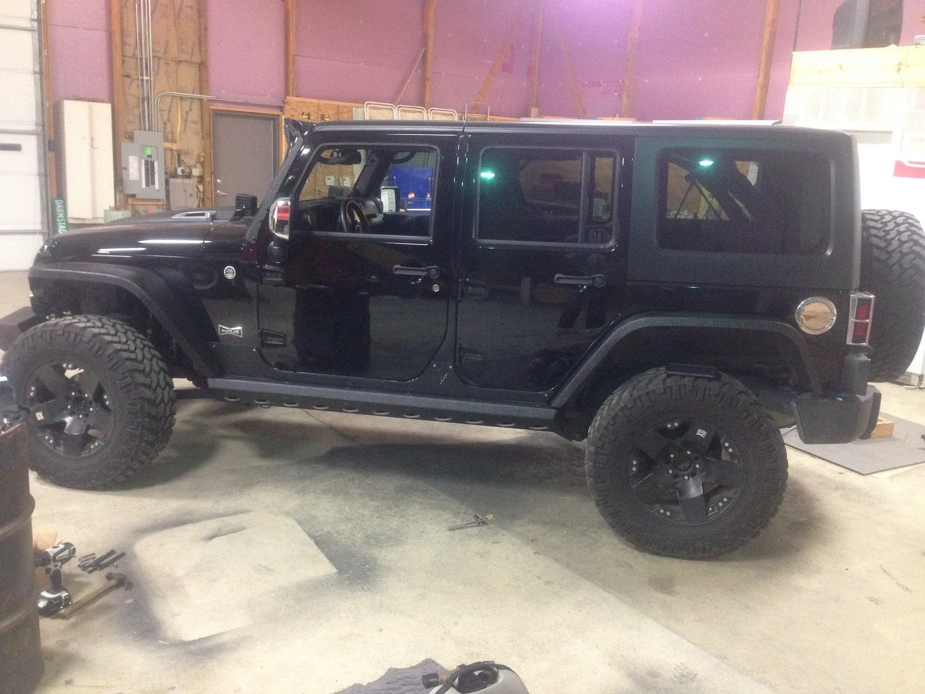

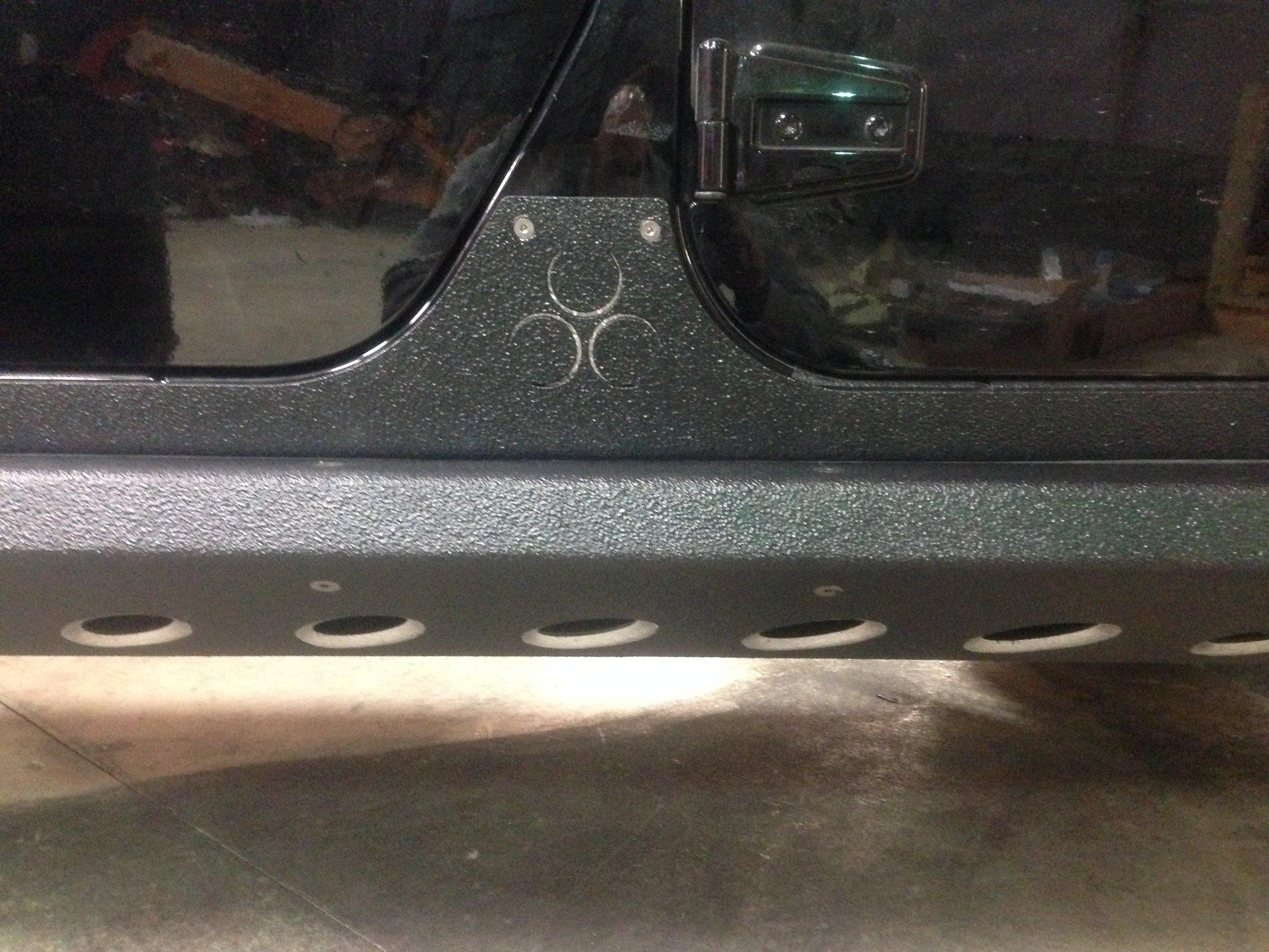

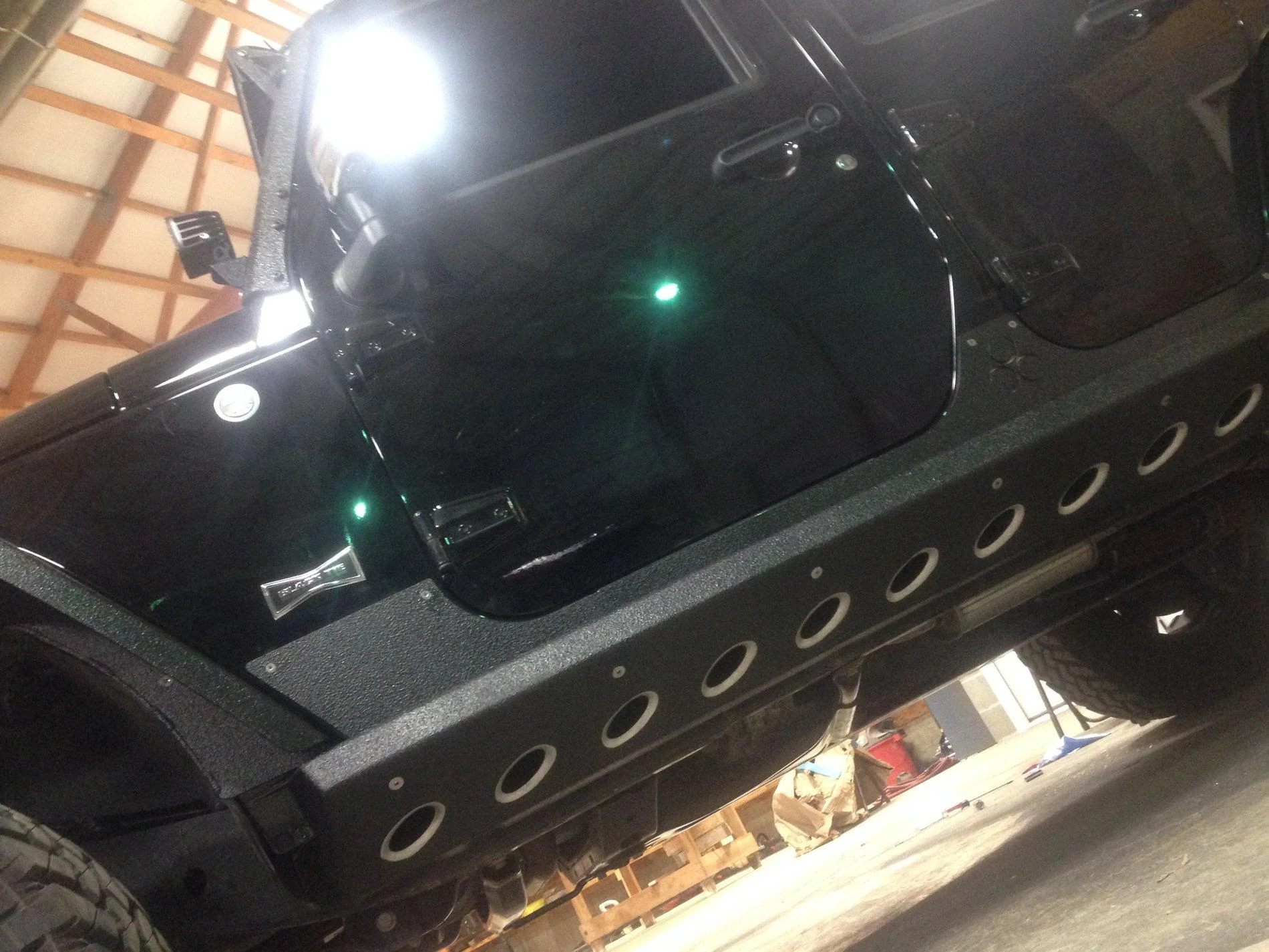

Nemesis makes awesome stuff! I had their Fenders bumpers and Billy rocker sliders with their tub armor on my 13 JKU and loved them
Looks nice too bad they don't have Skins for the JT Gladiator. I'm highly considering the EVO skins.

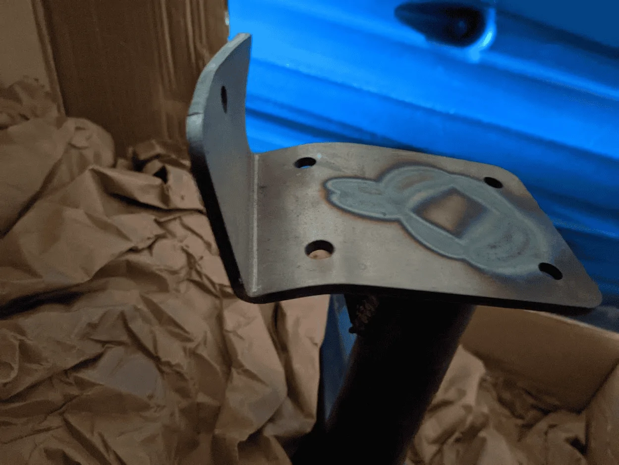

Crappers. FedEx managed to bend a GenRight rail in transit. They're going to pay to send back to them and get me a new one... or fix it... I because they're good like that.
While it sucks it does give me time to get started on the other side.

Damn, they drop it out of the plane at 30,000 feet or what?

I have no idea, the box had a hole in it same area. If it was just the lip by the mounting hole I could bend if back enough, but it's also the mounting area itself.
I imagine someone moving it didnt realize the weight, each box was like 115lbs or something. Like it was dropped on an angle on a curb or off the plane when loading.
GenRight will get it sorted though.

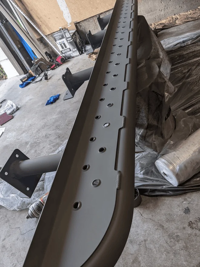

The rail that FedEx damaged is on it's way back to GenRight. I went ahead and prepped and put 3 coats of primer on the other rail today.
Thoughts.
I learned a lot from my bumper that these came out great. Good full mask needed. Spray can handle super helpful, probably the key. Going for the tough spots and crevices first and fill in the easy stuff when it's all done.
Also, these are absolute beasts. Rather than 3/8" it's all 1/4" tubes. Rather than the 4 body bolts or some pinch seams or combination of, it's the 4 body bolts plus 4 added drilled and tapped into the frame. So 20 frame bolts in the end not just 4.
I will get this setup and the extra bolts drilled and tapped next week while in primer. They like others suggest doing that in raw but I won't be able to have the side step off too long to drop the existing step, align the bolts, drill and tap, and then prep, prime, and paint. It will be fine.
