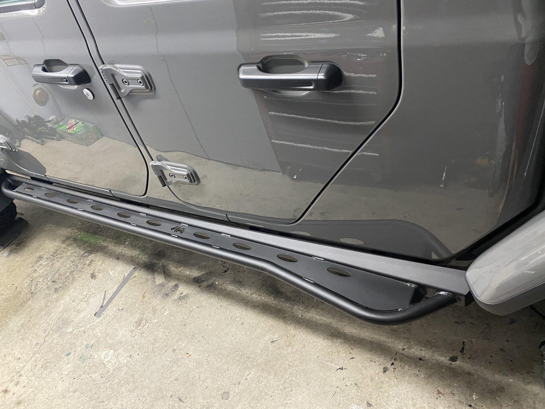

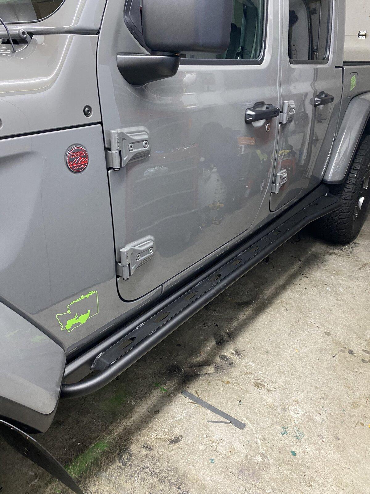

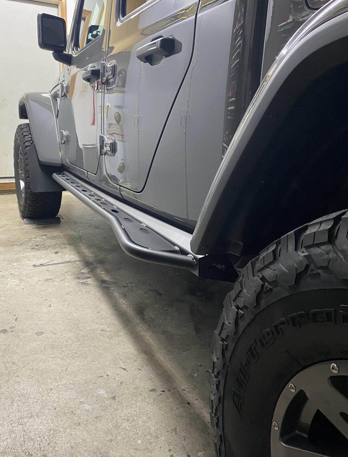

Just wanted to post up my experience:
I took a shot and ordered a set of ATP Rock Rails even though there is not a lot of info online about them. They look really good and seem pretty heavy duty too. They mount directly to the RubiRail mounting location, so they may not be suited for the EXTREME OFFROAD Group, but I think they will give me the protection and step that i was looking for.
I did have a small quality issue with my rails, so I emailed them. The owner called me back today, cool guy, he is totally willing to help me get my issue resolved, and is very customer focused! Good Company, good service, nice product.
Adding pics as requested ;)

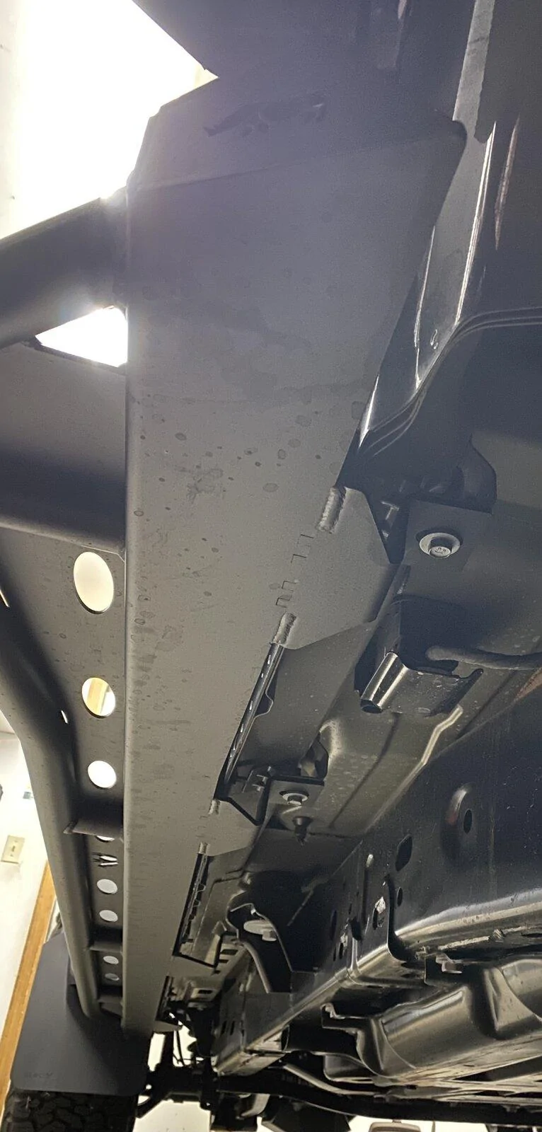

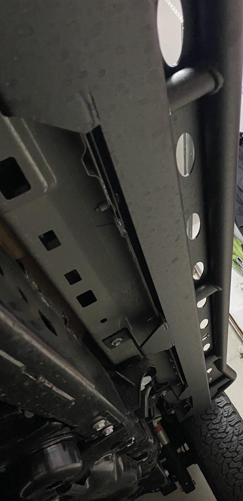

Thanks @OrangeCJ ! Do you have any from the bottom? trying to see if I will destroy these easily. Thanks again!

Jeep Gladiator Rock Rails Thread Bottom2
Jeep Gladiator Rock Rails Thread Bottom1
And Yes it is clean under there, and yes I have used my 4WD and My Lockers! It is not muddy in Moab in the middle of Summer ;)

Need to post an update in regards to my ATP rails. The rails had two issues, first the studs that mount them to the body, they are the same diameter and thread pattern as the Rubi-Rails... they are pressed into the plate on the rails, not welded. During the initial install one stripped out and another one snapped off. I have since pulled the rails off to address the second issue, and when I pulled them I had to mess around with those studs again, so I decided to pull them all out, drill and tap the holes and replace the studs with 3/8 bolts.
The second issue is rust. I think if you look at the pics on Quadratec you will see some rust around the edges. This is because the powder coater does not know how to apply to the tight corners, and they are not getting adequate coverage. I know a powder coat expert and he explained the issue to me... I relayed this information to APT via email, and they have never responded. In fact they have never responded since my initial contact with them... I guess you get what you pay for after all.
I have not complained too much since I like the way they look... But wanted to post that I had to repaint them, and put better quality bolts in. At some point I may convert them to Frame Mount and add some boatside protection as well...
