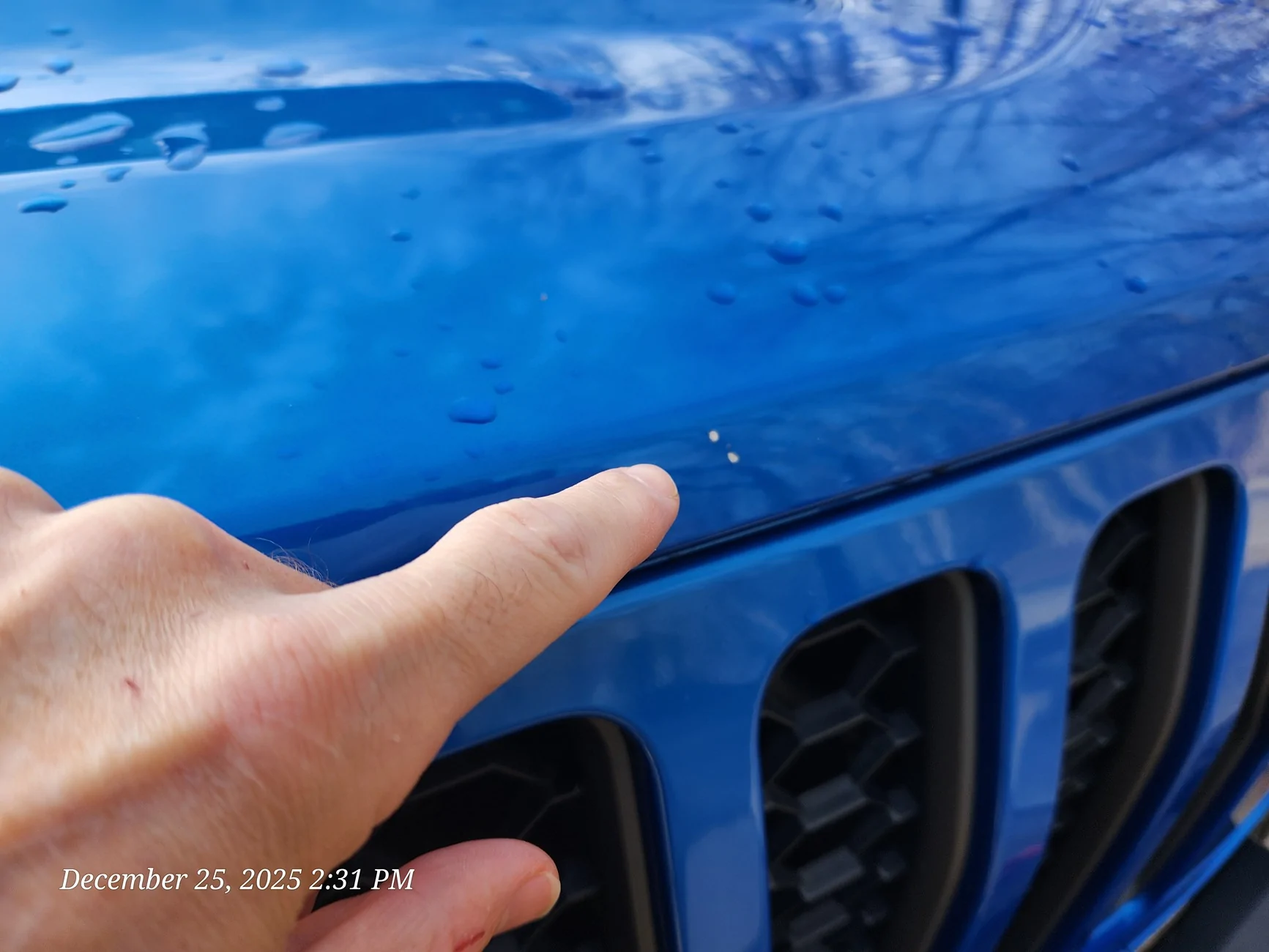

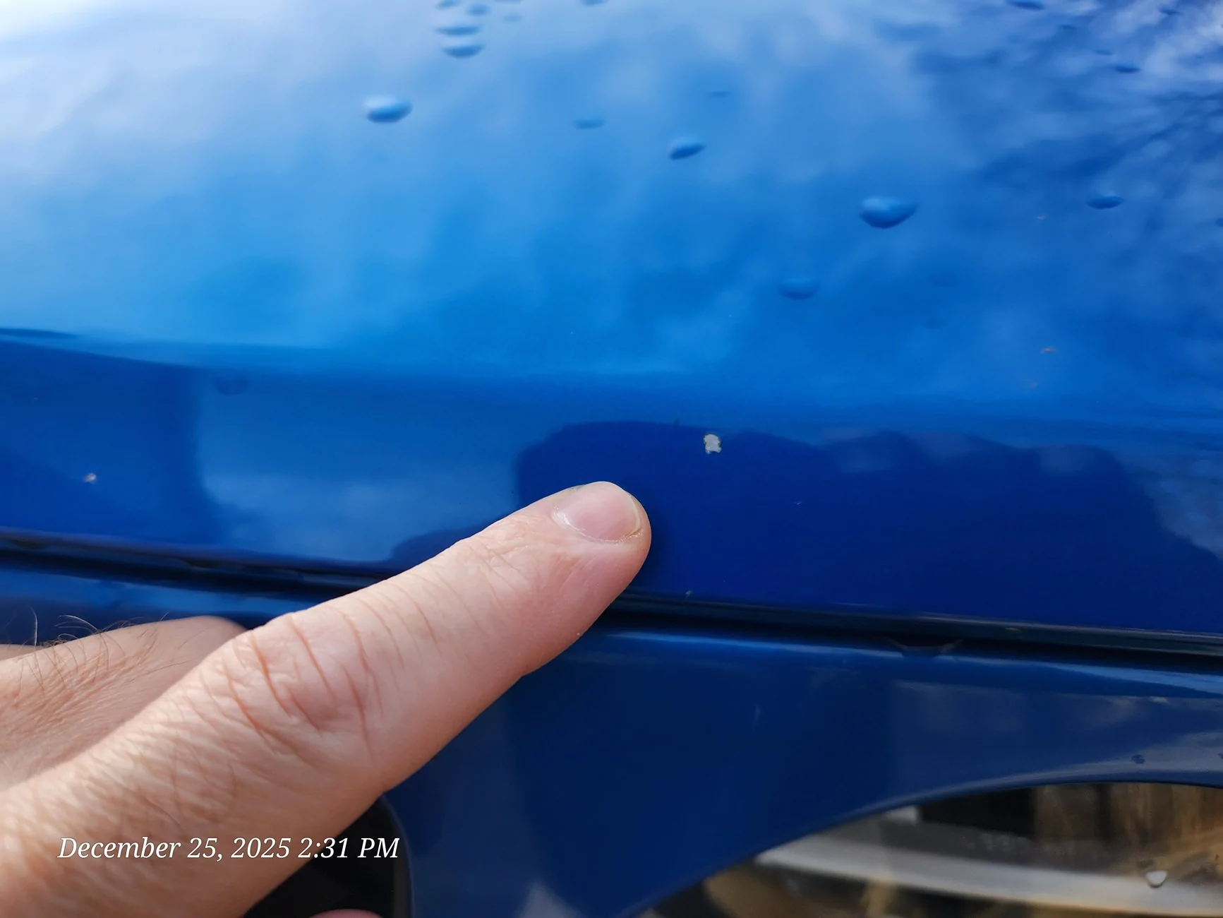

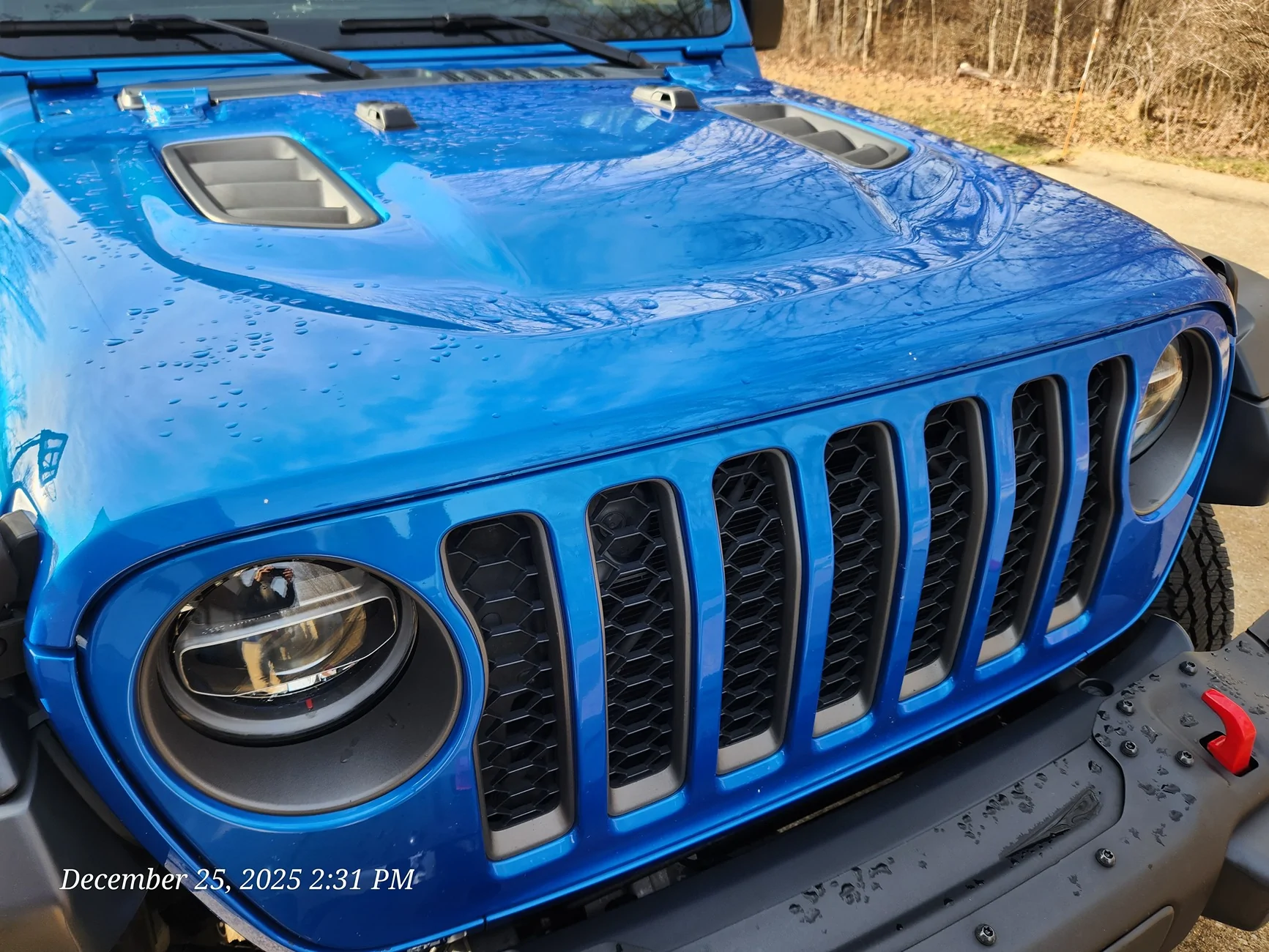

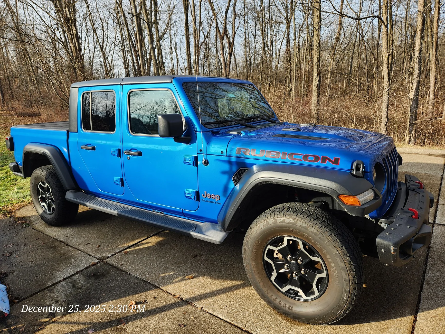

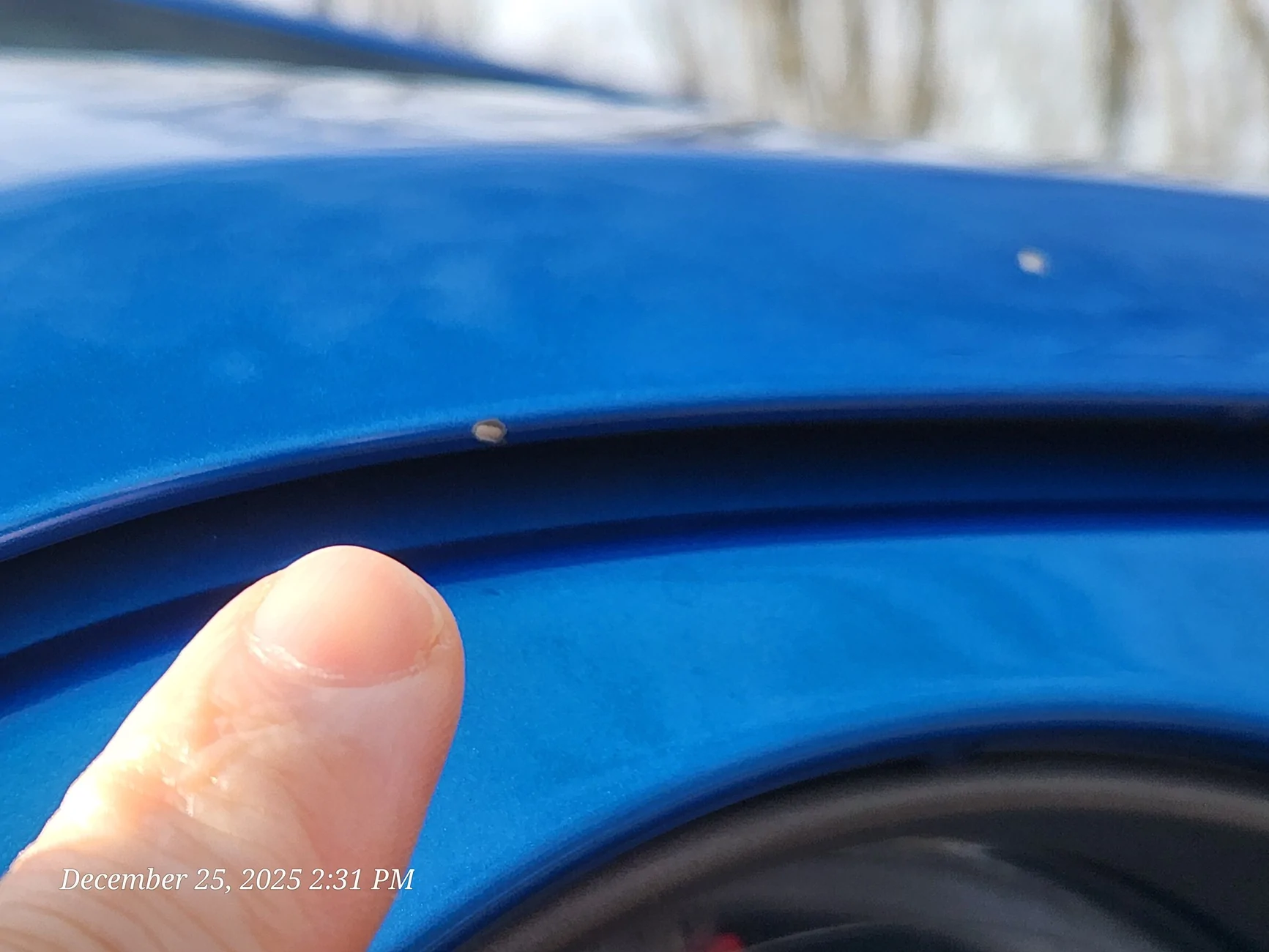

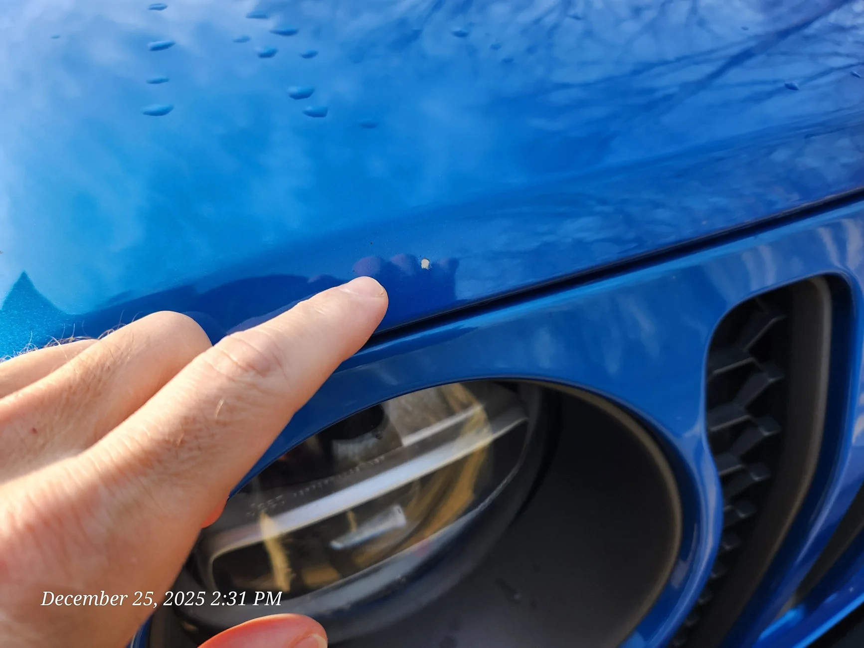

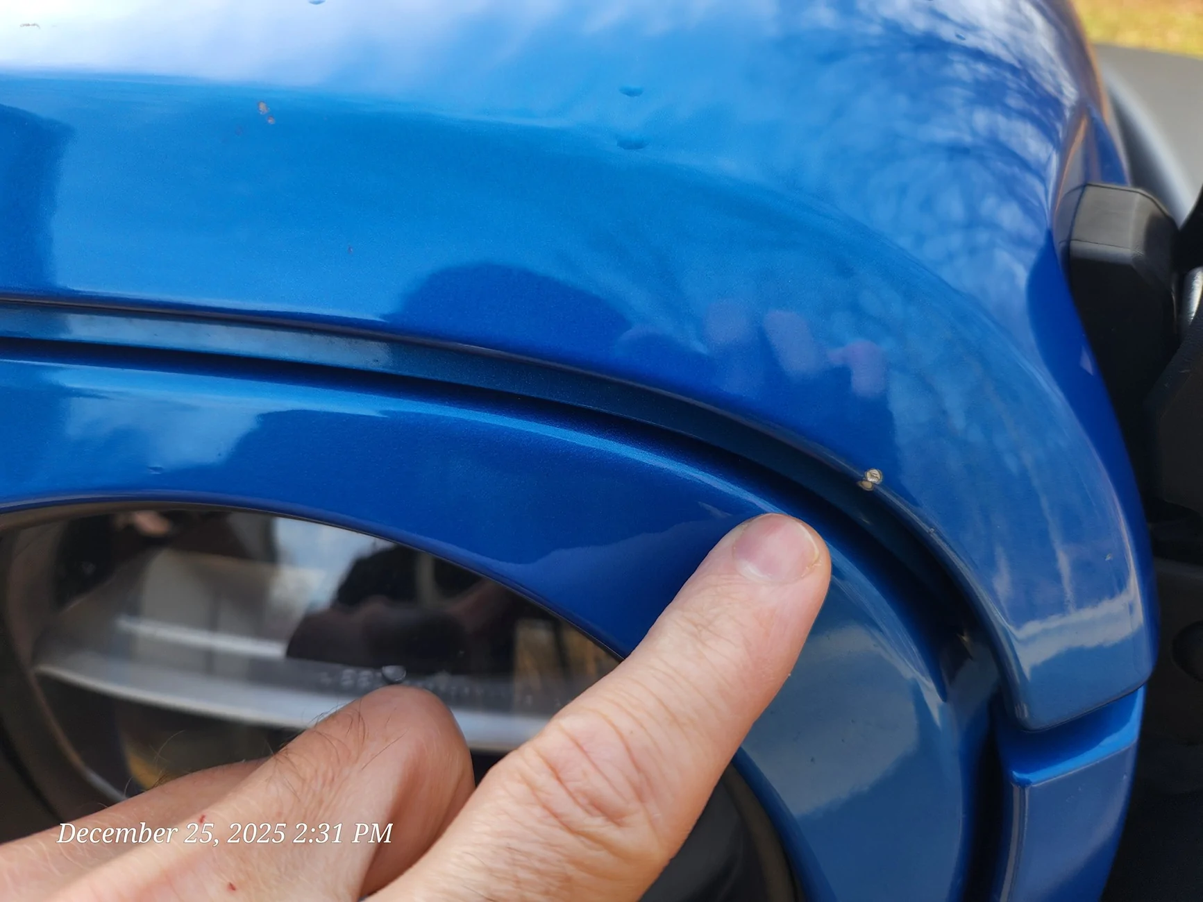

Was on the PA turnpike n had to pass a salt truck that was a cascading waterfall dropping a ton of salt n debris (had to be some rock/stone material in there as well) and it chipped up the edge of the hood pretty good in 9 places. Bought a hood guard after the fact. Is there anything I should do about, or to, the 9 chip spots before putting the bug/rock guard on 1st or just install it ?
I'll mention this cuz you weren't there but this was a 2 lane section n I tried to get as far away as possible n still got completely pelted, sounded like I was driving in a hail storm, don't know how the damage wasn't worse or how the windshield didn't get chipped/ cracked. Also, passing was NOT dangerous cuz the pavement was damp, actually dry in some spots, not wet n shiny, nor was it snowing but maybe snow or sleet was in the forecast.

Yep. Make sure it’s good and cleaned out then use touch up paint from the auto parts store.
Good and cleaned is an understatement. I personally wouldn’t want ground in salt under a coat of paint on my hood. As long as the impact point is fairly smooth before you paint it it should be good.

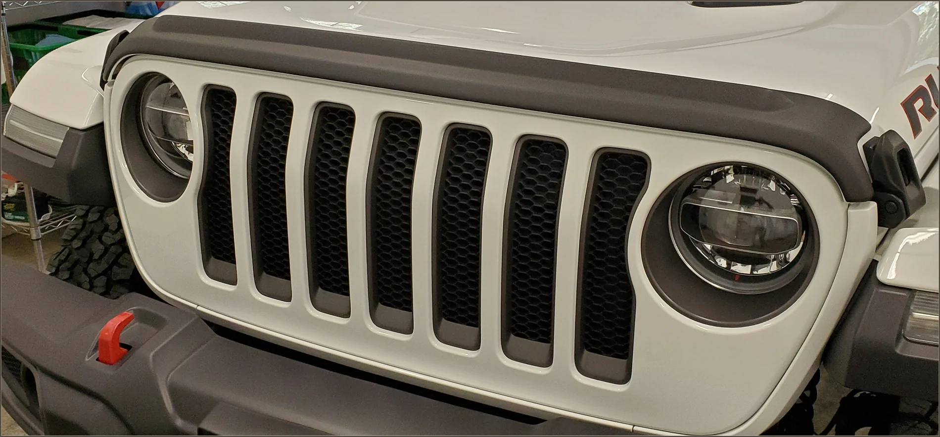

I installed my Bushwacker front hood guard in 2019.... I have driven over 100,000 miles with it. It's lived in Florida with the hot Sun for many years. Also, it's withstood plenty of Upstate NY Winters..
Anyway, to this day the Bushwacker looks as good as new. No fading and the thing is still fastened very securely with no sign that the Genuine 3M automotive adhesive / double sided tape (Came with the hood protector) securing it, is going to fail...
AND..... No hood damage thanks to the Bushwacker..

I am a fan of a partial front end PPF application. All the chips I have had on any car are on the front of the hood or fender. If possible, I have it applied right after I buy a vehicle. If not possible, I fix the chips the best that I can and then have it applied.
I have tried a lot of touchup paints. Depends on how much patience I have at the time, and the color in question. I like the consistency of DR COLOR a lot. If I have a simple color this is my go-to. Great on Sarge Green. I do not use the DR Color system, however, as I usually end up taking off the paint that I just applied.
If I have a deep chip I have had amazing results with the Lanka system where you let the paint set a bit and then wipe off the surface to get rid of the "blob." But this takes practice and a lot of trial and error.
If you have a really tricky color, like my old Audi which had Glacier White Pearl Tricoat, I go to PaintScratch.com. For this one I needed to blend base coat, top coat, and clearcoat. Took me all afternoon for one chip. (Then I applied PPF . . .)

Sorry, welcome to life in Pennsylvania. I put the Mopar deflector (no tape factory holes are used) on with in the week of buying mine. Without one all our vehicles get chipped up like that. I agree with others clean it up, and apply touch-up paint. I bought the Mopar version of touch-up paint. Once touched up put your deflector on, it really does help with the rock chips, not so much bugs though.
