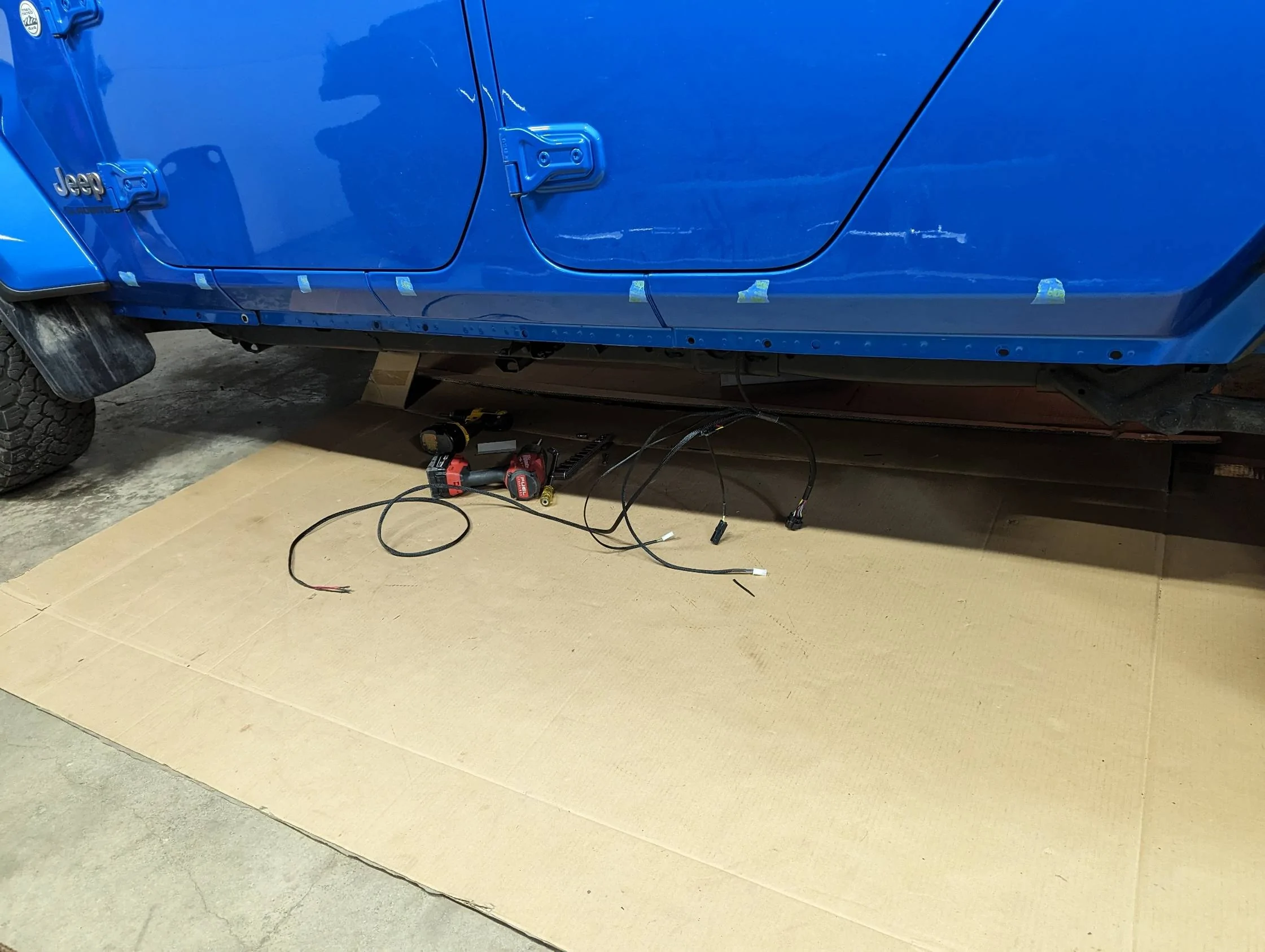

Another vote for and glowing review of the RSE step sliders. I skimped out a little on the build of my first Gladiator and didn't get the RSE steps, which made entry/egress a bit too much of a challenge for my personal tastes on a daily basis... This time however, the RSE steps were among the very first mods installed, and it's a total game changer. As far as install goes, the wiring was tedious for me personally because I'm a gear/lever type guy and I despise wiring, even perfectly pre-loomed stuff that practically falls into place like what RSE provides. The only other concern for me was the weatherstrip installation, as having that misaligned would have driven me crazy every time I approached the rig. Thankfully I got it close enough :like:
Ha! You cheated and used a lift!
The wiring on the JT was much easier than the JLU 4xe.
However, the wires from the main loom that go to the door switches is so short that if you need to disconnect those switches, it means pulling the trim back off to get to those connections. I wasn't able to follow their "leave disconnected until...." or troubleshooting bit because there was no way to reach in and disconnect anything once the wiring was in place behind the trim. Even pulling the B pillar trim loose, you can't get to the connectors on mine (either the JT or the JLU) you must remove the trim or at least have it almost removed.
I agree on that seal strip - I'd have been really unhappy had that not lined up perfectly - and I mean perfectly.
So there was a lot of measuring, taping, readjusting, measuring again, and so on.

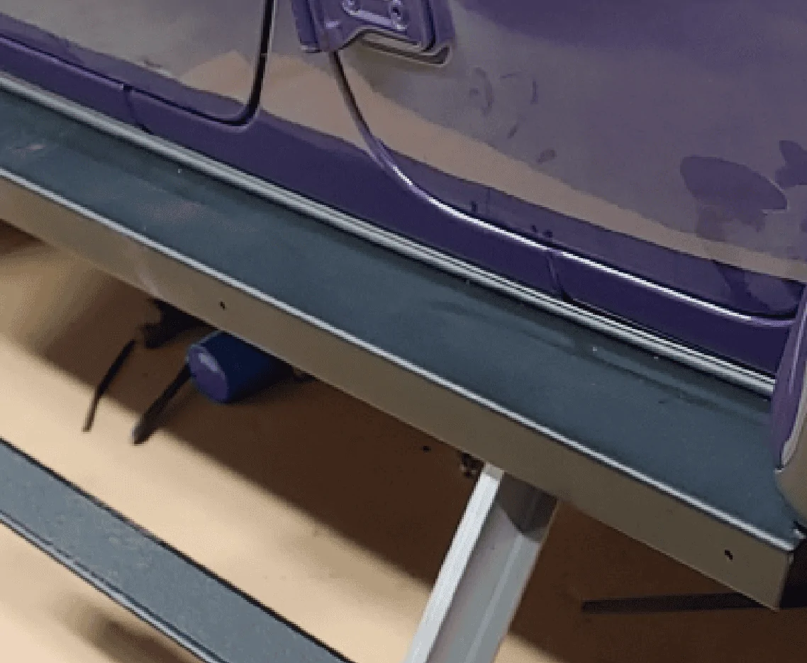

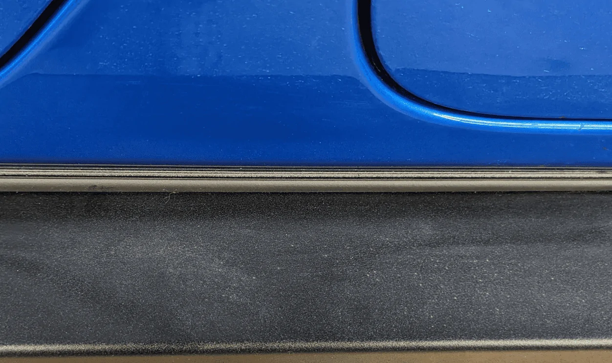

What I did with the weatherstrip was install it from the top after the sliders were installed. It was a bit harder this way but they are lined up perfectly. Peeled back the tape covering enough to get a good grip on it, positioned the weatherstrip and peeled back the tape and pushed it in place. It helps to have another set of hands if you do it this way but you only put the steps on once.

Only put the steps on once for each of our Jeeps. Measure and it's easy enough.
So I don't have a clue what you are talking about "you only put the steps on once". That's the way it's always done - put on strip, put on step - ONE time. Never any on, off, on again. Never.
The only thing I ran into was that the left side of my JT the rocker panel isn't as even as on the right side so that seal piece almost wasn't thick enough. Got around that by loosening the bolts, putting a jack under the step (step retracted of course) and lifted a bit then tightened the bolts again. Tolerances. Not putting the strip on until later would not have mattered a lick because it was lined up perfectly, just that the step sat out a bit due to the natural tolerances of anything man-made.
The seal strips went on fine. As snug as things fit there'd have been no way to put them in after the steps went up because the step top pushes in on the rubber so it would have stuck to the rocker panel as it went in before it was down far enough.
