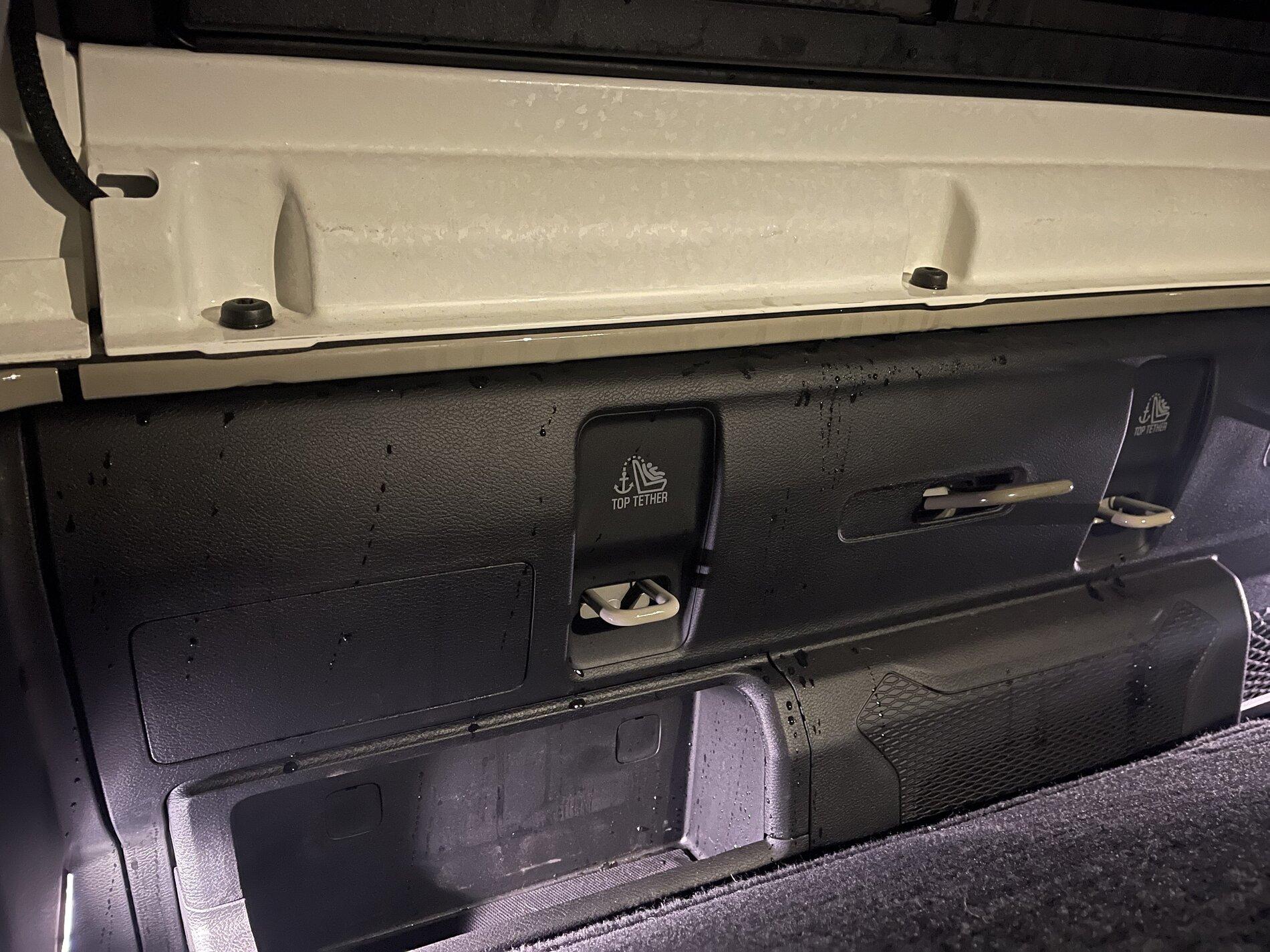

I forgot to mention. The glass company also broke several of the plastic attachment points of the interior panels that go above the rear window. They took the part numbers and ordered new ones from the dealership that hired them to do the work. I watched the technician try to remove the panels, there was no way those panels were coming off without those plastic pieces breaking.

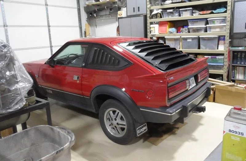

What I'm finding interesting, or rather amazing about these windows is the fact they are even leaking at all for some owners (and they obviously are leaking) but that it's such a big job and even when done, I seem to recall someone saying it still leaked or leaked again?
In the picture below, when I repainted this car, the huge, heavy glass was removed from the hatch. The kicker - it's a one of a kind glass, rare combination of options, you cannot buy these, and the seals are not made by anyone anywhere. You mess up a seal and that's that, you're done.
The window was put back in after the repaint. Not a single scratch or mark anywhere inside or out (I'd have been really pissed as it was a big ordeal to prep and paint this thing) but since it was put back in back in 2013, to this day, it still doesn't leak.
Seriously, a 1982 car, no leaks, window taken out, window put back in, same seal had to be treated with kid gloves and used over - and some of you are having trouble getting a shop to replace these where parts CAN be bought and they aren't that old?
Unreal.
This should be piece of cake for true glass people. Or has Jeep done something totally weird with this top and glass and SEAL (that sometimes doesn't)????
Imagine what this weighs - and you have to lean over a freshly painted car to reinstall it and take care to not even nick the seal or glass itself (shatter time)
40 years ago AMC sealed these - and they didn't leak. To this day many don't leak - but Jeep has maybe not a whole lot, but enough, of these leak when only months old.

Found out tonight that mine is leaking, fortunately I removed the carpet for Armorlite, although the back of the seats are wet. I will be scheduling an appointment soon. Am I on the hook for getting the window re tinted, or might the dealer cover that?
I would expect that if YOU added tint that would be on you. Warranty covers factory defects. The dealer covers nothing....the Jeep corp is who warrants stuff. Dealers only cover their labor on things.
