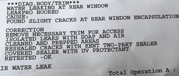

And here is the repair summary:
Jeep Gladiator Roof leak in back 1635865856210
covered by warranty.
No removal of glass. Is that normal?
I would not call that normal when 99% of everybody else got the whole window replaced for the issue.
IMHO, that is a band-aid fix and not a long term one. I would be talking to the dealership on a true replacement and if necessary, go over their head.
Did they only sealed it from the inside using a seam sealer? Doesn't that allow water to still penetrate inward until it reaches their new seal? If so, how does that affect the outside that is still allowing potential water penetration inward?
I could be wrong, but I believe seam sealer applied inside a vehicle is typically to seal against fumes entering. Seam sealer applied to the exterior is to seal from water/moisture.
MattHamilton
Apr 9, 2021
133
167
Hamilton, ON
2021 Jeep Gladiator Overland
Support Analyst
I don't see any evidence of new "product" on either the outside or the inside of the rear window - but honestly I don't know what I'm looking for exactly. I agree, though, the seal should be applied from the outside not the inside. I'll call the dealership back and see if I can get them to describe the repair in more detail.

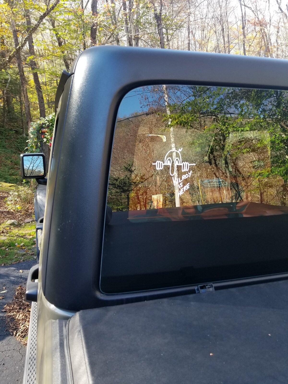

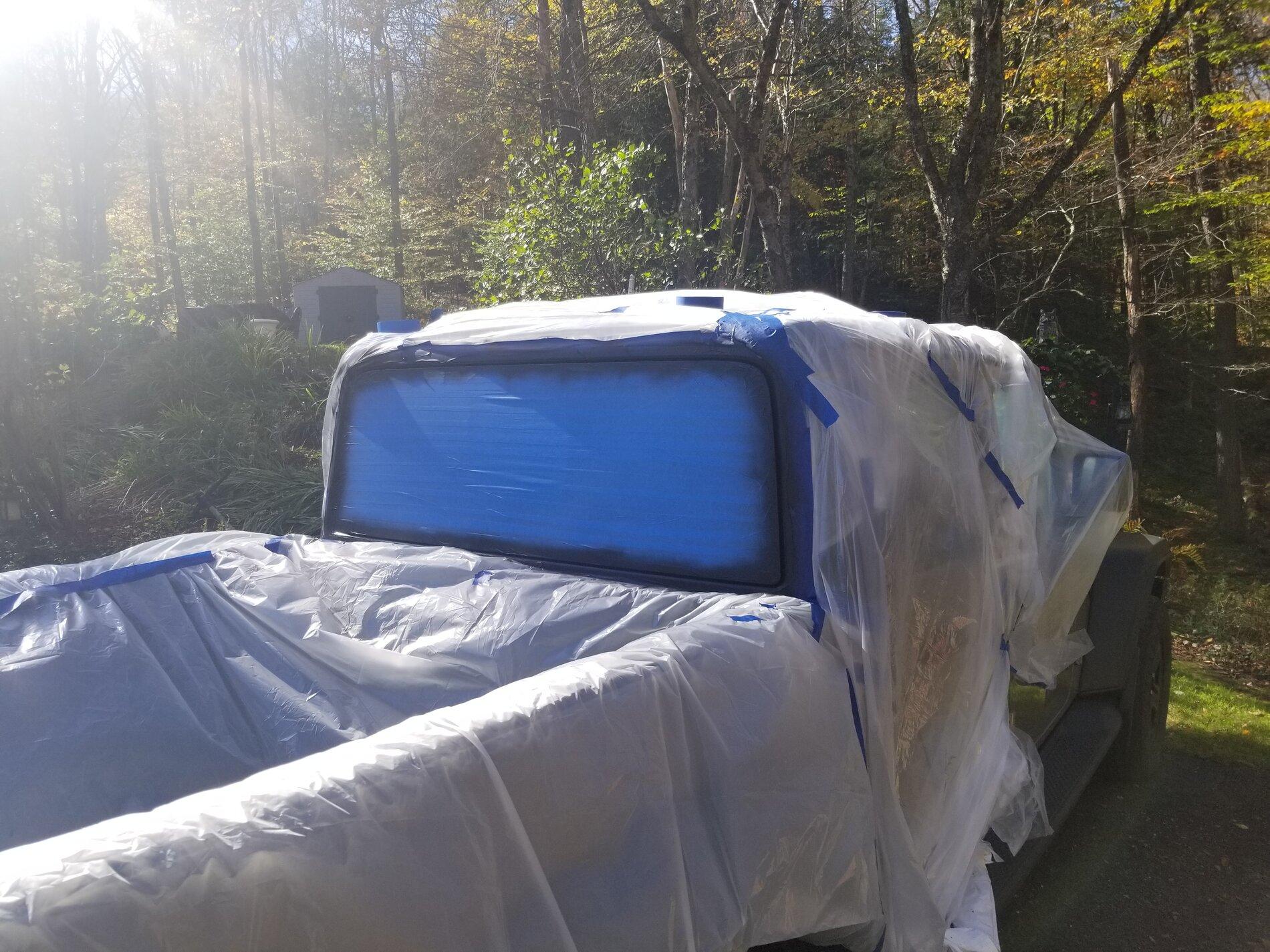

I'd love to hear what they did. I have the leak but I'm 12,000 miles out of warranty. I've messed around with silicone and some weather stripping from the outside but the way the rear window is designed makes it very difficult to do from the outside. I haven't tried to remove the interior trim at all to go at it from the inside.
Worst case for $2,000 I'll just buy a premium soft top...
Mine was under warranty, new window put in but I've seen plenty of people fix it themselves. I had to repair the paint around the window myself after the glass company touched up the hard top with gloss black paint with pet hair stuck in it. I didn't want them anywhere near it again. Luckily it came out great after
