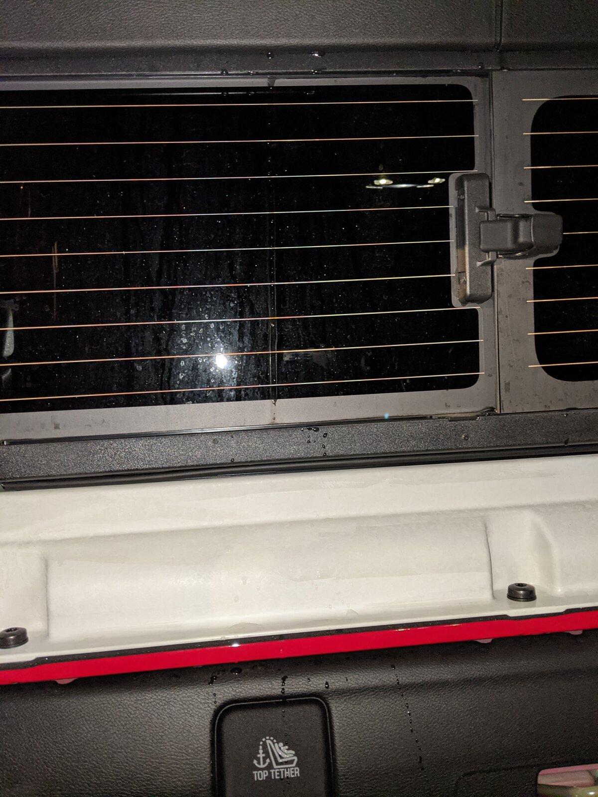

I'm in this leaky rear roof/window club, also. I actually noticed it about a year ago. Bought my truck in Aug '19. Noticed the leak around August '20. Not as extreme a leak as some people have had, so waited until the truck was already going in for other reasons. Asked dealer to look at it in Fall '20. Dealer's response was "we are not seeing sign of a leak, get a picture and show us" "we are not aware of any problem of this sort on Gladiators".
Life has been overfull for months with nuttiness at work and a family health situation, so am just getting back to this now (partly because I want to install some audio equipment in the back and I don't want _any_ water back there).

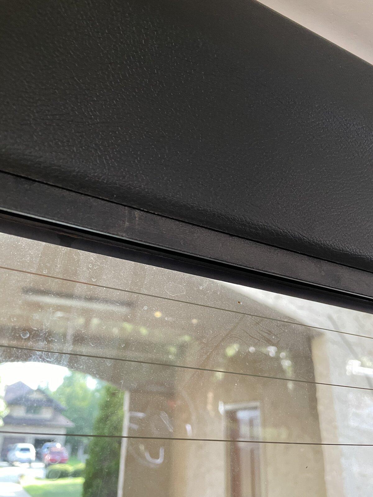

Got the photo recently after a day of steady rain.
I am going to reach out to Jeep Cares in hopes that Jeep Cares can help advocate so that I can get in to the dealer in a way that the right course of action will be in motion from the point at which I take it to the dealer for this.
I can tolerate, if needed, some delay to get the part, or some delay to schedule the work once the part is in. What I am in no mood to tolerate is deflecting that it is a real problem, or needing to go into the shop multiple times before the solution even commences in motion, nor a bunch of shoddy half-fixes.

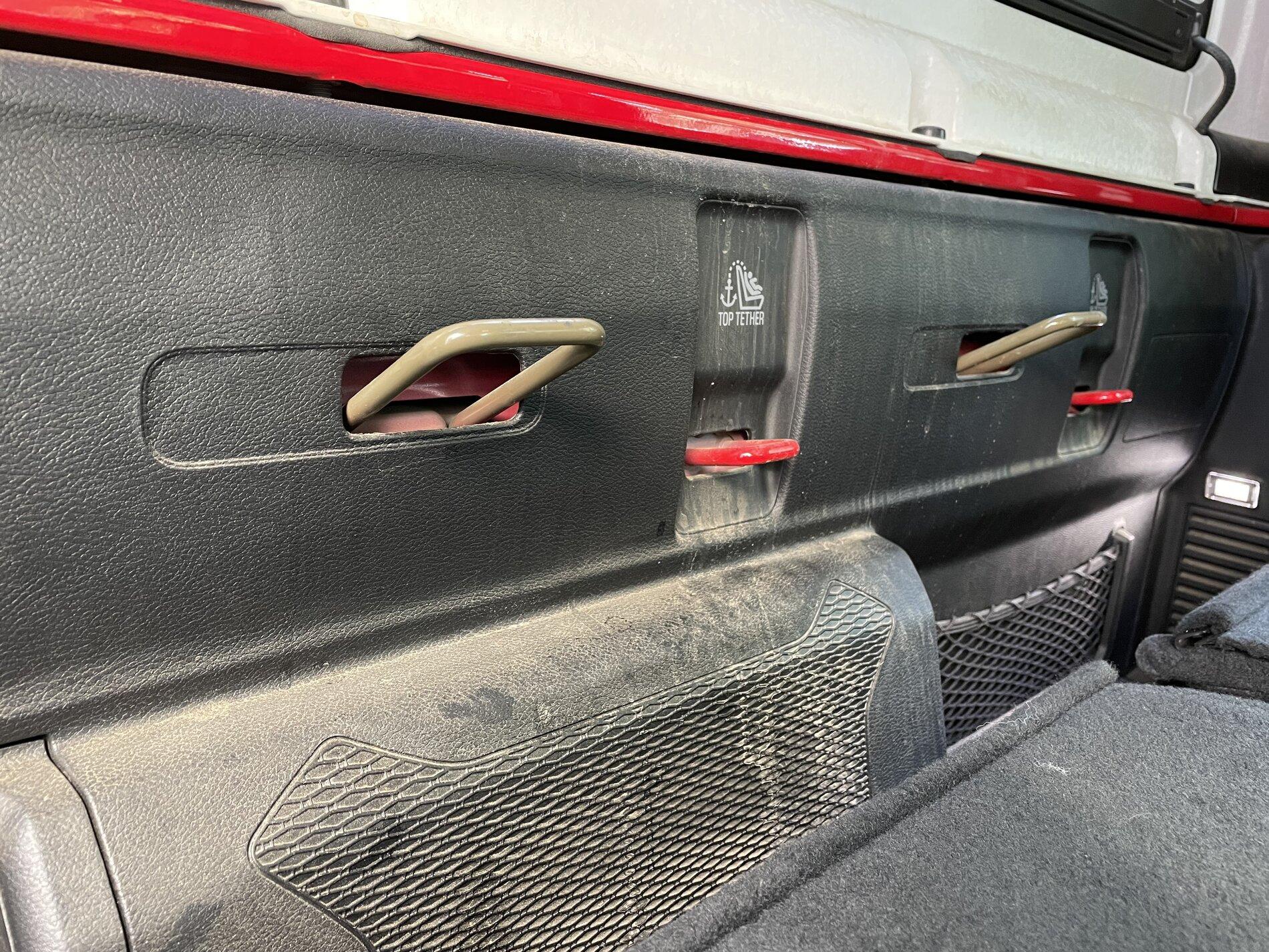

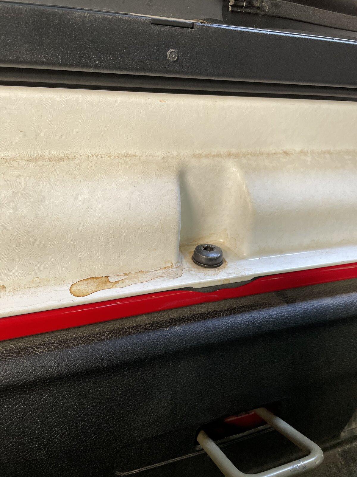

So, we recently got a Subaru Outback Wilderness edition for my wife and have been driving that a lot (two weeks). I just got back in my truck today to drive it some and noticed a horrible rancid smell. Low and behold, we have been getting a lot of rain recently and bingo, I noticed my window had been leaking. Crap. This will be fun with dealer. We go off roading frequently and I hadn’t cleaned the dust off from my previous excursion and I could see clearly where the what had been coming in and settling.
Jeep Gladiator Roof leak in back 179CC035-4FFD-4E47-9FDA-527530090A51
Jeep Gladiator Roof leak in back DDE677BF-0E62-4838-8951-9B34433C7B24
Jeep Gladiator Roof leak in back 8E6993E2-4F4B-4BC8-9B5A-150F1EC6C402
Jeep Gladiator Roof leak in back 1CC7C929-32B0-4155-BAC7-5D682D4785A7
Jeep Gladiator Roof leak in back C98F2A7E-5FA9-4193-9AAC-4CCEFAB9C082

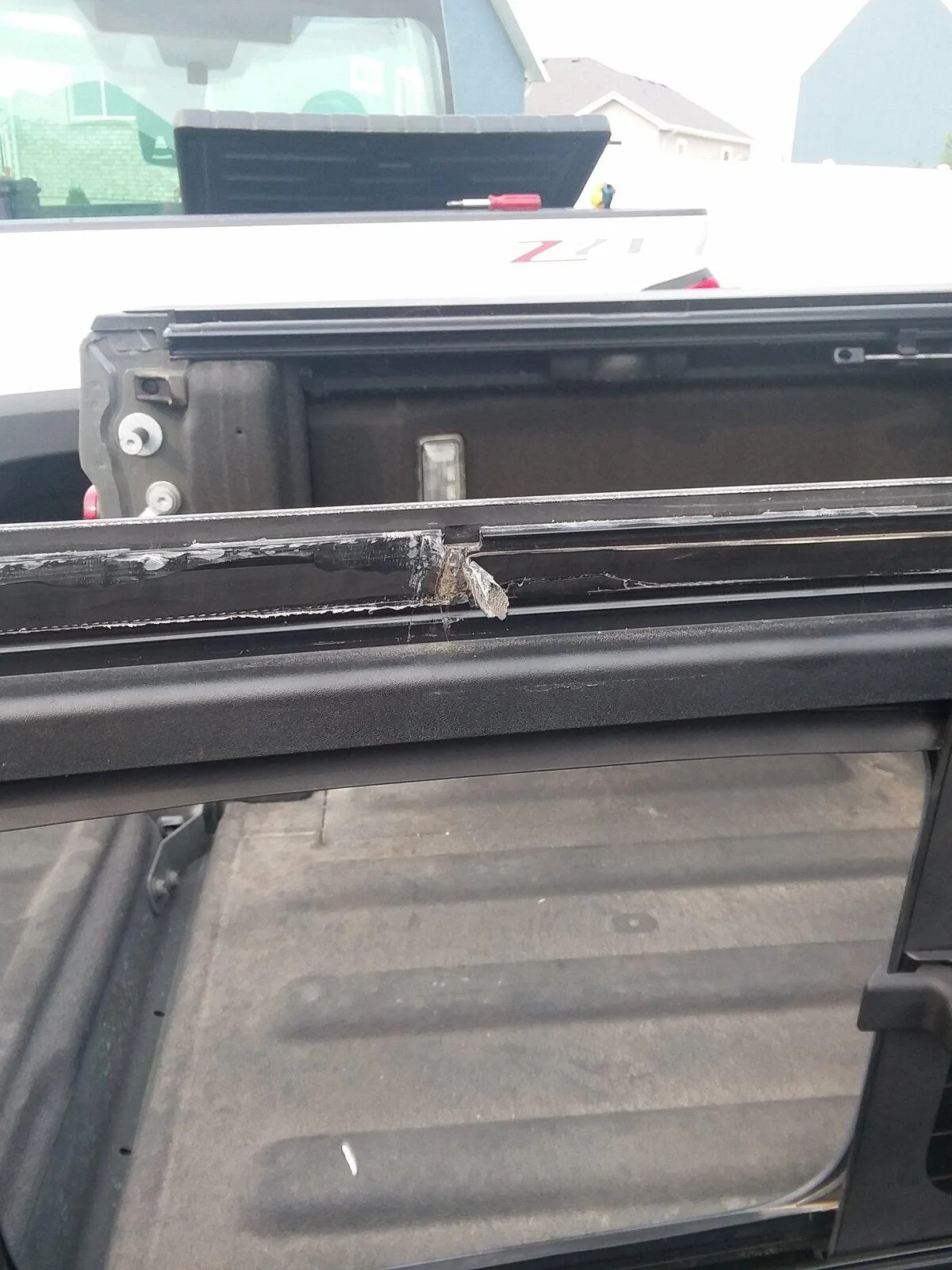

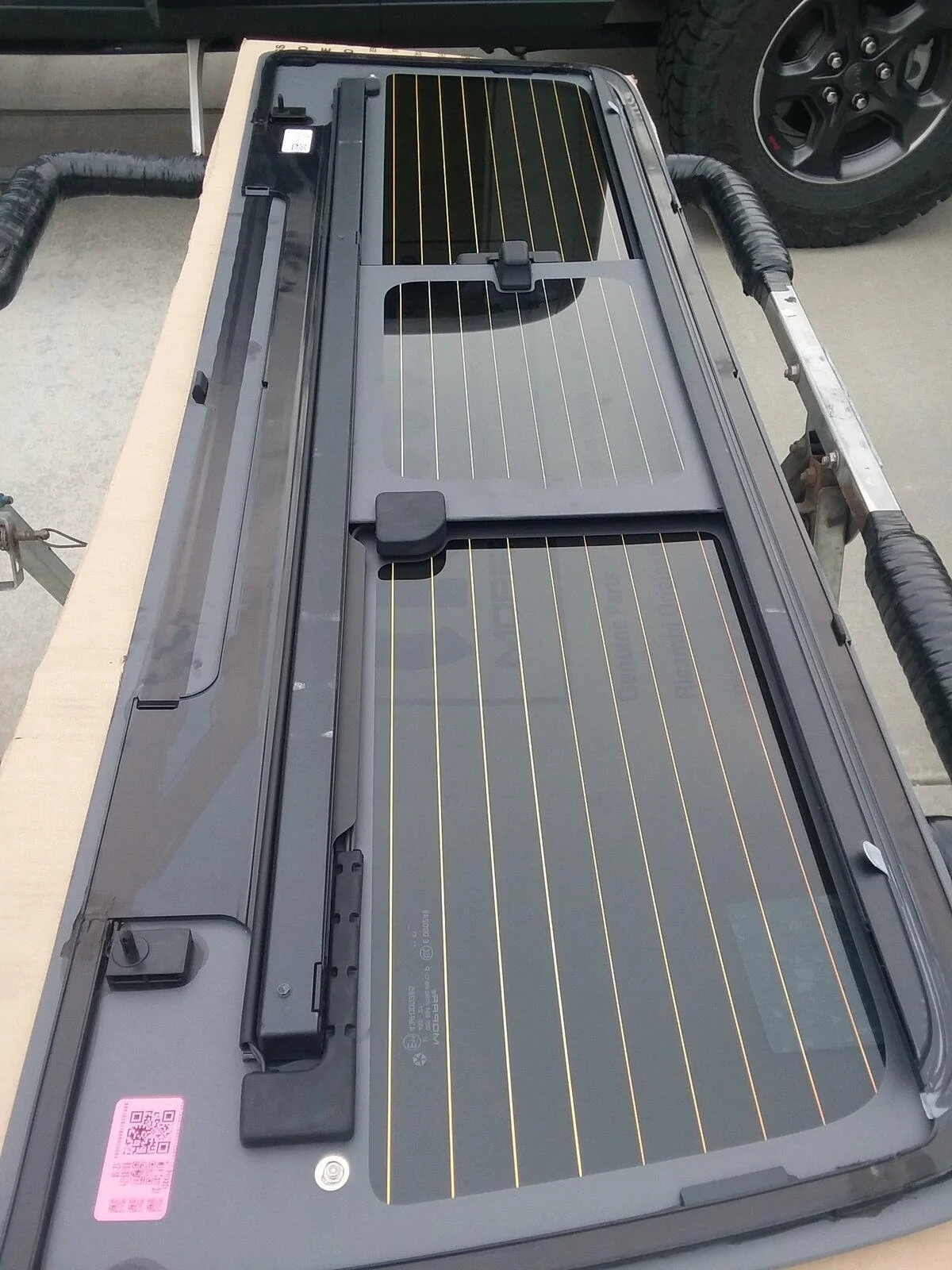

Went to dealer, but the new glass had a chip in it. When they went to order another piece of glass, we found out that there is a new part number - an improved window. They expect it on 9 Jul. I'll see if I can get the part number to add to this thread once it comes in and I get to see it.
Update - glass ordered in June received in July ended up being a back glass for a Ram pickup. So, they tried again. The third attempt at glass arrived in late August. Got the new glass installed this week.

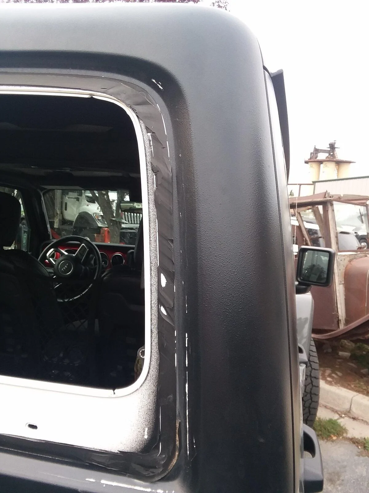

The dealer had the glass company come to my house, so I could watch what happened. The old glass was very difficult to remove. Mopar uses a seal channel that is glued (urethane) onto the glass. That seal channel gets urethane when installing it. If you look at the picture of the full window below, you'll see that the channel makes it very difficult for the glass folks to run their knifes through to cut the seal when removing. The bottom is especially difficult as it is extremely far from the edge of the glass. Also, the window slide frame makes accessing the seal almost impossible from the inside.
The gentleman who worked on my truck ended up breaking a knife which damaged the paint (see pic). So, after the glass was removed, I took the gladiator to a body shop where the top was repaired and the rear section repainted before the new glass was installed. This made the ordeal a 2 day affair.

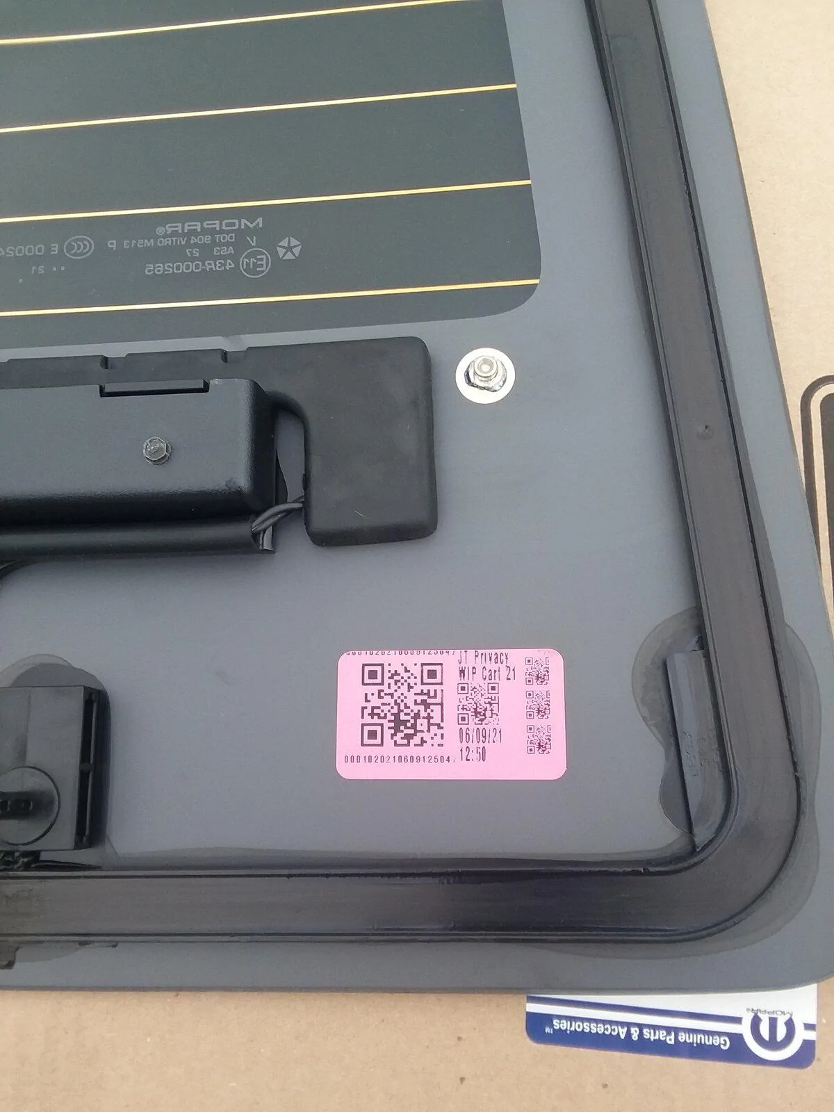

The old window was leaking in the center of the very top. I attempted to take a pic (see below). When Mopar attached the seal channel they used urethane. But at the top center, they failed to use enough and it created a void between the glass and seal channel. You can see in the pic that the urethane was dirty and dry looking - it did not adhere on both sides. The new glass (which reportedly was a new part number) had a thicker, more substantial bead of urethane. I am confident the leak has been fixed.

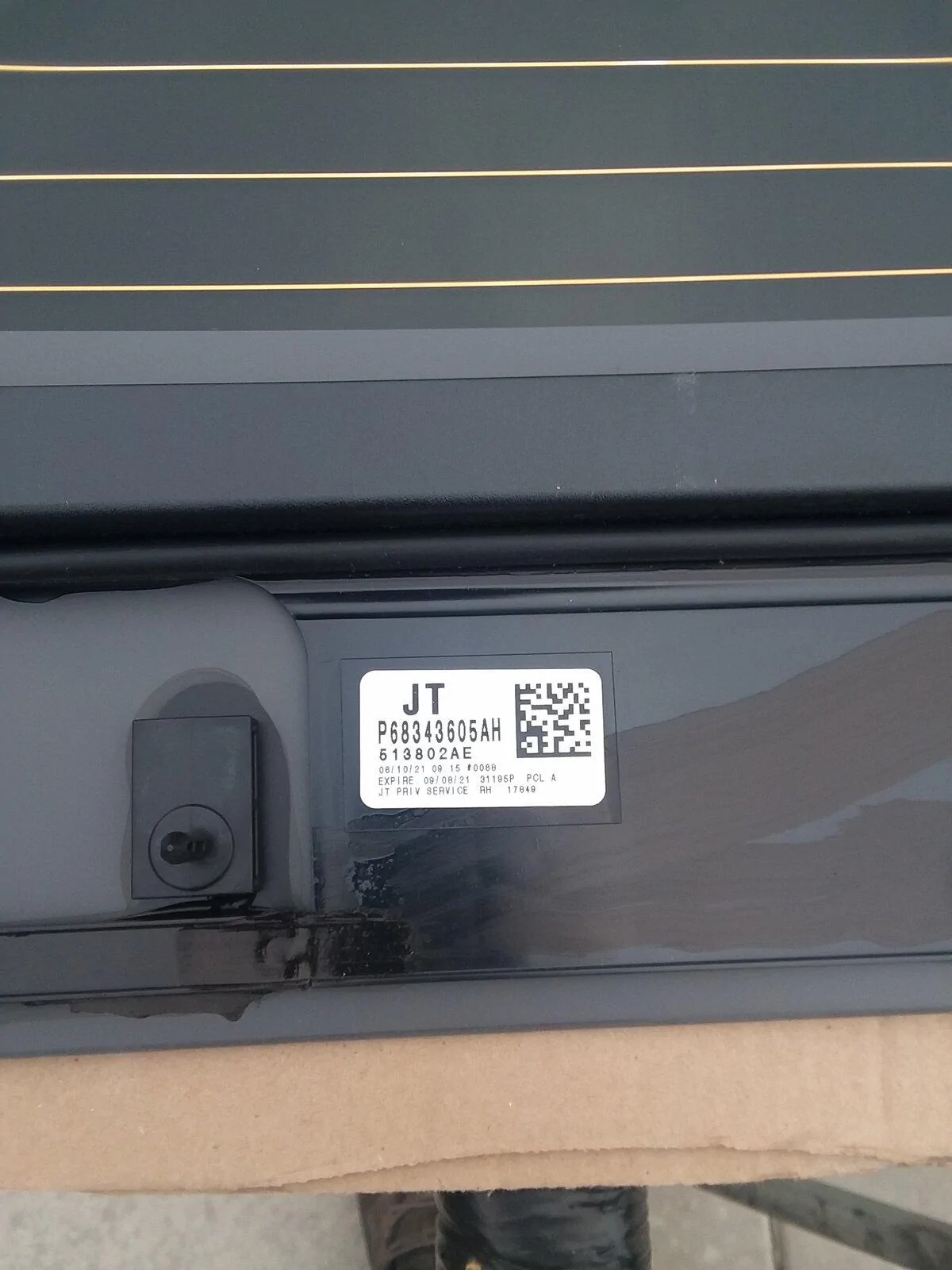

Note - first 3 pics are of the new (possibly new part number) rear glass
