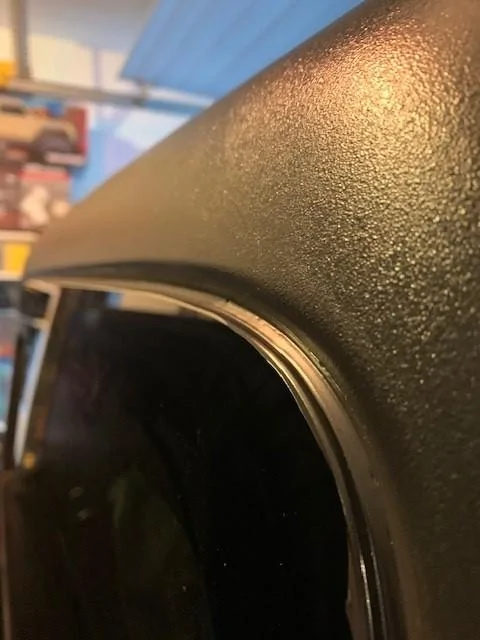

What product did you use?
If that question was for me, I used rubber vacuum hose. I honestly don't know the size I bought because I had several different sizes 'in stock'.

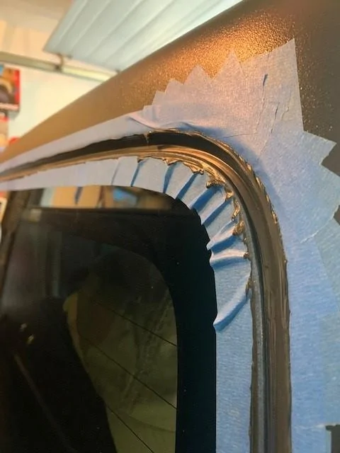

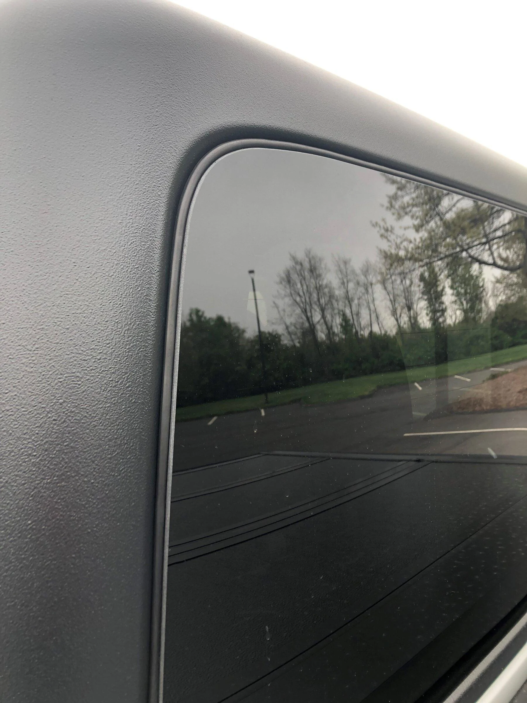

I tried multiple sizes of weatherstrip and neither worked for me .... I ended up sealing with a polyurethane and haven't had a leak since. Note that I did not fully fill the void with sealant... I did first run a small dia backer and then applied the sealant over.
Jeep Gladiator Roof leak in back jtwindow2
Jeep Gladiator Roof leak in back jtwindow3
