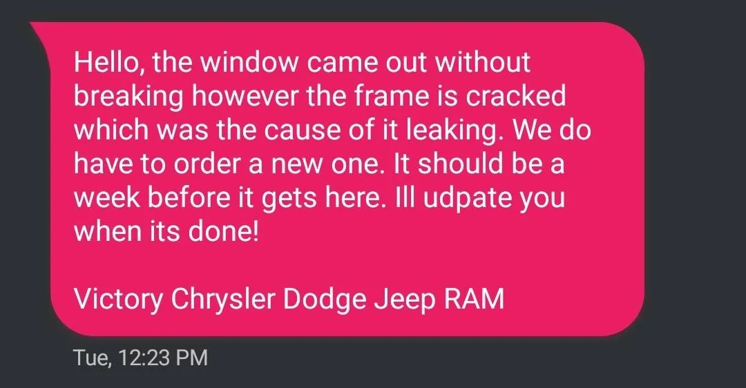

I finally got mine in last week and just heard back yesterday. Apparently the frame around the glass is cracked and causing the leak, so they have to order the part. I looks like at least 7 more days with the loaner...

what frame are they referring to? the hard top itself, or is there something else I'm missing?

The rear window glass has a frame around it it attaches to, and then that whole assembly is attached to the top. The problem on most of them is the frame part cracks and that’s what leaks. The 5th Gen Ram uses the same design and has the same issues as well.

Thanks for clearing that up. My local glass guy finally got my replacement glass in and it's scheduled to be replaced on Friday.

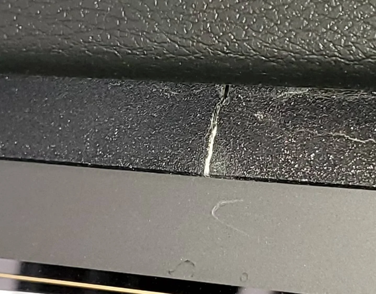

Rain in Socal....mine leaks. I have the typical crack in the frame, visible above the rear window from the inside.
Jeep Gladiator Roof leak in back Screenshot_20230114-113406_Gallery
I read this whole thread. Not gonna bother with warranty. Don't need my truck screwed up by a bunch of minimum wage work ethic apes. Even if I got a good result....it is the design that is shit. The part has not been revised. A new one will just crack again.
Gonna pull the interior pieces and seal that side and try the weatherstripping on the outside for now.

Took the back interior panel off. Broke 2 clips. They'll be rattling inside the hardtop forever now unless I can figure a way to fish them out. Oh well. Anyway, used a spray bottle and learned some things.
Watch these:
Weatherstrip did not work. Made no difference.

After 3 years my leak just started, or I just noticed. I'm out of warranty so out of luck. Someone in this thread or another thread recommended Permatex 81730 Flowable Windshield & Glass Sealer. We've had a few very heavy rains since I applied the sealer and not a drop of water inside. Great fix for $7.

Thanks. I had my wife sit inside while I doused water. She said the water comes in right at both metal clips. It then fills up the channel and leaks everywhere. Had to remove the interior trim piece to see this. My frame is also cracked top center, but water doesn't come in there.
My videos a few posts up show them both inside and out for anyone interested.
