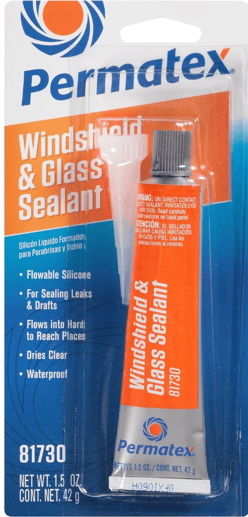

I don't think there is a reliable fix. They will just keep putting the same defectively engineered parts back on.
Now that it has stopped raining in SoCal and I can pull my "outdoor offroad truck" out of the garage, today I will be trying the Permatex option:
Jeep Gladiator Roof leak in back 1673974198646

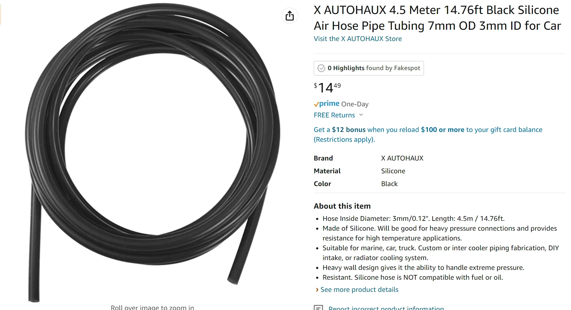

If this fails, I will layer on the next option, 7mm vacuum hose around the perimeter:
https://www.amazon.com/dp/B0BGSK8VTN?psc=1&ref=ppx_yo2ov_dt_b_product_details
Jeep Gladiator Roof leak in back 1673974271831
I will report results. Unless Jeep revises the window design to one that doesn't suck, I am not going to play repair parts roulette with them.

so about two years ago I did the tubing in the channel dry with no silicone to fix my leak...so far so good..if it does leak again I might put silicone with the tubing..my thought was if the tubing rotted I could easily replace it
How far around did you wrap it? It seems it will easily fit up top but the sides get much more narrow.....
ckgjt
Dec 17, 2019
135
254
Murrieta Ca
2020 Jeep JT Max ToE
I went all across the top and down about 3 inches on each side..I figured it would just run out at the bottom with no issues and so far so good there also ...I have a shell on now or I would take pictures

Got the Permatex on. Will test tomorrow. I used a super bright Streamlight flashlight to look in the gap to make sure it was clean. It was, but I noticed the gasket was smashed....for lack of a better word....on one side. I couldn't see it on the other side or the center...but driver side it was pinched upwards. So mine is cracked and installed improperly.
I tired to photograph it but I just couldn't focus on it...very hard to see. I will test tomorrow and whether it leaks or not add a second coat and then install the vacuum hose. Belt and suspenders approach.
I did the rubber tubing as well (no other sealant, just the tubing). I went all the way down both sides, but left the bottom open. You're right, the sides get a little narrower. I used isopropyl alcohol as an installation lubricant, but it was still a PITA to go down the sides. I was going to stop about 3-4" down each side, but I didn't like how it looked.
