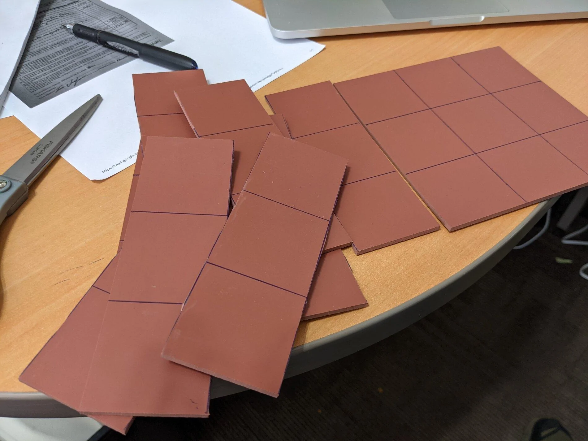

For others information...

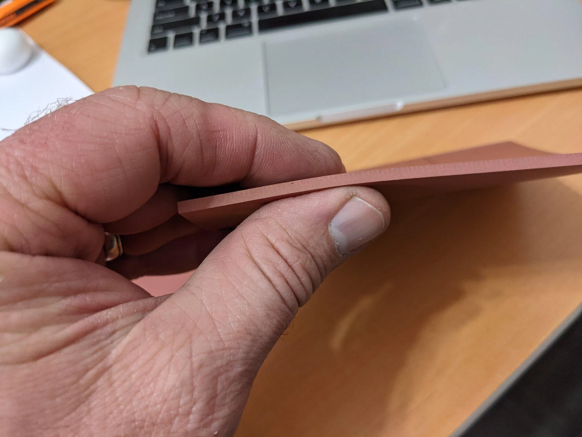

I used red gasket material from the plumbing dept. (someone here gave me the idea). It measured approximately 1/8" thick. I cut them into two inch squares. I started at the back and put 4 under the block, the next block received 3, the next 2 and the front block 1. I did this to both sides. I didn't like the idea of not supporting the other clamps and blocks as it tapered to the front.
I know this is more than the stated 9/16" but when I put only 3 at the rear block the tail gate still dragged the D gasket and crushed the lift gate gasket. When you first put them on you will see light under the D gasket. Once it get snugged down no more day light and the fit seems perfect.
Good luck

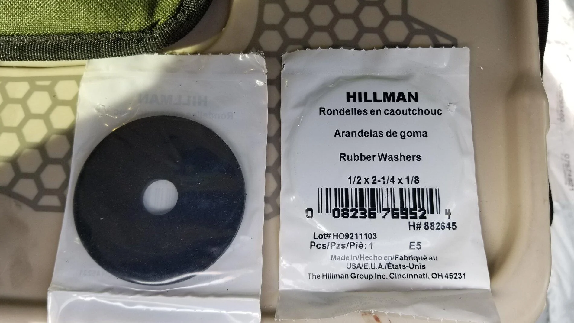

I took the extra rubber seal that goes around the outside edge and cut four short pieces. I stuck two together and pushed them under each rear corner. I got some rubber washers from Lowes to stick under each one.
Jeep Gladiator RSI Smartcap 20210322_163049

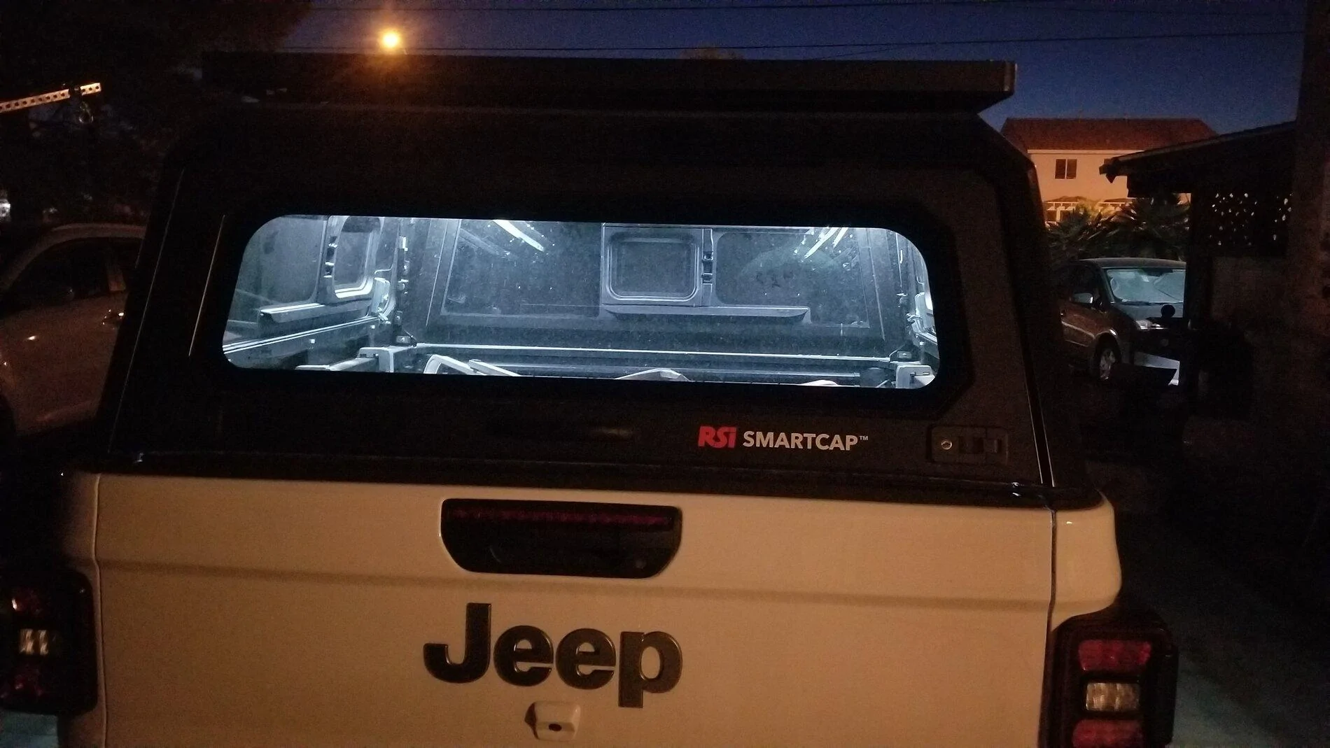

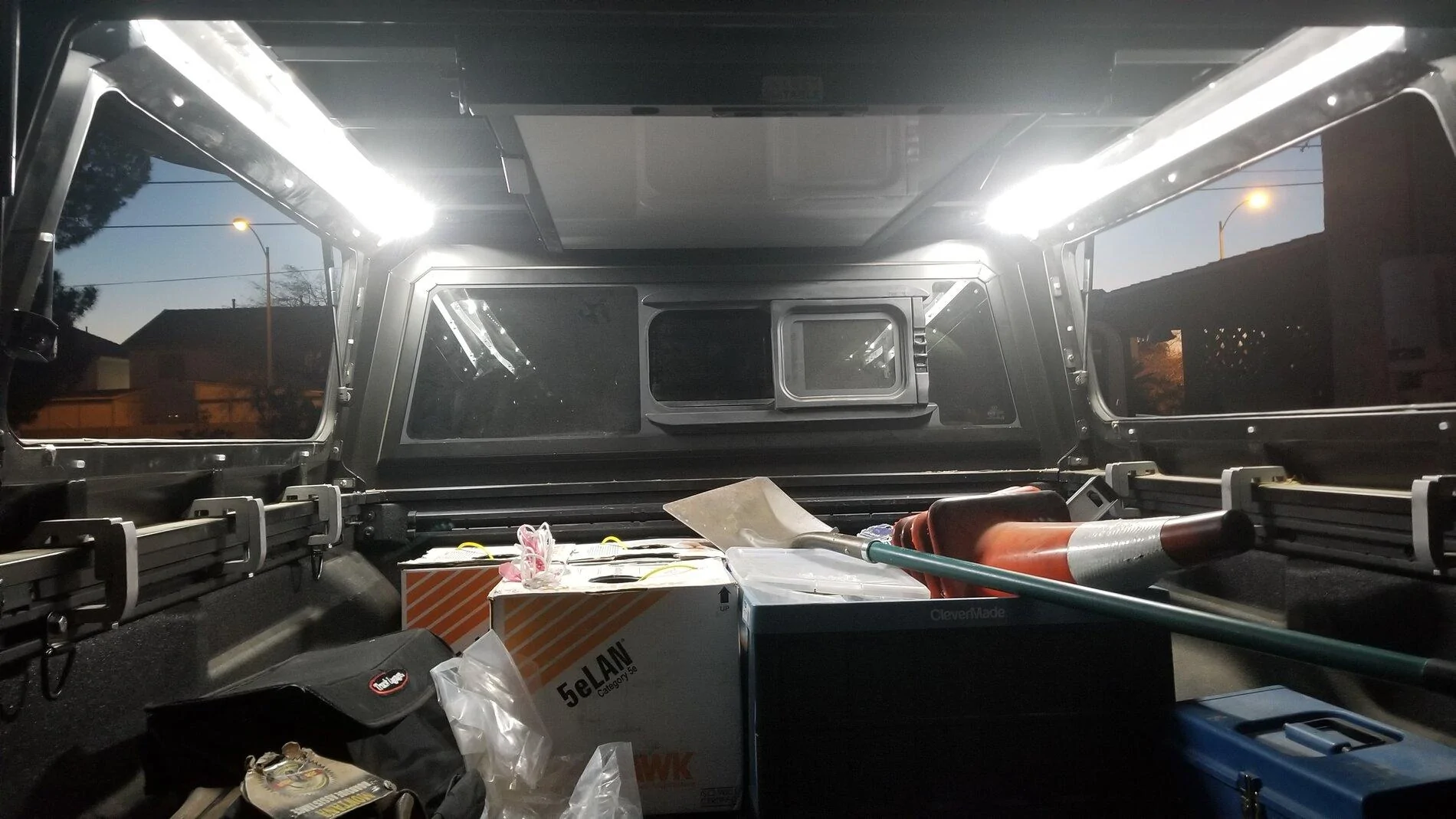

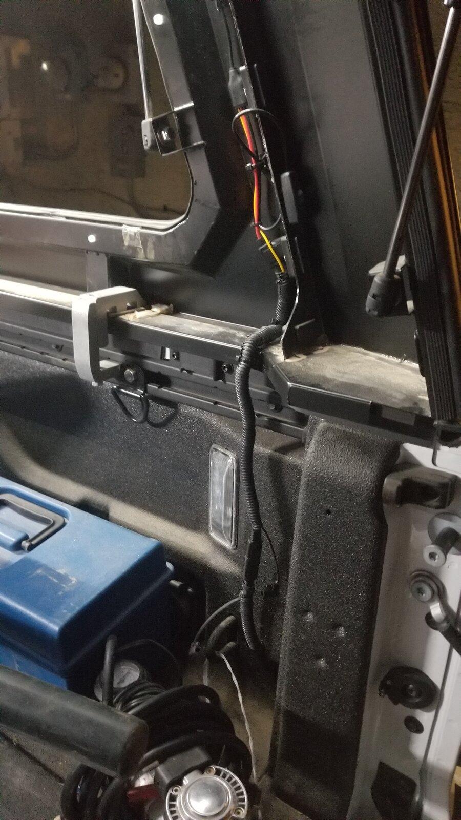

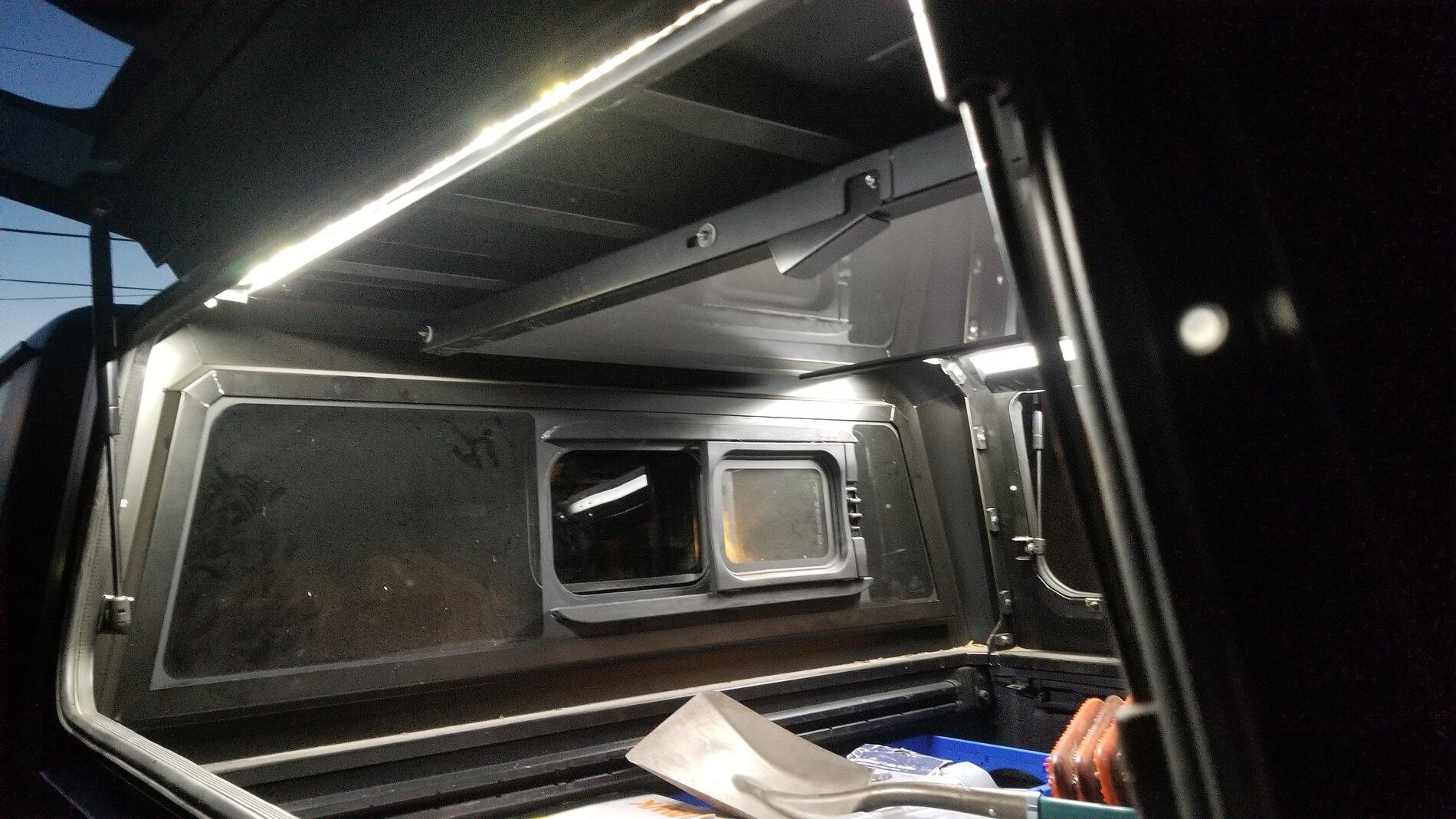

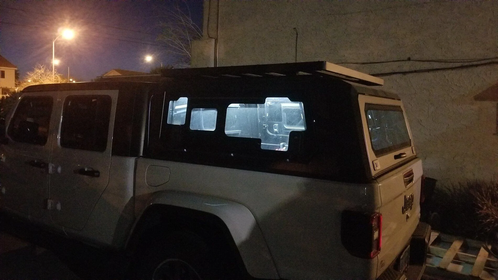

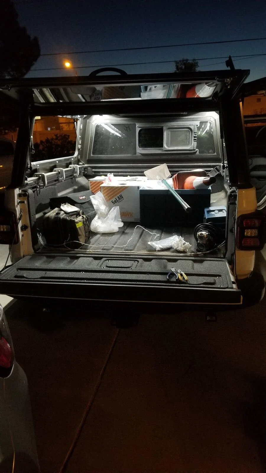

I installed lights in mine this weekend. I ordered some LED strips to go under the top rails some months ago. When I went to install them, I discovered that this area is covered up by the trail rails. So, I put them along the roof with a quick connect plug in the lower corner. The strips are too long, so they make a u-turn at the front corners and come back down the other side a short distance.
Jeep Gladiator RSI Smartcap 20210328_192905
Jeep Gladiator RSI Smartcap 20210328_192932
Jeep Gladiator RSI Smartcap 20210328_194004
Jeep Gladiator RSI Smartcap 20210328_194205
Jeep Gladiator RSI Smartcap 20210328_195212
Jeep Gladiator RSI Smartcap 20210328_195232
