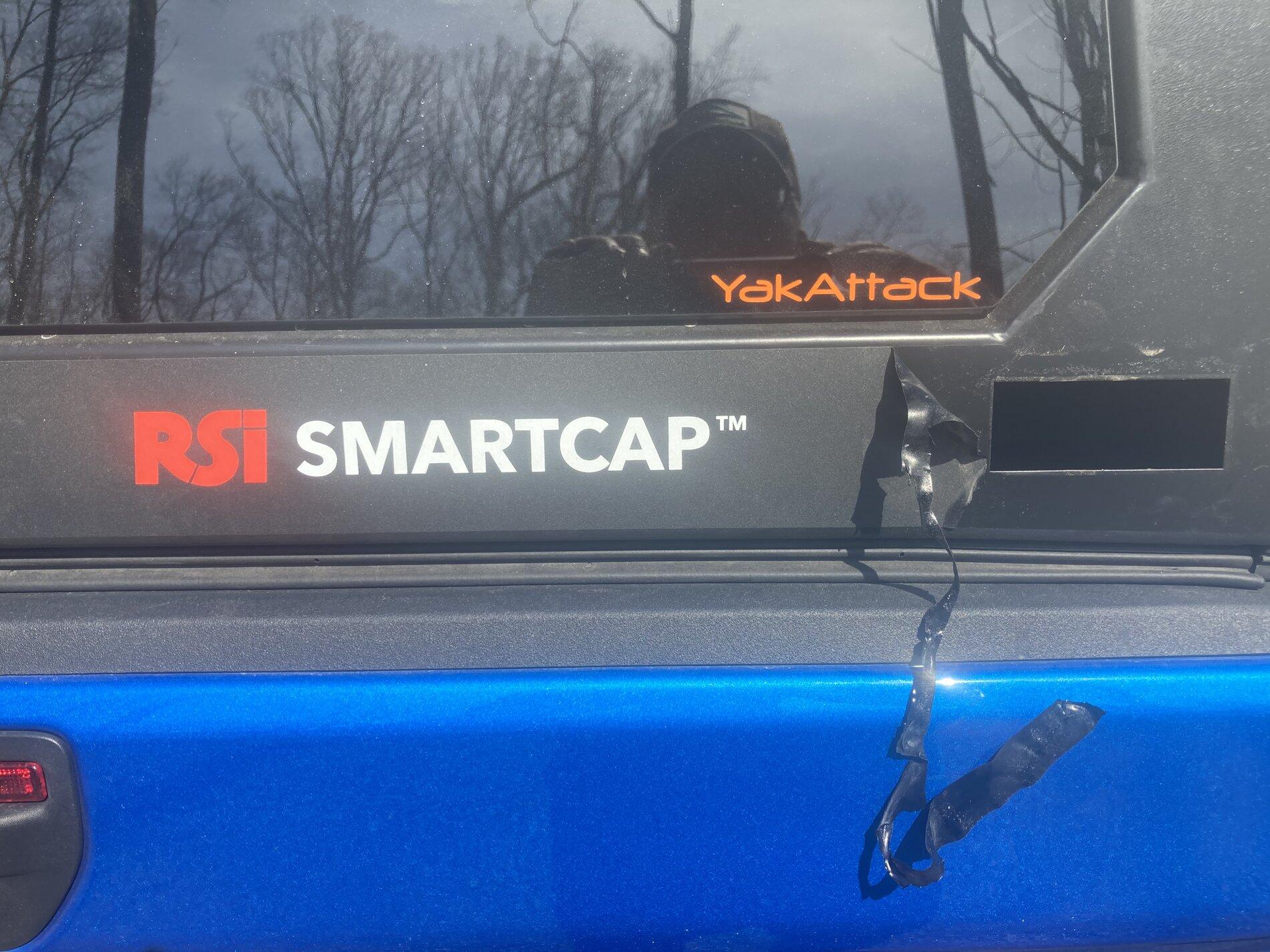

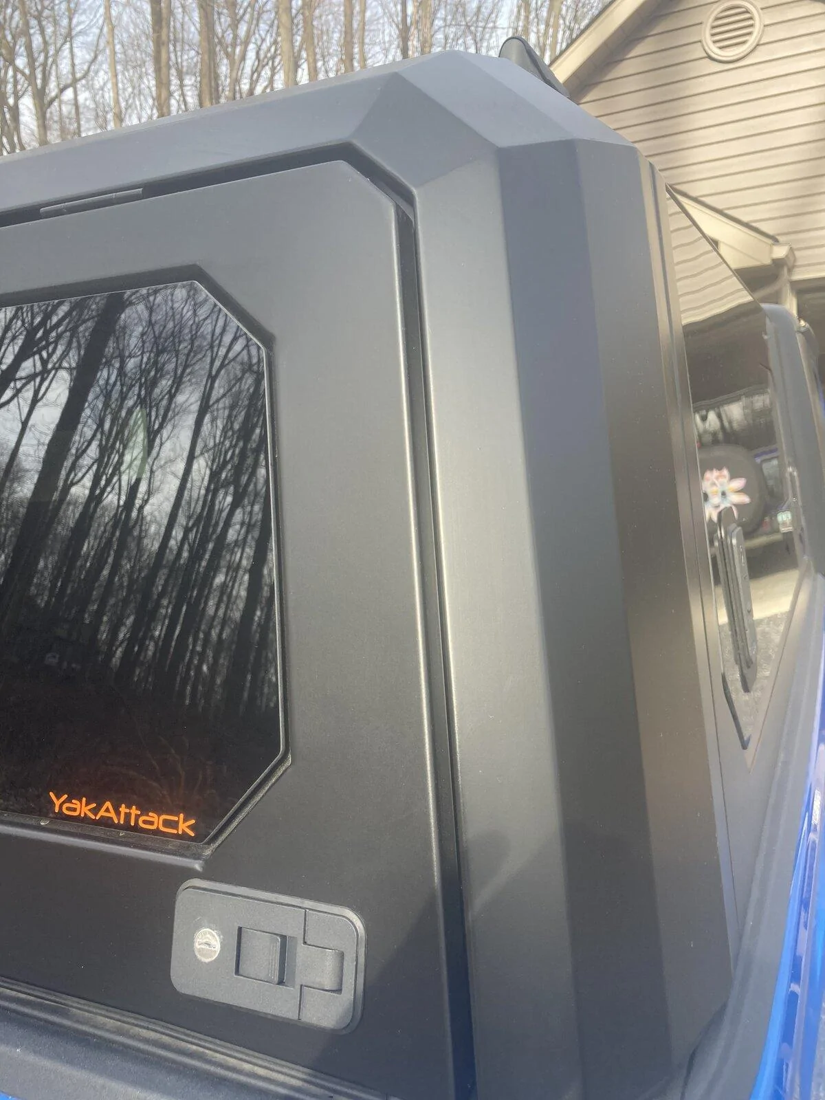

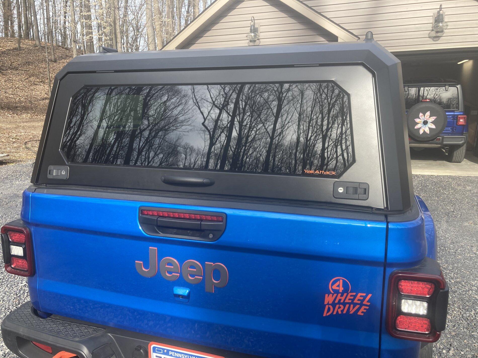

Made a little change purely cosmetic, still love my RSI cap and would buy one again. Just didn’t like the sticker on back and , didn’t mind that RSI sticker but the whole door frame is vinyl, this is a long term truck for me even if the little V-8 comes out, ok maybe then, figured better to have an all stainless cap that grows old with me!
Before and after shots.
I'm ready to do this label removal as well. After spending too much time cleaning up the goo that drips from the side latches, I was hesitant to attempt this one.
Does it come off clean, or did you have to clean up adhesive residue?

Have to clean the glue off, did it on a hot sunny day and used goo-be-gone, but took a while. I figure three or four years from now it will be much harder to get off.....Jack

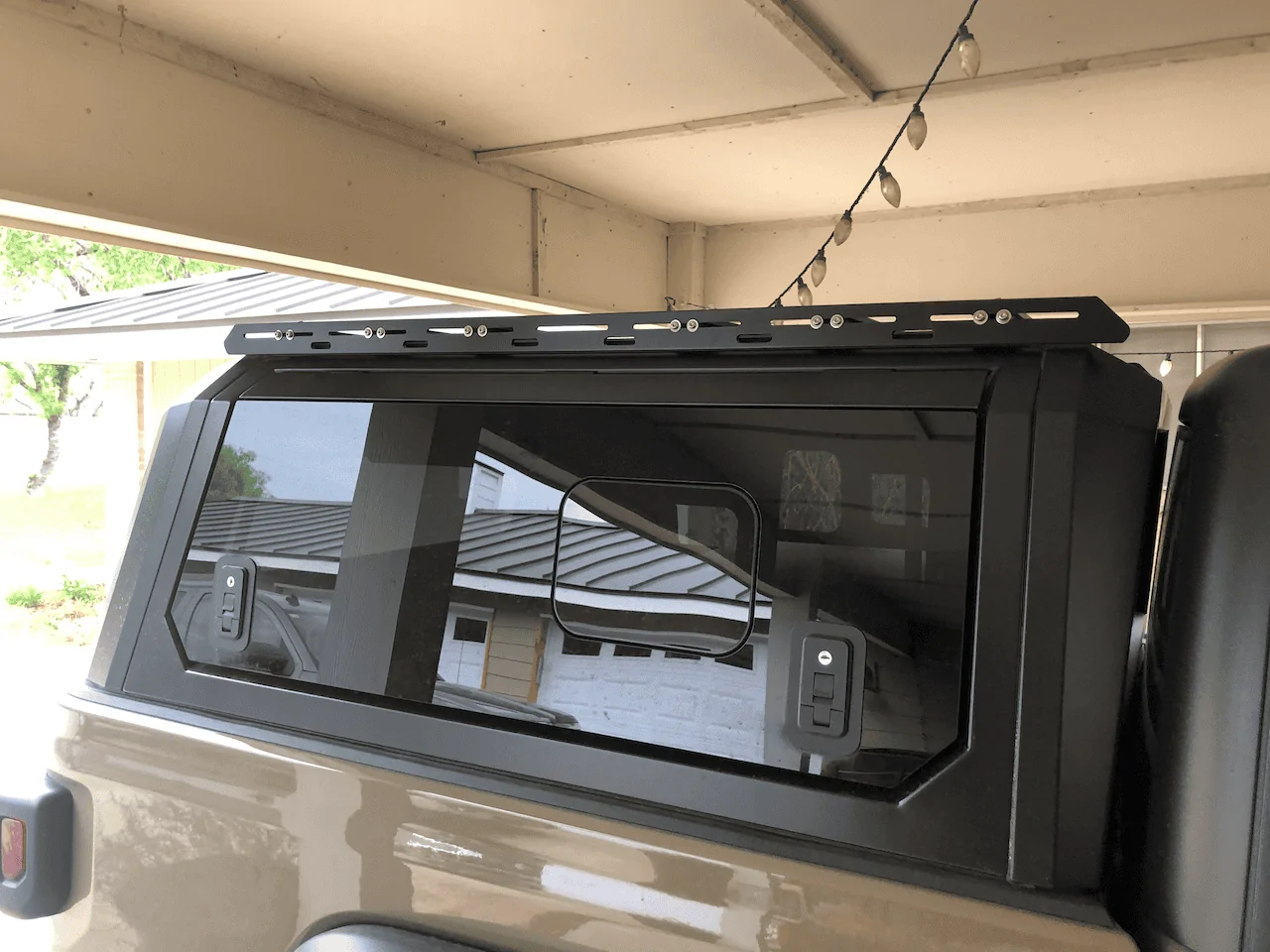

DIY top rack. Crossbars are 1x2 extruded aluminum and side bars are 1/4" x 2" aluminum bar. I cut the slots on my router table with a 1/4" spiral upcut bit in small depth increments until the holes were through.

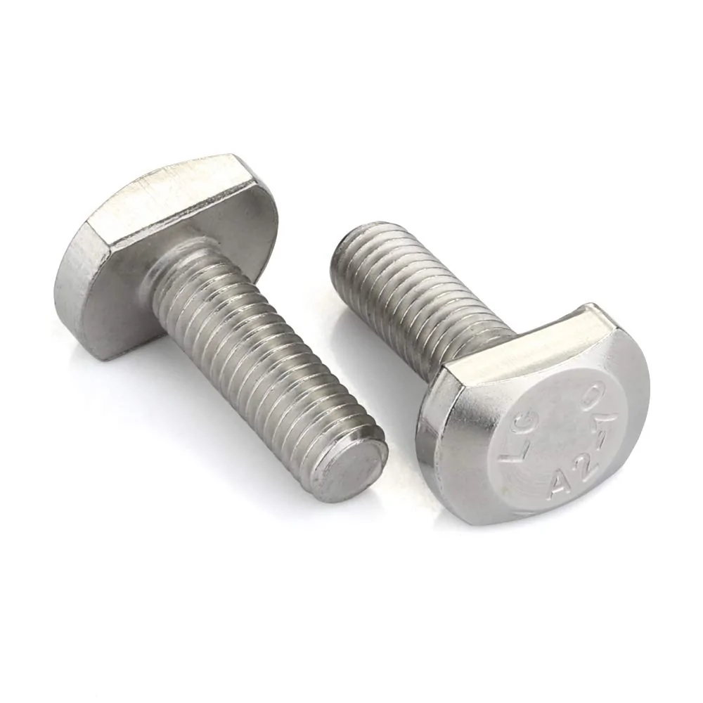

What mounting bolts/nuts did you use? Given that the RSI crossbar is so backordered, I'm trying to figure out another solution, and I've not seen clear info anywhere on specifically what is needed.... e.g. an M8-1.25 Nut or Bolt of what width (...13mm, 14mm?) and thickness (...5mm, 7MM?) would work in the T-slot? Did you put the nut in the T-slot, or use a square-head bolt in the T-slot?
Thanks!

Yes, I didn’t notice right away either, but yes, I think it looks better and will look better years from now , sounds like second batch didn’t have it. Removing all that weight reduced my rear sag by 1/64 th of and inch ..Ha!......Jack
hmmm...hot sunny day may be hard to come by....but I have a heat gun! Sadly with RTT on top she's to tall to fit in any of my buddies garages....

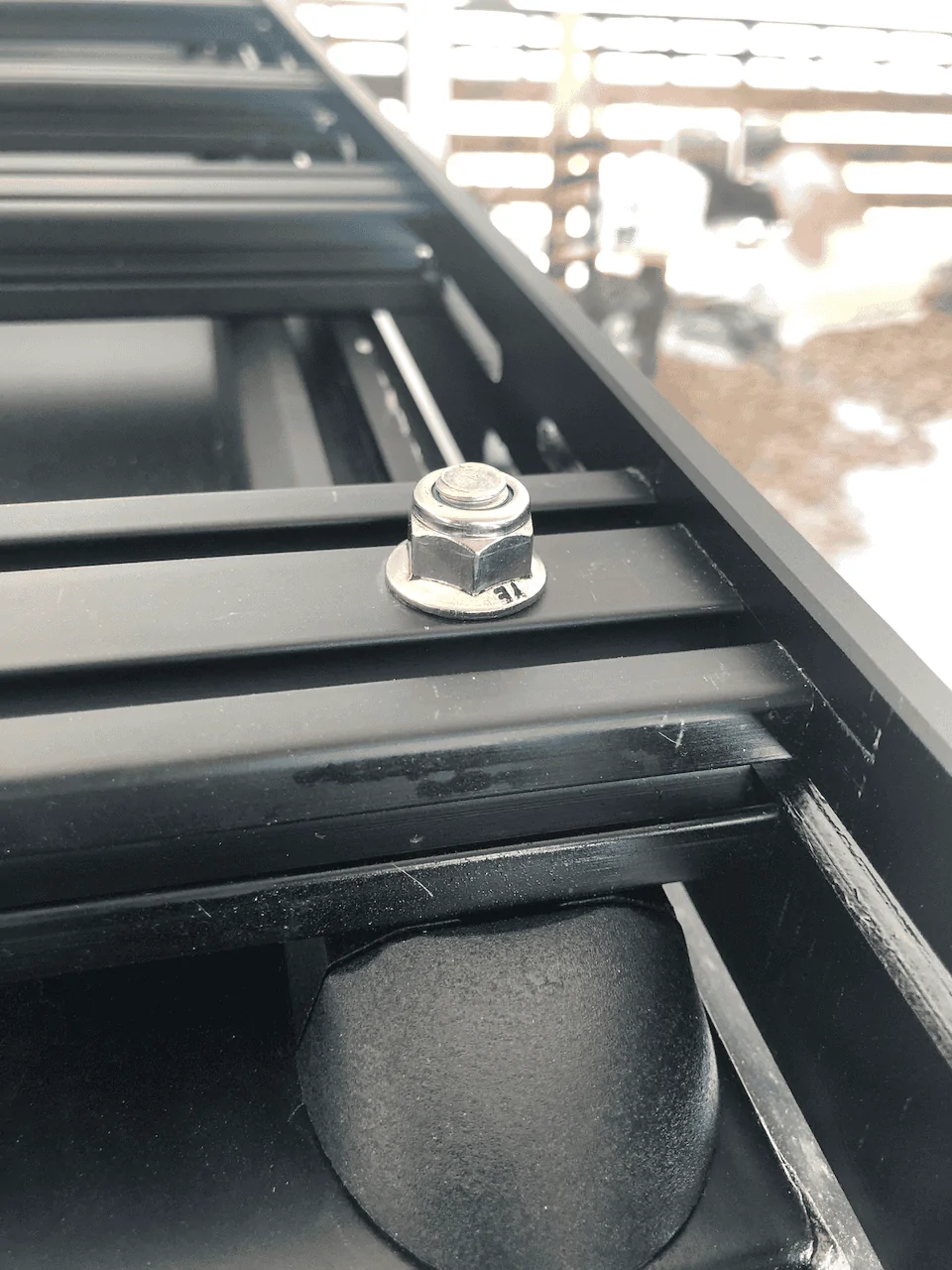

Thanks!
Here's what I used: https://www.amazon.com/gp/product/B083F9GYDL/ref=ppx_yo_dt_b_search_asin_title?ie=UTF8&psc=1

Sweet, Thanks! Looks like 14mm wide, and 6-7mm thick is the sweet spot.
