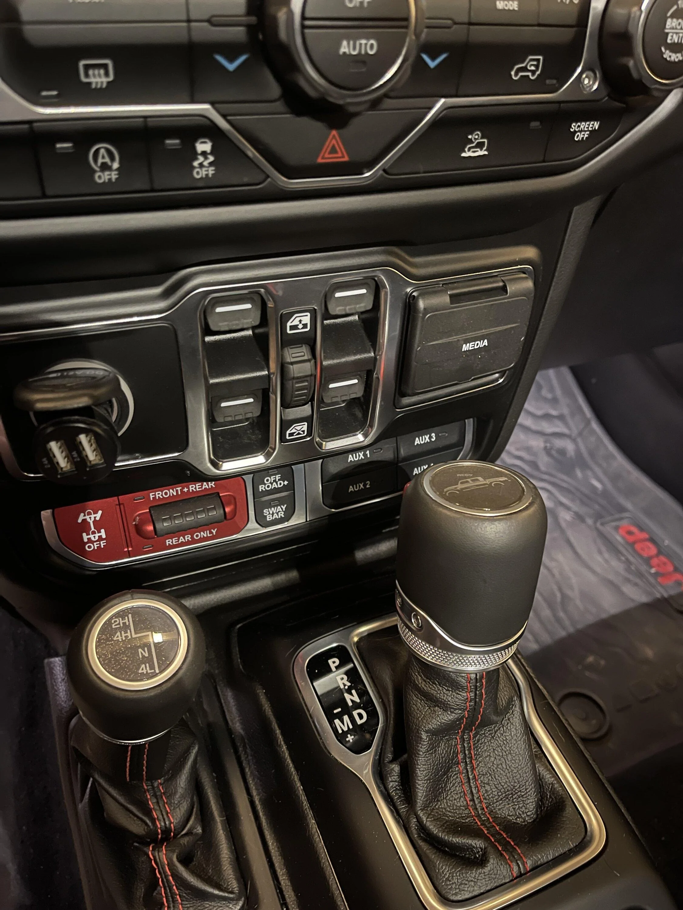

My 22 Diesel Rubicon did not come with the aux switched. I did however add them. It was not that hard if you are mechanically inclined.
Jeep Gladiator Rubicon with no aux switches? IMG_2707
