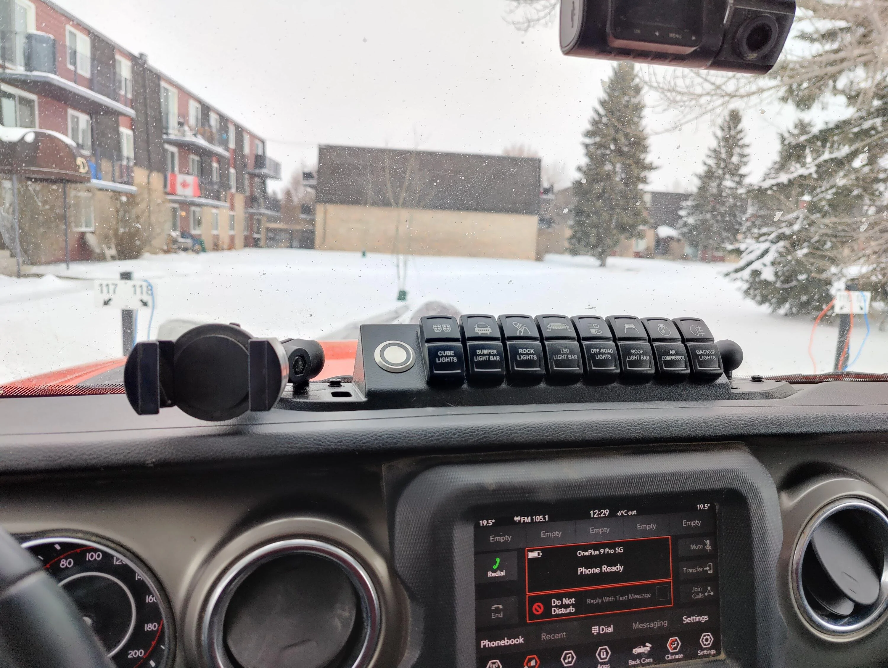

I didn't like the location of the factory switches in my test drives... Also only 4 switches!
I ordered a Voswitch JL200, because 1. Who doesn't like the look of rockers? And 2. Things fall out of that too holder at anything more than a 15° climb, a safety hazard in a manual trans!
