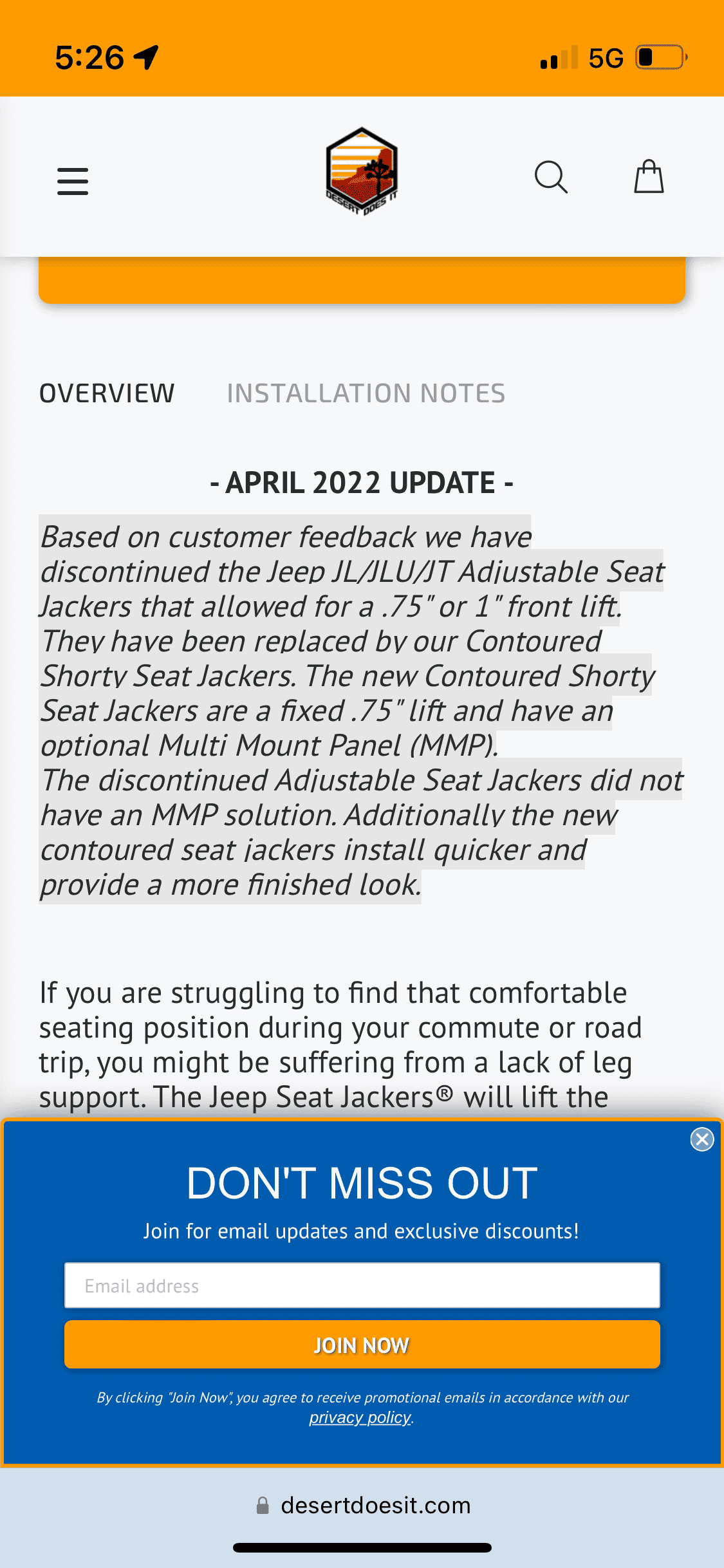

I said the same thing!! Sold my 3/4in ones a while ago and it gave me the perspective to realize i liked the oem seat more than I realized.
i also reached out to the company and they said they couldn’t make anything smaller than 3/4. If I remember right it had to do with the hardware or something failing at smaller sizes.
That doesn't make sense as the .75" jacker is part of the adjustable set which has a smaller piece included....

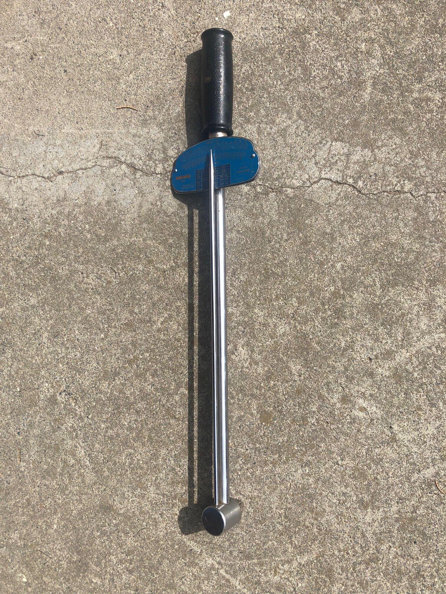

Adjustment?
WHAT adjustment?
Now THAT'S a torque wrench. Same type that I use for installing head bolts in 3.6 Pentastar engines. Over eleven years and hundreds of heads with no problems.
I got this fella over 45 years ago (damn, I’m OLD!!) to put head bolts in a big block Ford V8.
It’s been one of the most reliable tools I own.
Which kit is that? When i got mine it was either 3/4in or 1in. Which is actually a discontinued set now.
The original kit. The 1" is achieved by stacking a .25" on top of the .75". I guess they're saying you can't use the .25" alone. I never looked as .75 is what I installed first and liked.
Ahhhh i got ya now. Yea the kit that had the 3/4 and the extra 1/4in spacer allowed either 3/4 or 1in. But not the 1/4in by its self. Which is exactly what i was after and was sad it wasn’t possible.
