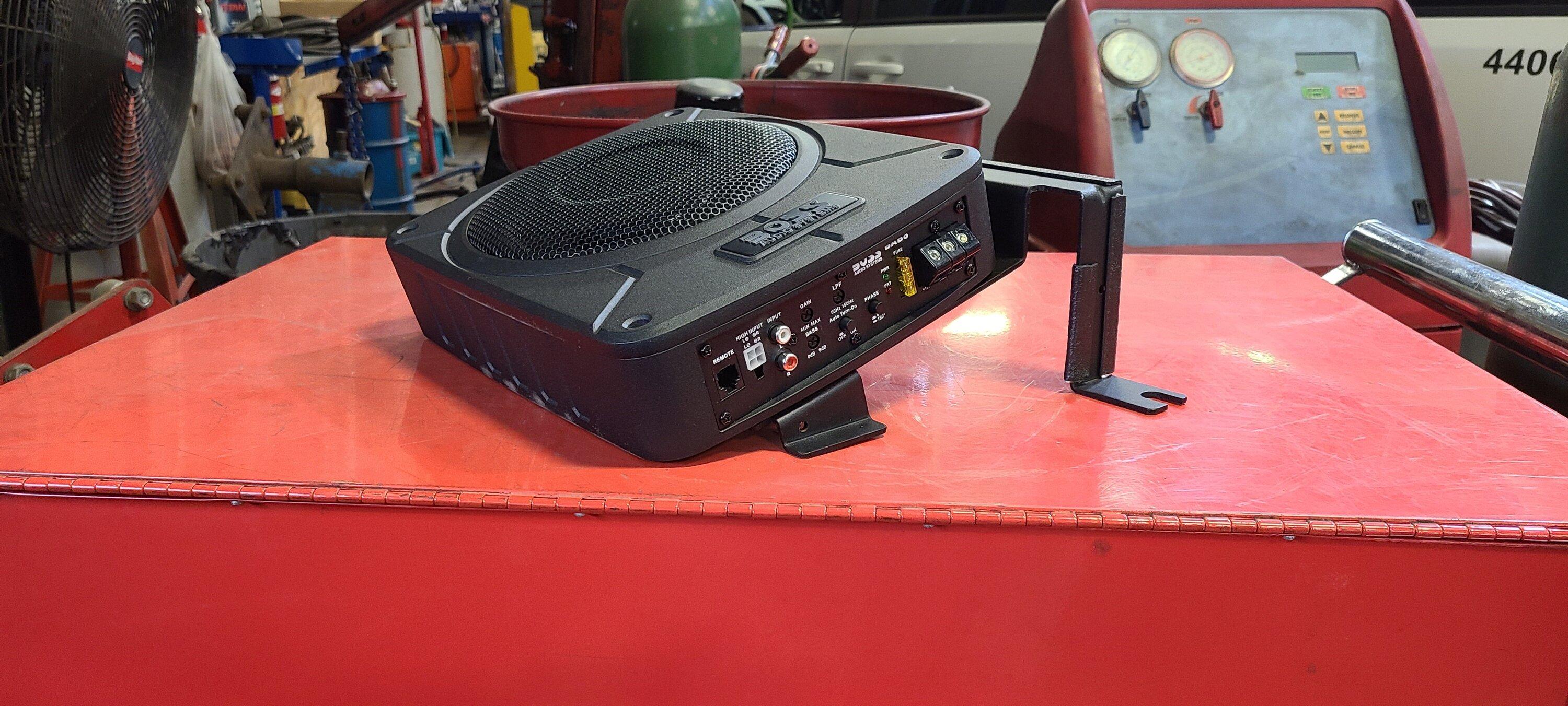

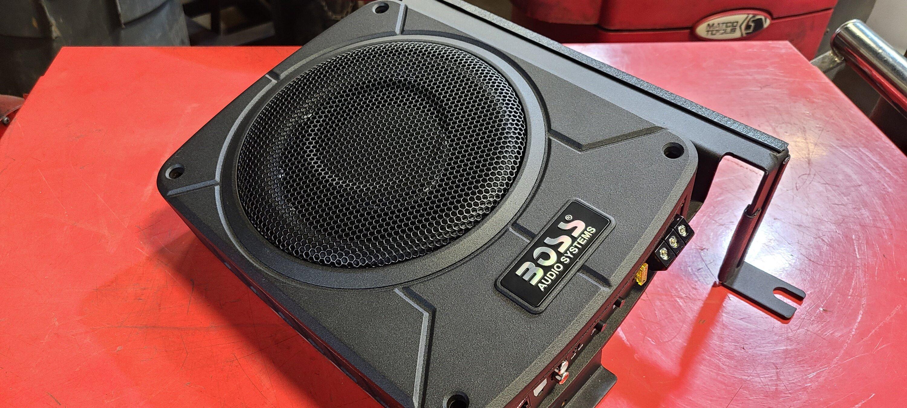

Seat jackers! Changes the angle of the dangle! I felt like I was falling out of my seat before I tried them and my back would kill me after a day of cruising the green and white mountains of VT and NH. No more! Now I just drove 5000 miles in the last week all over New England on vacation. Jeep fully naked I felt way more planted and comfortable driving. Plus they helped fit my amplified subwoofer easier under the drivers seat.
