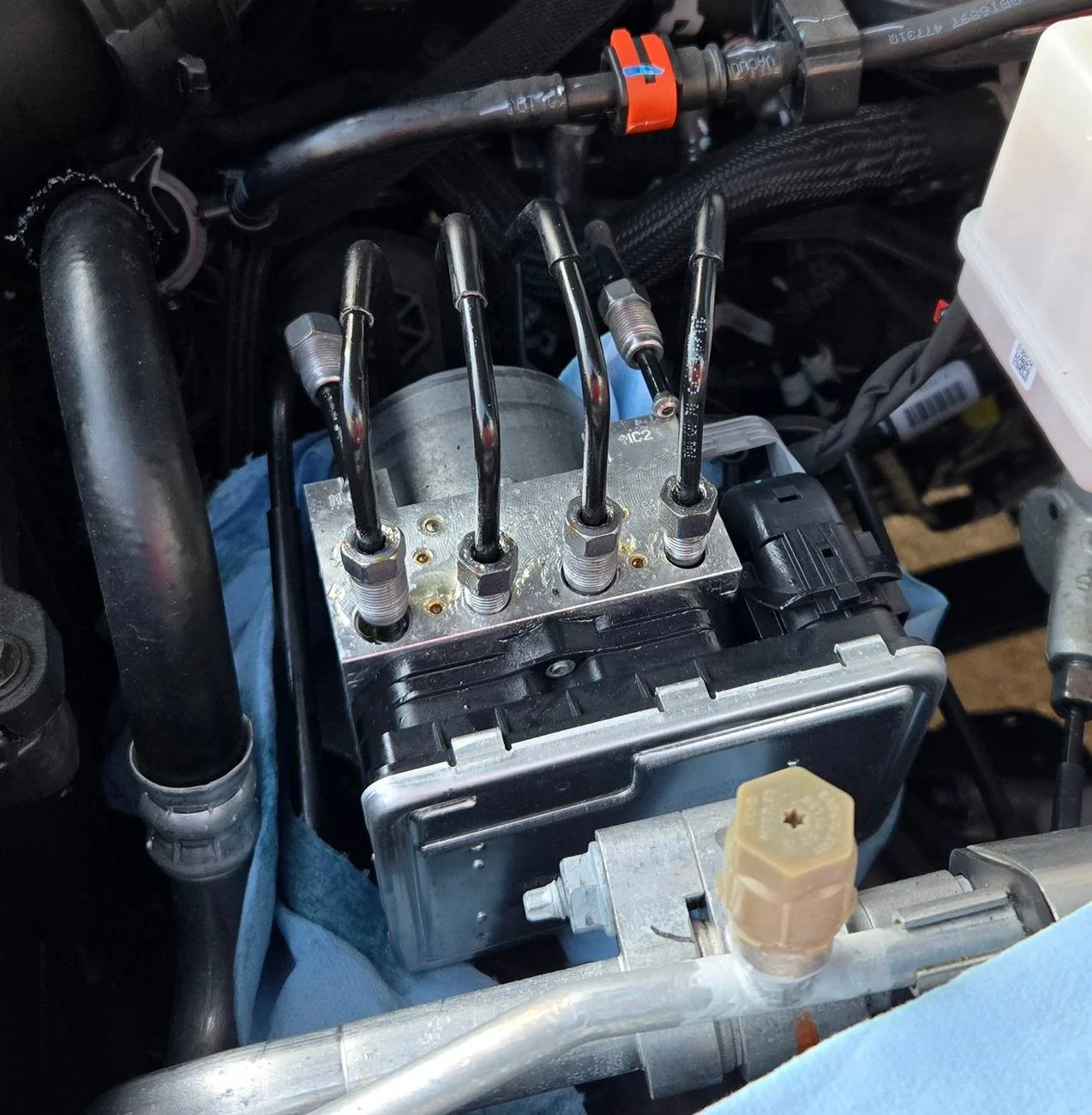

For this to happen, obviously you need the DASM unit, NEW* ABS control unit and ABS system module that the DASM can control. Your existing ABS module is not capable of receiving input from DASM.

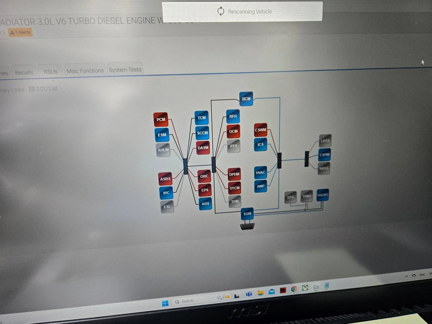

I used AlfaOBD with Security bypass plus Bluetooth OBD connector, Mongoose J2534 Cable for Chrysler vehicles to be used withOUT Security bypass plus Witech2.0 subscription to install the new ABS components and DASM.
Witech2.0 subscription is required to perform ABS initialization and other required sensor calibration for the new ABS module and control unit. I tried for half day to figure out if I can get the new ABS components programmed with AlfaOBD. It just does NOT work.
Having said that, AlfaOBD is very important in this install because there was not a clear way for me to enable the DASM from Witech2.0.
Once, the DASM is enabled through AlfaOBD, you can see the DASM selectable from the topology view on Witech screen. Only then you can go through the DASM calibration.

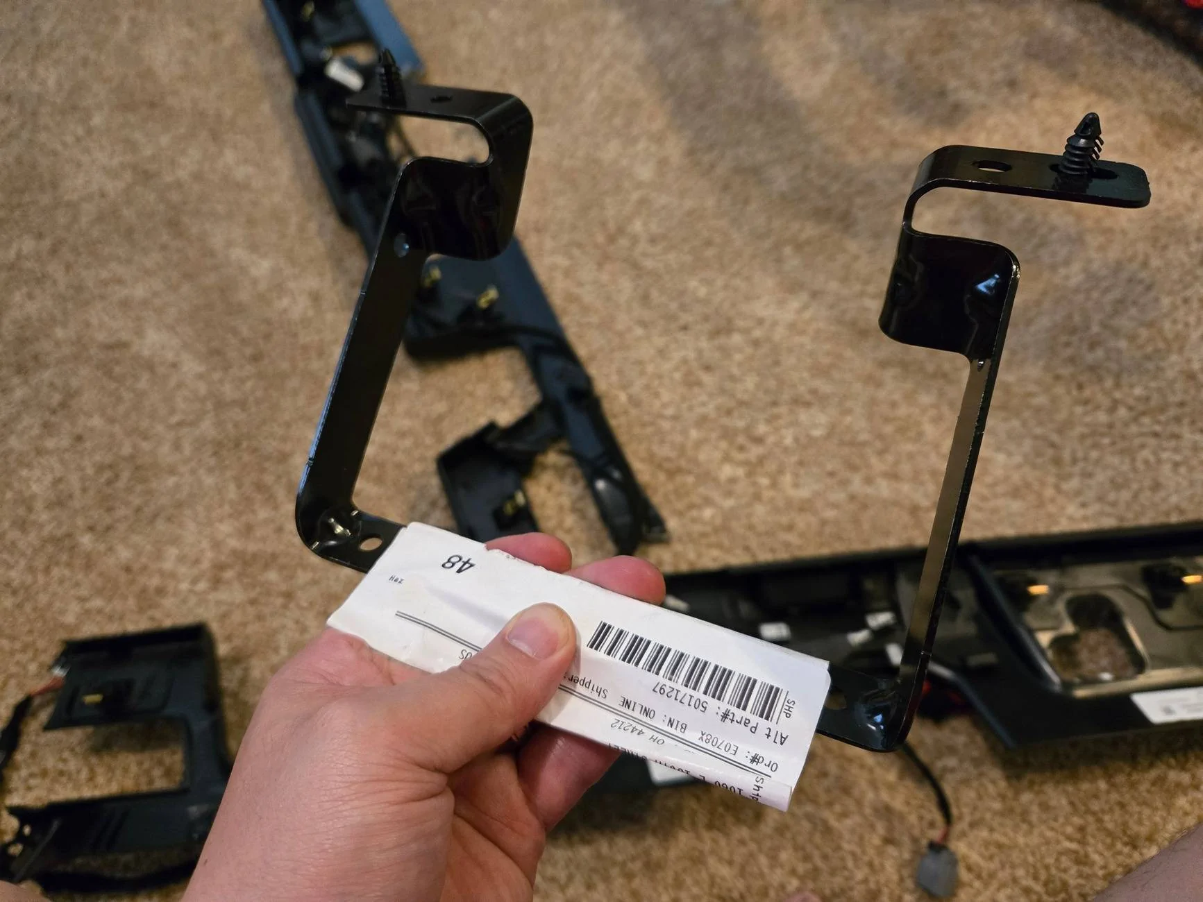

ACC Bracket - 68422194AB

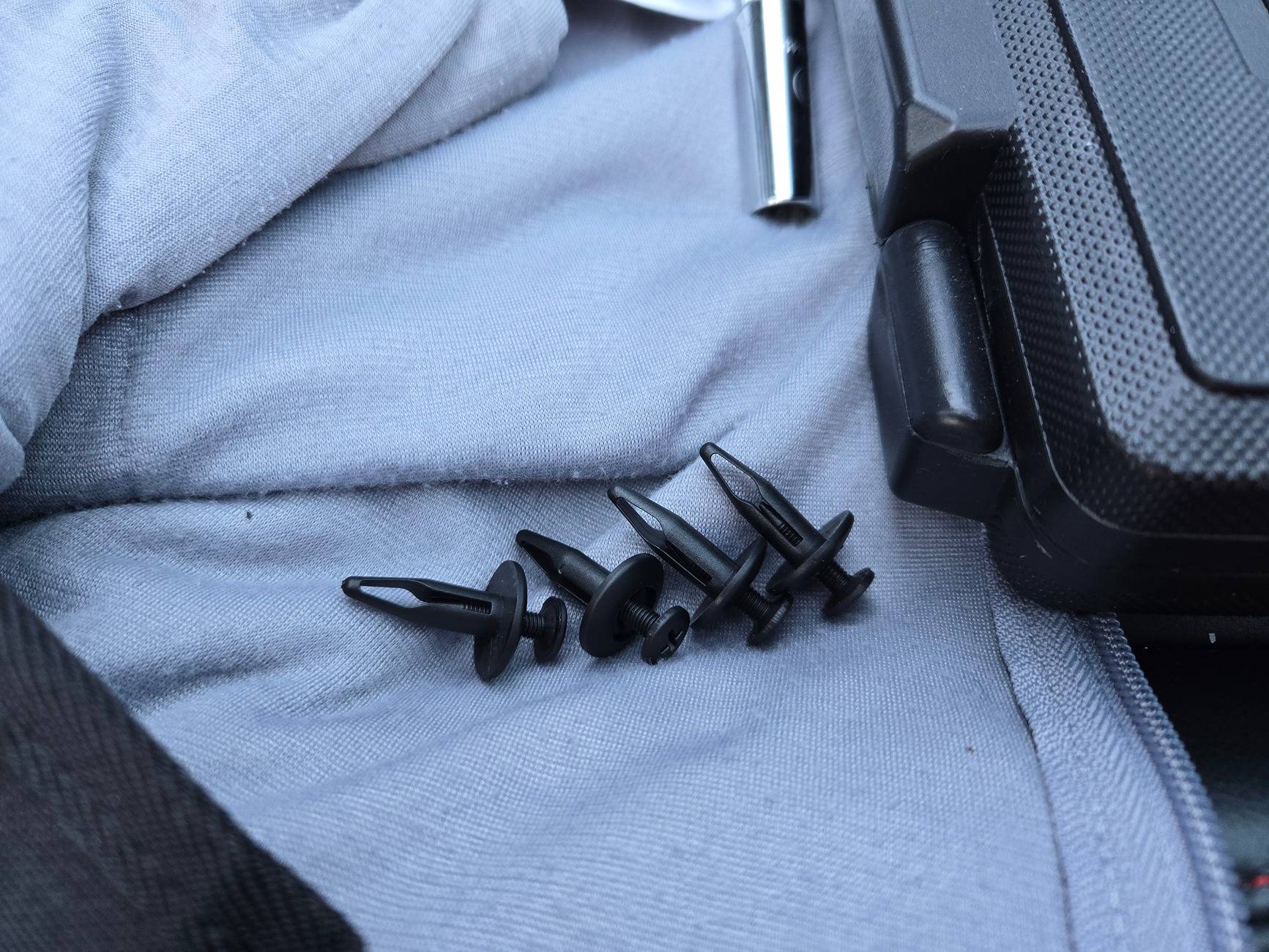

Plastic trim Screw QTY of 4 (GM 20664092 Ford N804570S, https://a.co/d/0qpKidE)

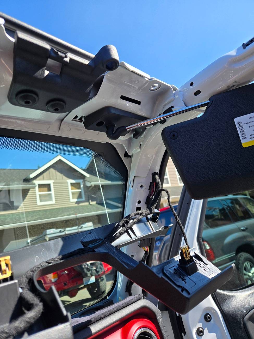

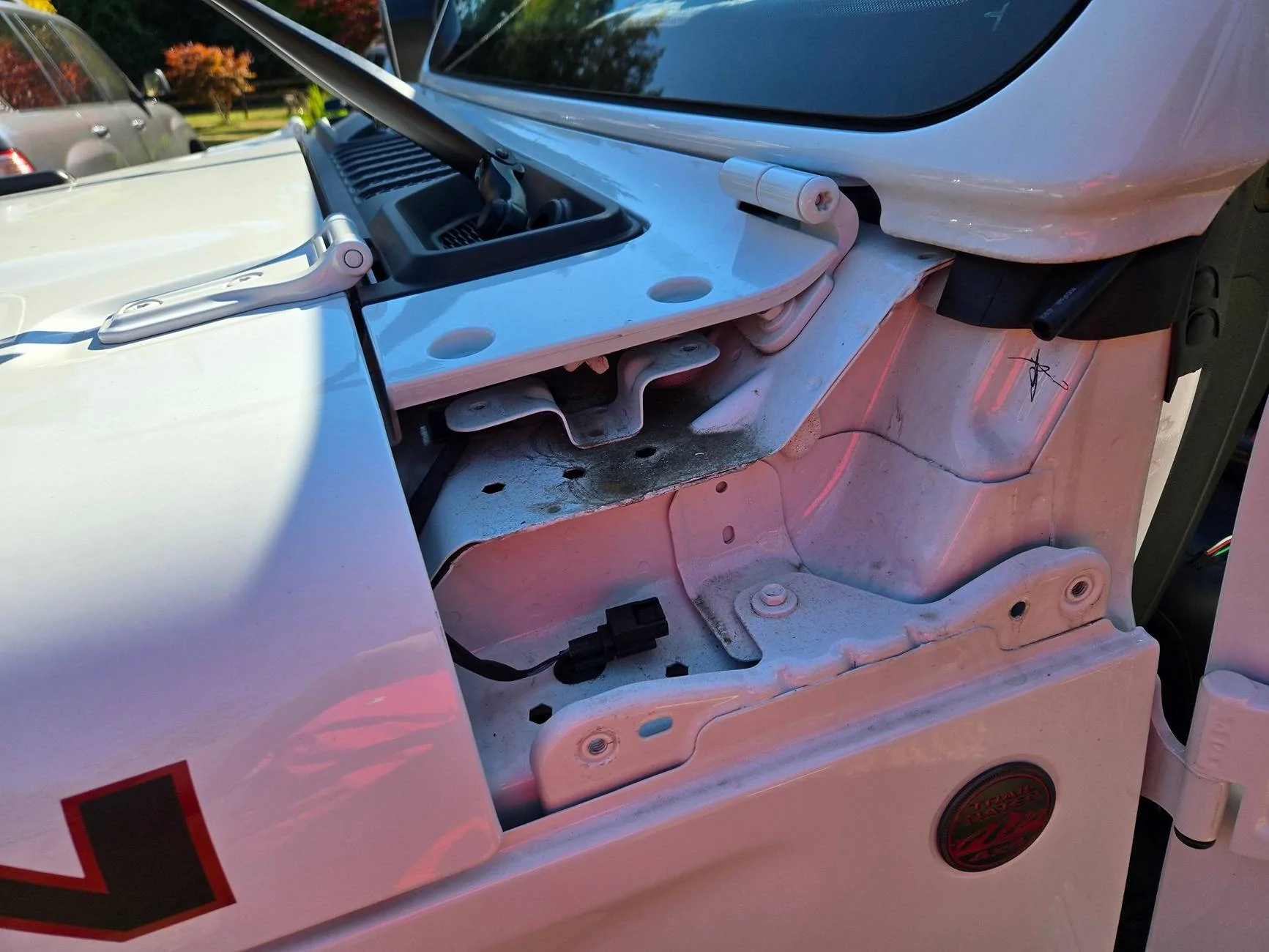

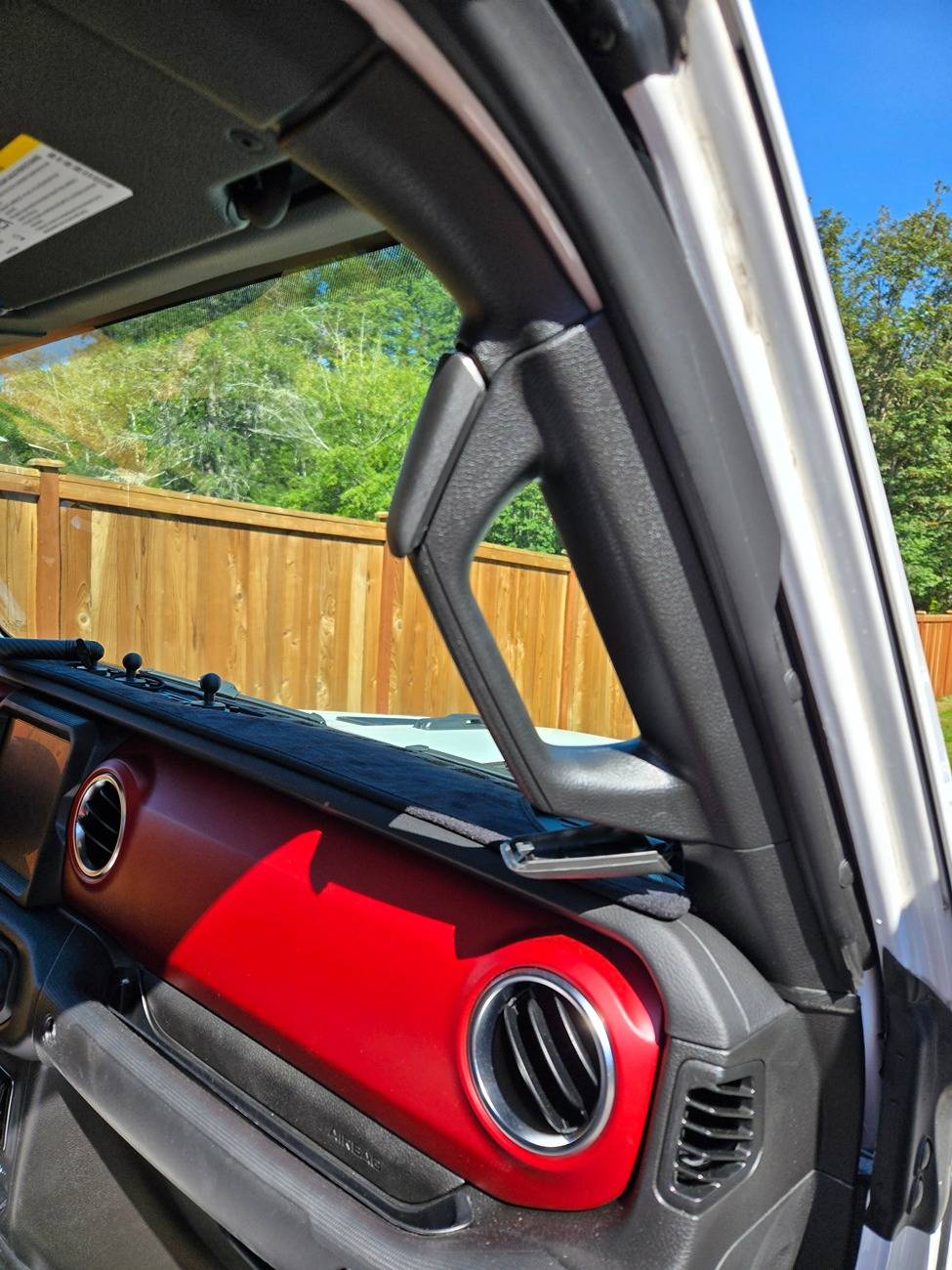

1. Remove the both front portion of the hard top.

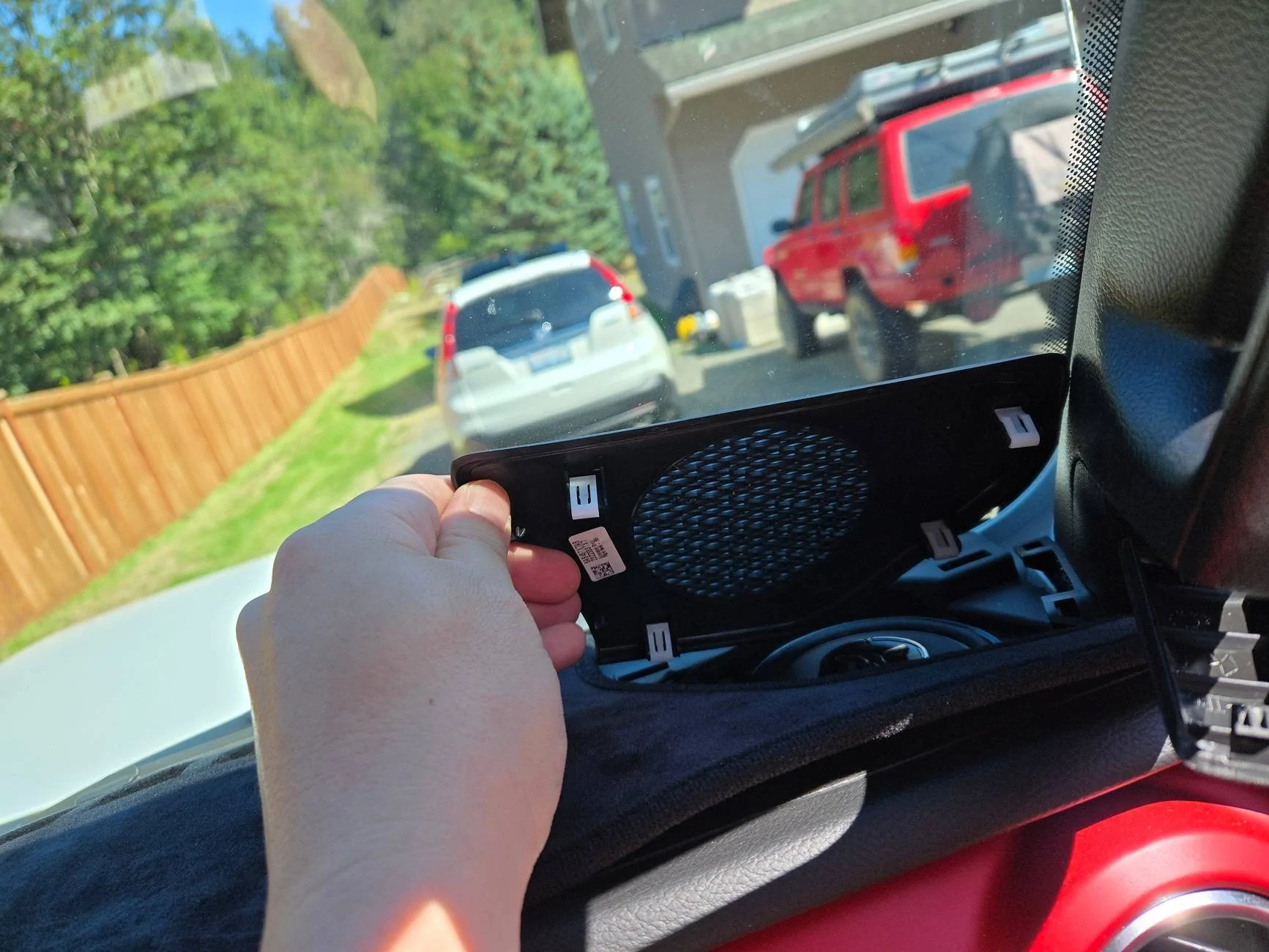

2. Remove the dash speaker grill by using plastic pry tool. Then remove the OSH (Oh Sh!t Handle) by peeling back the bolt covers and remove the bolts keeping the handle in place. Once the two bolts are removed, you can remove the handle trim by simple pulling away from where it is attached. Repeat on the other side.
Jeep Gladiator Adaptive Cruise Control (ACC) with Stop: Post-Factory Installation 1000036324
Jeep Gladiator Adaptive Cruise Control (ACC) with Stop: Post-Factory Installation 1000036323
Jeep Gladiator Adaptive Cruise Control (ACC) with Stop: Post-Factory Installation 1000036325

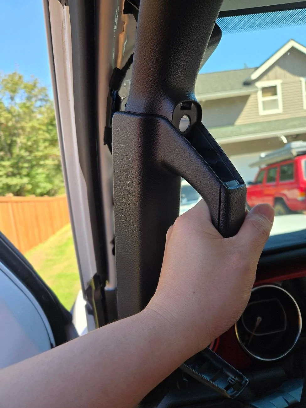

3. Remove driver and passenger side roll cage trim pieces. Each piece of the panels are held by 4 screws. 2 on top and 2 below. You can remove the trim by pulling the piece horizontally toward the middle of the vehicle after the mounting screws are removed.
Jeep Gladiator Adaptive Cruise Control (ACC) with Stop: Post-Factory Installation 1000036382
4. Remove the rearview mirror by disconnecting the power cable. Then you can rotate the entire assembly/stalk left or right 90 degrees and it will drop.
Jeep Gladiator Adaptive Cruise Control (ACC) with Stop: Post-Factory Installation 1000036334
5. Remove the top trim piece by pulling down and toward you. There is no mounting screw for this trim piece. Notice there are two connections per side. Left side has 2 connections and right has 2 connections that you will have to undo. Remember where the cables went and plugged to reduce the chance of loose cable which will result in rattle.
Take note on the visor position to have room to remove the top trim piece.
Jeep Gladiator Adaptive Cruise Control (ACC) with Stop: Post-Factory Installation 1000036337
Jeep Gladiator Adaptive Cruise Control (ACC) with Stop: Post-Factory Installation 1000036336

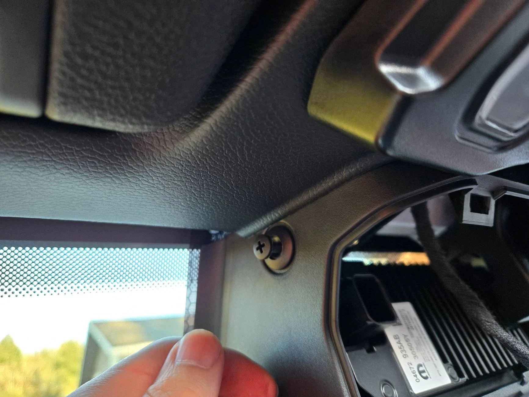

6. Remove the 4 torx screws for the windshield. You will need the Jeep Tools in your glove box for this. *Remember removal of these bolts will allow you to unfold the windshield. You push it hard enough the windshield will fold and will fold your wipers along with it. Do NOT fold you windshield. We will just tilt the windshield slightly just to route the ACC defrost cable later.

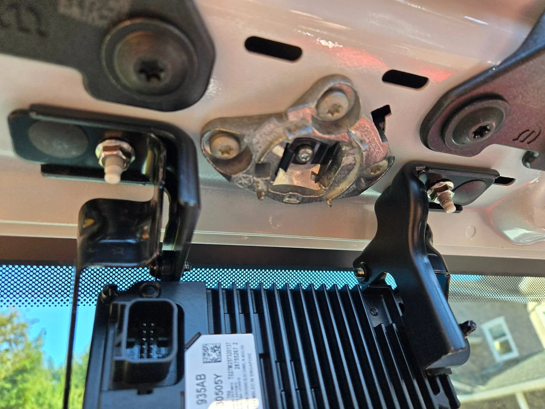

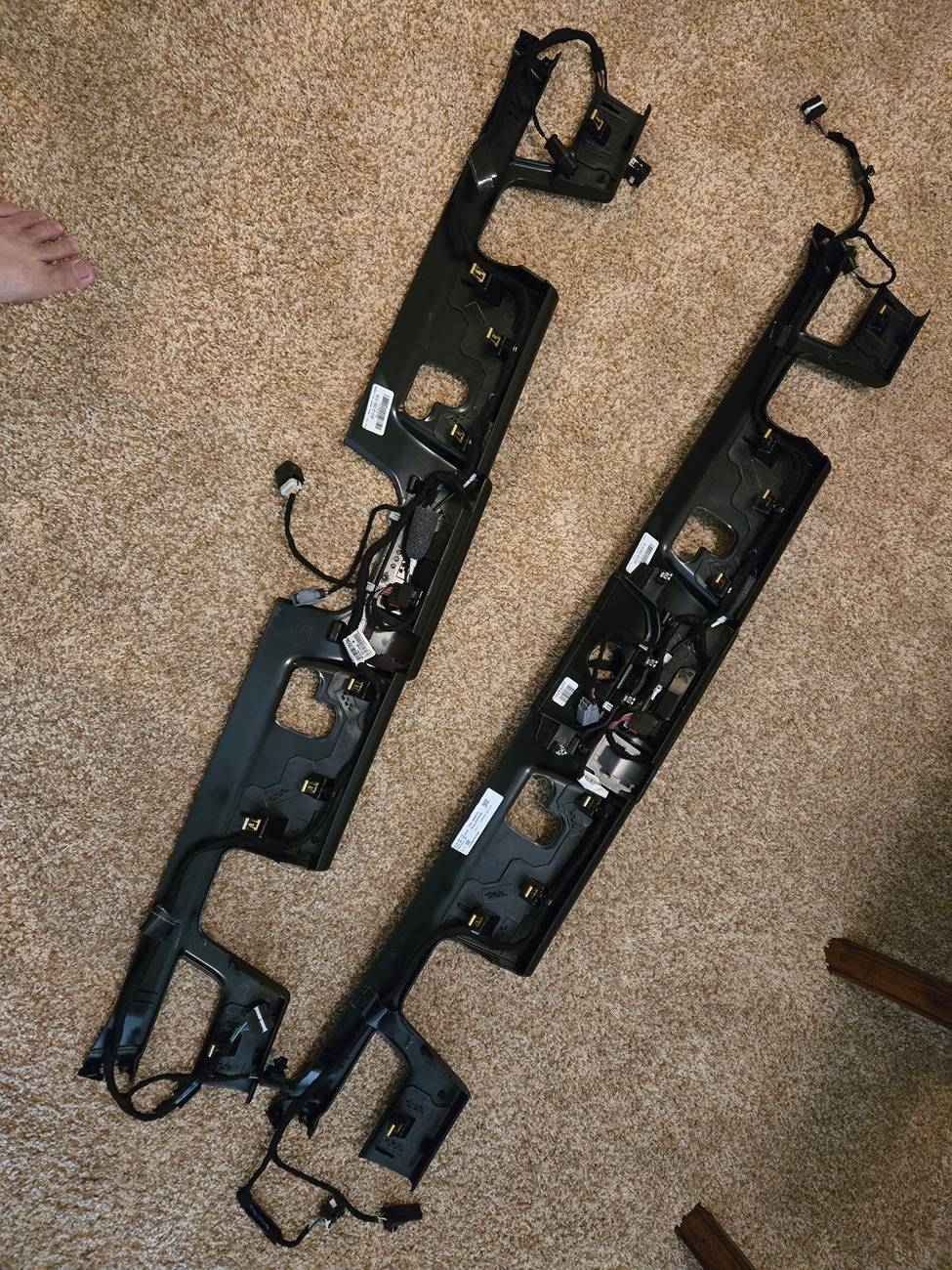

7. Transfer the ordered DASM cable to the top windshield trim. Or if you ordered the entire new assembly with SOS, assistance, and MIC preinstalled, you will use that instead.
Jeep Gladiator Adaptive Cruise Control (ACC) with Stop: Post-Factory Installation 1000036342
Take note how your original cable polarity as they are different left and right side

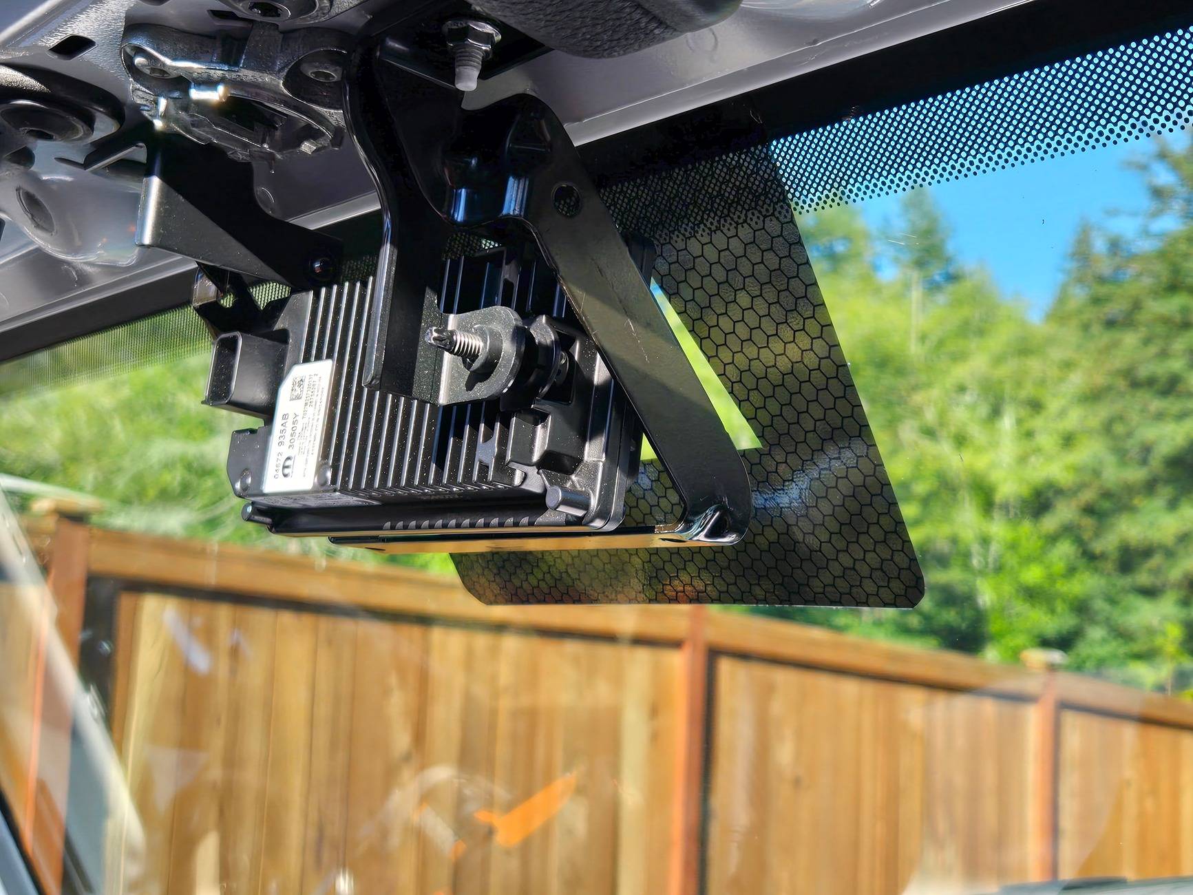

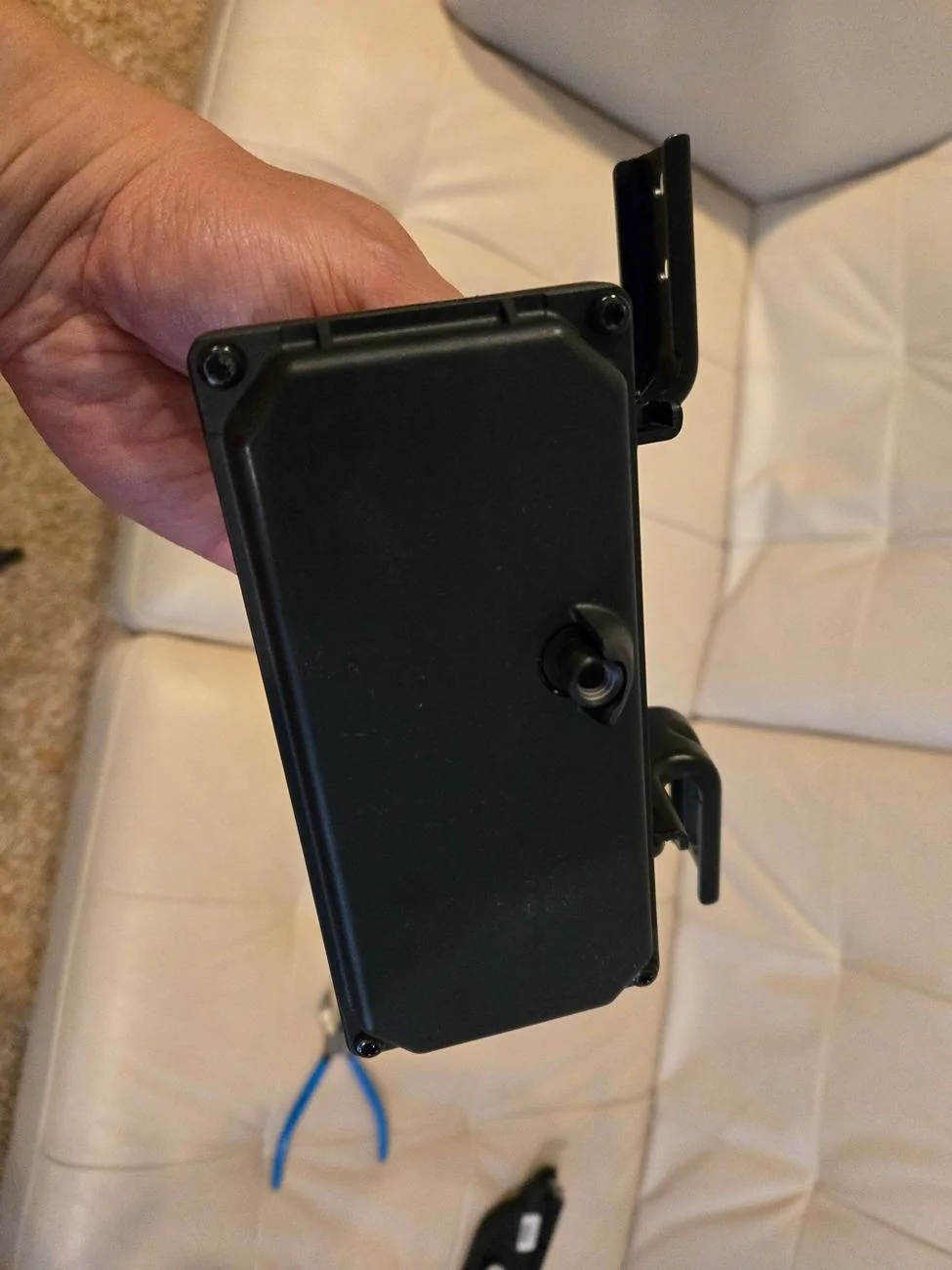

Mount the DASM in place as shown below. M6 Flange nut is used to mount the unit in place. Because the thread is painted, it feels like you are cross threading the nut initially.

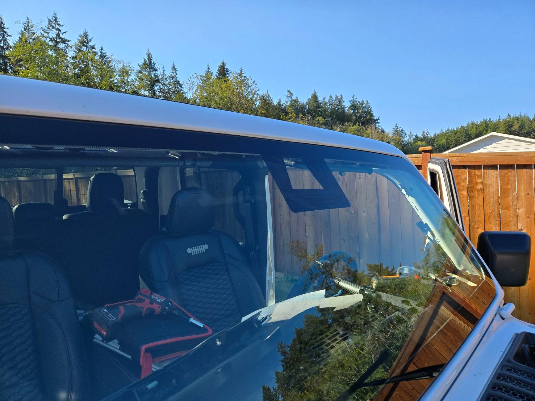

8. Optional - I have added tinting film between the windshield and the DASM to hide some of the DASM mounting hardware.
Jeep Gladiator Adaptive Cruise Control (ACC) with Stop: Post-Factory Installation 1000036362
Jeep Gladiator Adaptive Cruise Control (ACC) with Stop: Post-Factory Installation 1000036365

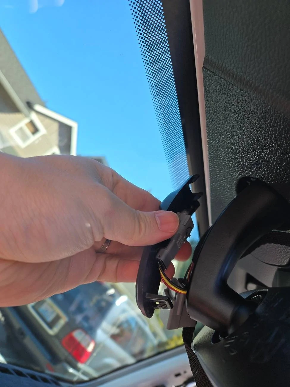

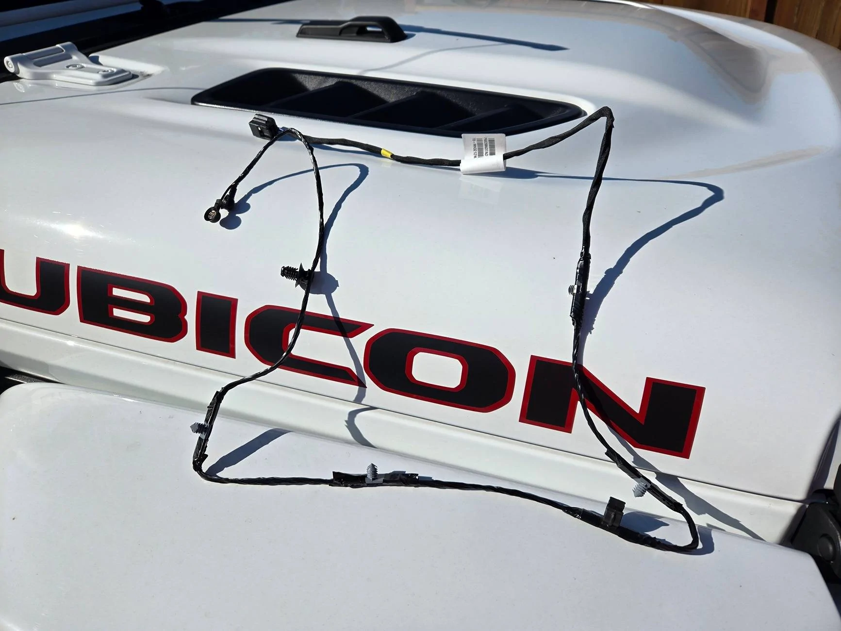

Windshield Heat Element Cable needs to be routed.
Button connectors go toward the top of the windshield. The other connector end mates to the connector in the cowl.
Jeep Gladiator Adaptive Cruise Control (ACC) with Stop: Post-Factory Installation 1000036356
Jeep Gladiator Adaptive Cruise Control (ACC) with Stop: Post-Factory Installation 1000036355
I have routed the defrost cable and zip tied it to the new ACC cable and run it down A pillar toward the cowl connector. Note where the trim piece retaining clips will locate themselves and route the cables to avoid pinching.
Jeep Gladiator Adaptive Cruise Control (ACC) with Stop: Post-Factory Installation 1000036373
Jeep Gladiator Adaptive Cruise Control (ACC) with Stop: Post-Factory Installation 1000036375

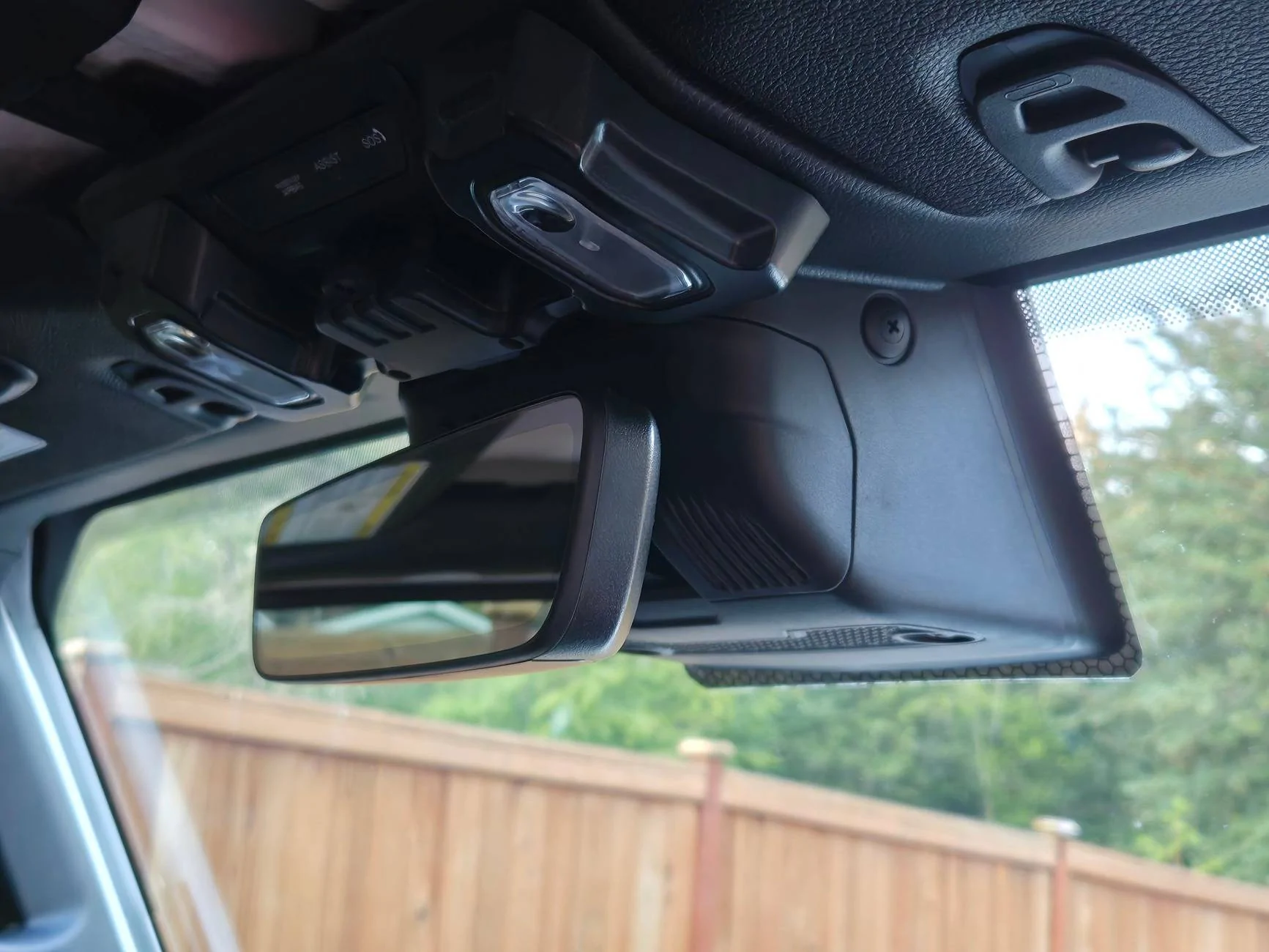

9. Install the rearview mirror. Now with the DASM in its place it takes a little trick to rotate the assembly back in. Position the rearview mirror kind of 11 and 5 o'clock position with stalk at 12 o'clock position. With this configuration, you get enough space to rotate the mirror into its mounting position. Reconnect all the connectors on both sides of the windshield.
Jeep Gladiator Adaptive Cruise Control (ACC) with Stop: Post-Factory Installation 1000036390
10. Reinstall all the trim pieces. Roll bar trims then the OSH then the speaker grill.

[ABS Module]
Installation

The credit for the following information goes to @Jimmy07 for the AlfaOBD vehicle configuration shown below.
VehConfig 2: Cruise Control Present- NO
VehConfig 7: Full Speed Range Forward Collision Warning Plus System- YES
VehConfig 7: Type of adaptive Cruise Control (ACC) system present- ACC WITH STOP (auto trans only)/ ACC (manual trans only)
CustSetMenu 1: Forward Collision Warning CSM Present- Feature 2 - 3 Option
CustSetMenu 2: Forward Collision Warning Single Setting (Warning and Brake) CSM Present- YES
P/T Chassis Net: ACC/DASM Adaptive Cruise Control/Driver Assistance Module- ENABLED
Make sure that you do not enable this setting:
P/T Chassis Net: ACC Adaptive Cruise Control- NOT ENABLED
Any other settings that you see that mention ACC or forward collision warning do not get enabled.

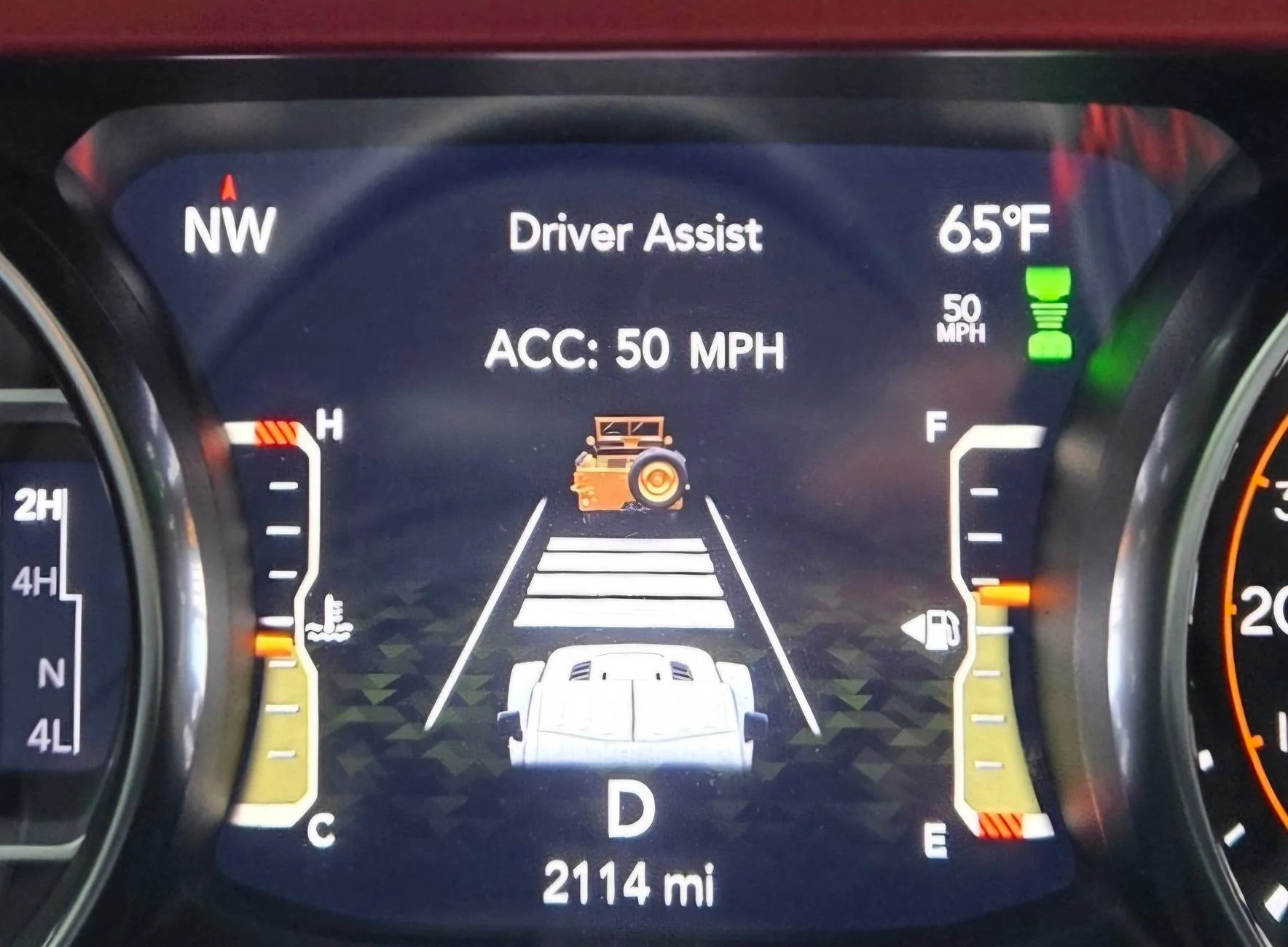

I am justifying it for added safety that it may even save my life. With ACC, you get Forward Collision Warning and it will brake for you if it thinks you are about to hit something. It did that for me yesterday and I was very impressed. It is like a second set of eyes that is looking out for you all the time.
ACC can be activated starting at around 20mph. Slow (not stopped) bumper to bumper traffic, it is amazing. Single lane road with a car in front, you are just steering with no brake or accelerator input.

ACC can be activated at very low speeds. I use it in heavy traffic all the time. It will Cancel if the car in front stops long enough, but all you have to do is hit Resume when it starts moving again.
There are several little towns I travel through with 20 and 25 mph speed limits. When getting close to these areas, I find a vehicle following the speed limit and get in behind them. I let the ACC use them to control my speed. I don't have to touch the gas, brake, or any buttons. After we're through the area, I turn on the blinker, move over, and ACC accelerates back to my set speed.

Jeep uses DASM (Driver Assistant System Module, check SP) which is mounted above the rearview mirror. This determines the distance to object ahead of the vehicle. This also talks to ABS and PCM to maintain acceleration and deceleration.
While these are the components that make the ACC possible, but the calibration using certain software and hardware do take some effort to make these hardware work.
Software

Forward Facing Camera, Driver Assistance System Module, DASM - 04672935AB
ABS control unit that is ACC capable - 68461636AA
ABS system module that is ACC capable - 68621091AA
New overhead wiring harness (without trim, SOS switch, microphone) - 68357530AD
Overhead trim piece AND wiring harness - 7JY99TX7AB
ACC Protective Cover - 56029828AA
Sensor Cover - 6QD20TX7AA

Wiring Harness for Heating Element "Antenna wiring harness" - 68398637AD

ABS
[AlfaOBD]
ABS VIN Reset

Do you know by any chance if it possible to make to ACC working even under 30MPH ? Can the Tazer mini do that?
Also i would love to let in on permanent (i don’t want to turn it on each time i turn on my JT) any solution?
