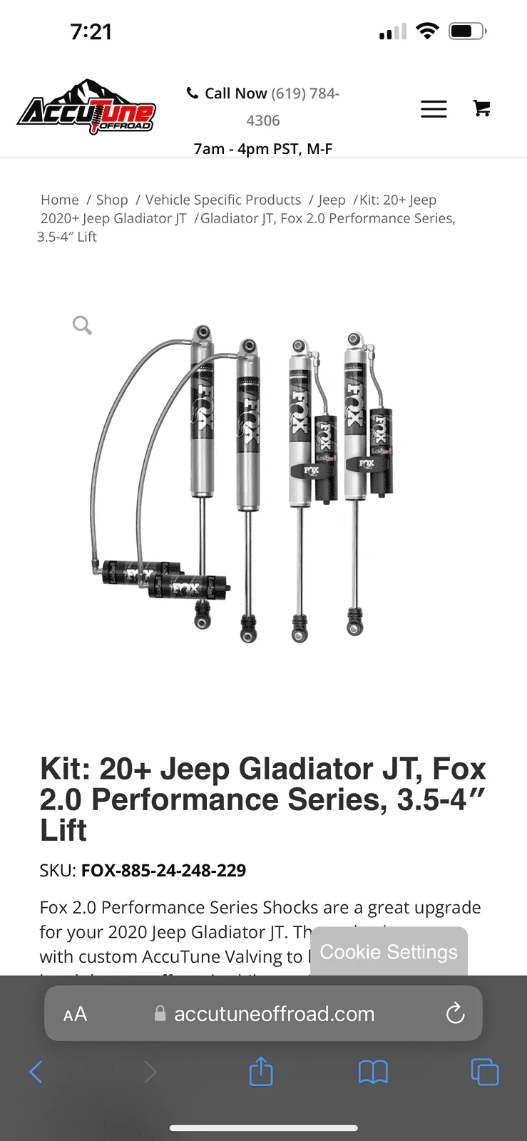

If you’re feeling Foxy, try these. Tell Accutune your usage and let em tune them to your usage. Like others mentioned, $2k is a tough number…prices jump from like $1,200 to $2,900 from tier to tier.
This being said, I’d probably go Falcon 3.3 at the $2k price point. If Falcon was out of the picture, I’d keep saving for something in the $3k range or go with regular Fox 2.0s (or the ones below if you’re worried about heat).
I’m just spitballin ideas at you.
Edit: I misread someone else’s distaste for Falcon as yours. Nvm on not considering Falcon.
https://accutuneoffroad.com/product/kit-20-jeep-gladiator-jt-fox-2-0-performance-series-3-5-4-lift/
