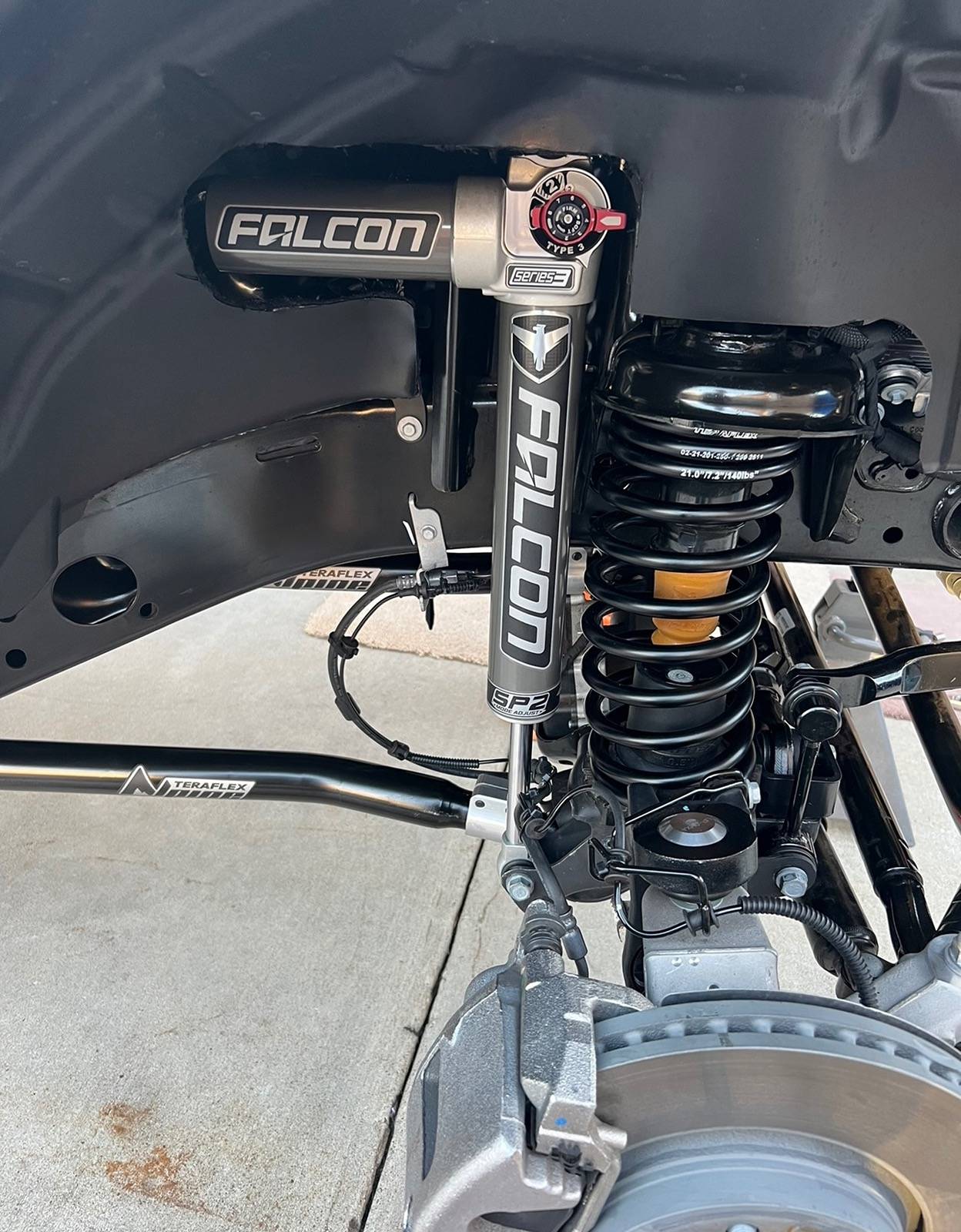

I have been happy with my Falcons that I have even swapped them forward over my last three Gladiators. Currently at around 75K miles on them total. Like everything else, they have inflation jacked the prices on them and I may shop elsewhere when the time comes to replace them.
Agree completely. I have nothing but good things to say about my Falcons. Stiffer on road than factory which is fine because the factory overland eco suspension bottomed out quite often. Once they’re off road they really shine. Next week I’ll be buying another set for my wife’s 24 JLU as well.

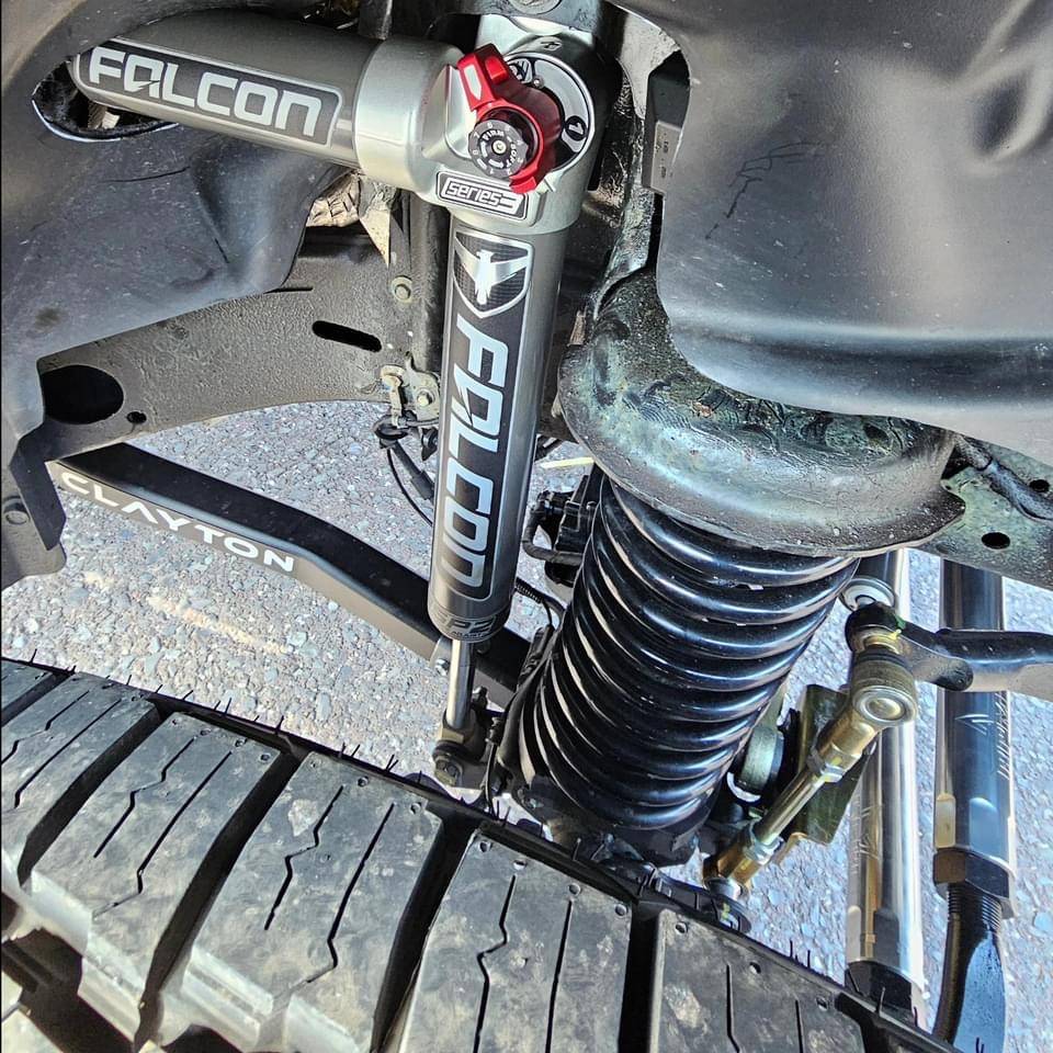

Went from Fox to the Falcon 3.3 and can not say enough good about them. The Falcons are flat out amazing..

Are we talking factory "fox" Rubicon junk shocks or a quality fox reservoir shock? Comparing $2k aftermarket shocks to stockers or even $700 fox 2.0 ifps is not exactly apples to apples. Personally if I'm taking the jump into high end aftermarket shocks I'd save another $800 and go for the fox 2.5 elites on a rig as heavy as the gladiator. Coming from the mojave and how it drives under aggressive high speeds in the desert I couldn't see going with anything smaller aftermarket personally. Not saying the falcons aren't good, but $2k is real close to $2800 and they just can't be that good at only 2.25".
I wasn’t putting Fox down and they were the 2.0 version. Just sharing my observation and personal experience. The Falcons are amazing and the adjustability is awesome. to say they are a huge improvement over the Fox’s is an understatement. I would recommend saving the money for the best you can buy instead of buying them 2x and wasting even more money. Which is what I ended up doing…
