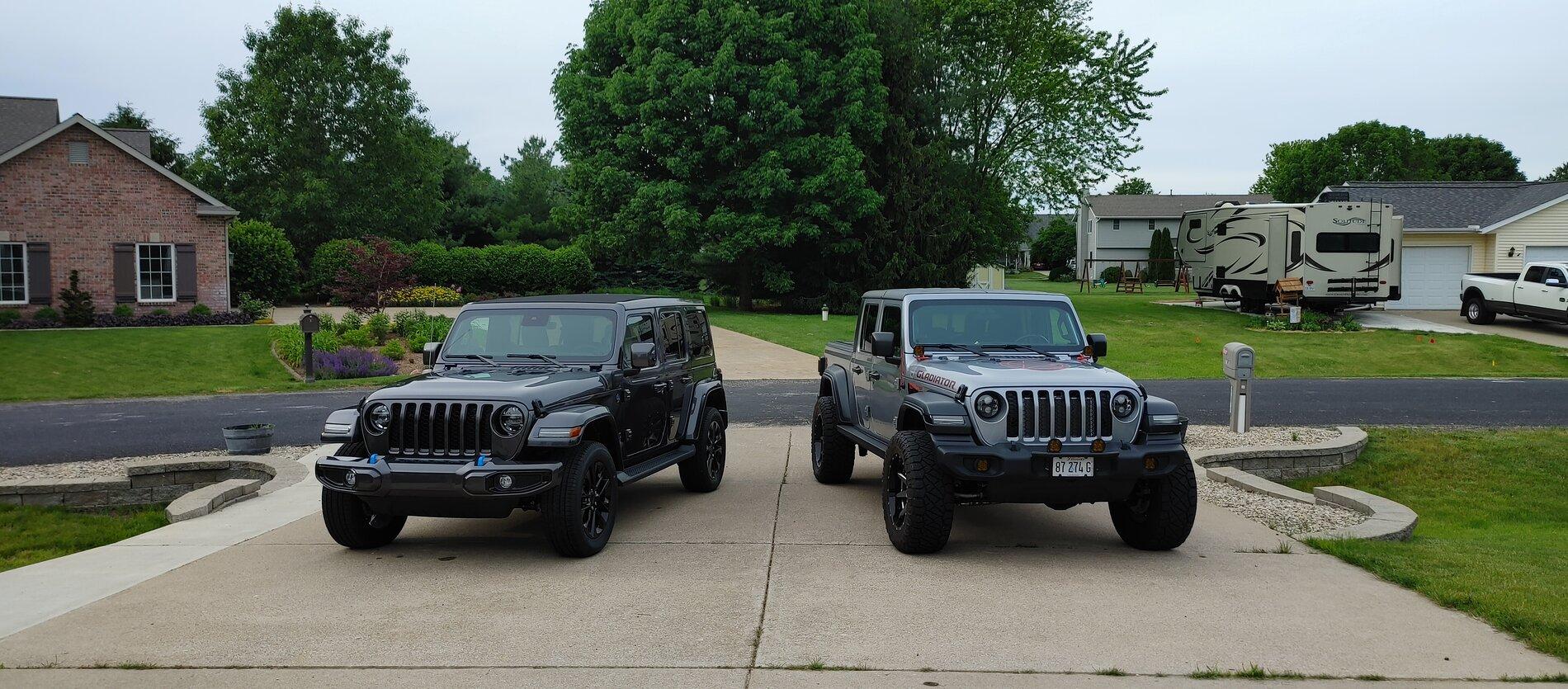

I am a wrangler 4xe guy. Never seen it get over 190 even on a 100 degree day. But never towed or done anything to heavy duty with it.
Jeep Gladiator Since no news on 4xe Gladiator this week, when is next likely update? 0530211759_HDR
