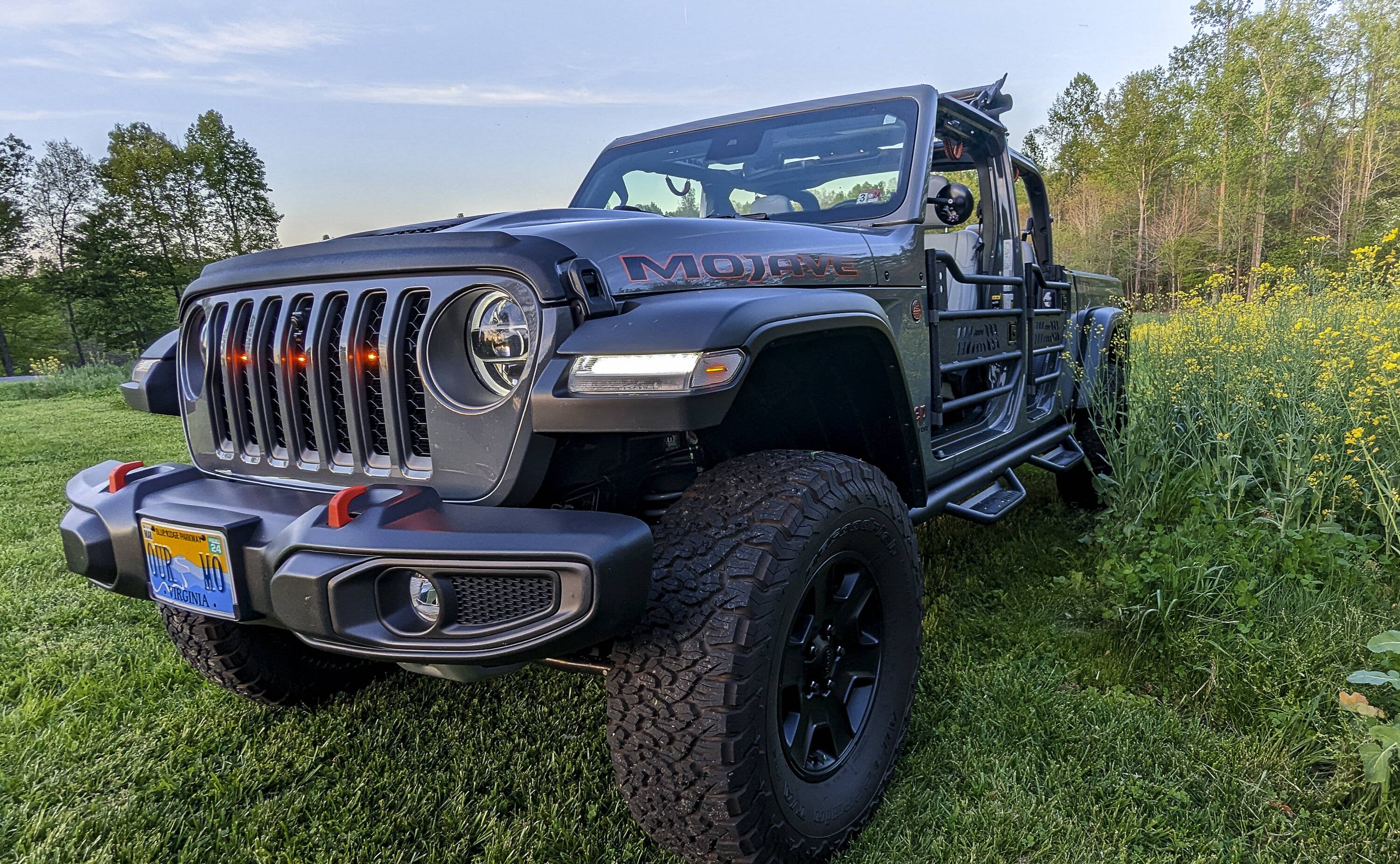

Is your truck really 82" wide? It doesn't look all that wide in your photos. I believe 80" is the cutoff for needing clearance lights. Makes me want to measure mine now to see where I stand. I'd be inclined to throw the stock tire set up on and go get the ticket signed off because you don't need clearance lights. I've been ticketed here in CA for mud flaps in my old xj on a dry day just because the motorcycle cop once got hit by a rock flung to by a lifted truck.

The height of the tires isn't contributing to the laws broken, it's the overall width of the vehicle which includes the wheels/tire setup that may be different wheel offset and wider tire than what came from the factory. Once you get to a certain width additional lights are required to let other drivers know.
This is why the Ram TRX, F150 Raptor, Bronco Raptor etc all have the additional 3 front and rear marker lights, and their base versions do not.
Federal Motor Vehicle Safety Standard Number 108, (aka Title 49, Subtitle B, Chapter Five, Section 571.108 of the Code of Federal Regulations) lays out the legal details around vehicle lighting. Among the statutes you'll find this gem describing how the identification lamps should be placed on any vehicle 80 inches or wider: "On the front and rear—3 lamps, amber in front, red in rear, as close as practicable to the top of the vehicle, at the same height, and as close as practicable to the vertical centerline, with lamp centers spaced not less than 6 inches or more than 12 inches apart. Alternatively, the front lamps may be located as close as practicable to the top of the cab."
with the white wheels on 37s it is. my stocks its not.
