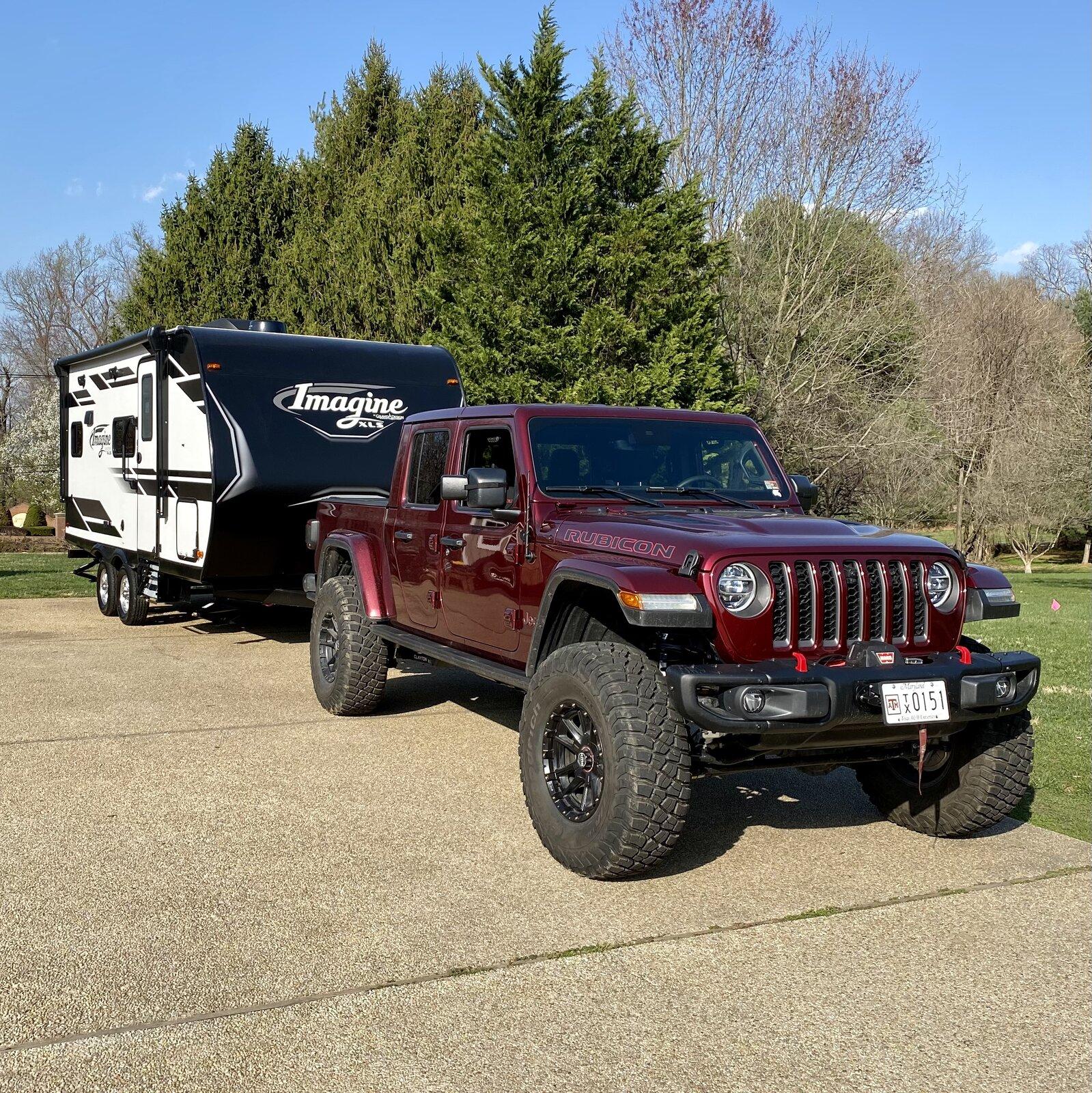

2020 Springdale 1800BH Rugged Terrain. Just took it on a 3400 mile round trip from Missouri To Utah and back! Handled the mountains of Colorado very well. Only bad part was the 30 mph head wind through KS where I got about 7 MPG... OOF. Other than that we averaged 11 MPG for the trip. Gladiator is on 37s and regeared to 5.13s.
I’m pulling a 17MKE that looks similarly sized, probably 5100 lbs loaded with my JTR on 37’s as well and spend way too much time at or above 5000 RPM in 4th gear trying (& failing) to maintain 65 mph on the rolling hills in VA, PA, and MD, so I’m ready to regear but struggling to decide between 4.88’s and 5.13’s. Do you mind sharing what led you to go deeper with the 5.13’s and what your experience has been when towing?
We use the JTR to tow our trailer to the off-road parks, so off-road performance is an important factor for us. Probably 50% of the mileage on the vehicle is just traveling to the next camp site as I work from home when not traveling. Thanks for anything you (or others) can share to help us decide which gearing makes the most sense!

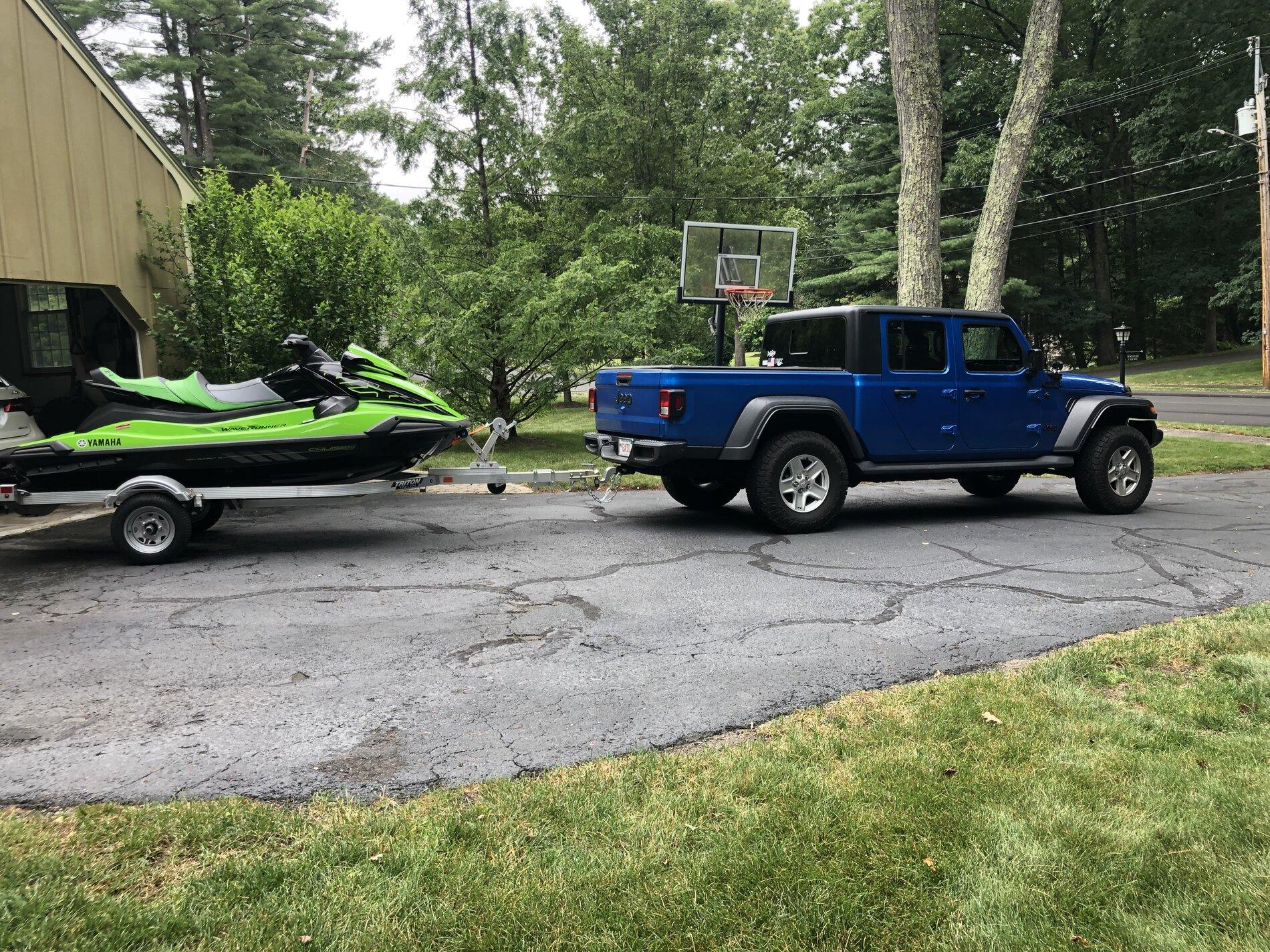

Mac
Nov 30, 2017
2,177
2,374
MA
2020 JT Hydro Blue Max Tow
Towed my Waverunner up to Maine, didn’t really know it was there.

xpcdoojk
JC
Sep 11, 2019
212
133
Missouri
Mercedes SLK300 MINI Cooper S Volvo XC40
Well it is Waverunner.... kind of like a small lawnmower, I would hope to heck it was not an issue.:LOL:
