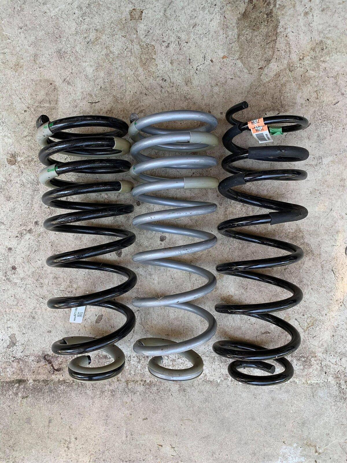

Should have the answer to this question very soon. We have a 20 Sport non Max Tow, but purchased a set of Rubicon and Mojave springs locally to see which might be the better option. Already put the Rubicon Fox shocks on. Thinking of snagging the longer Mopar lower control arms too, but for now... want to see which springs provide the better lift. Also happen to have a set of rear springs from our 19 Ram 2wd Laramie to try out. If the rear suspension setup really is comprised of parts from the Ram, could be interesting to see if they fit. (orange sticker is from the Ram)

I'm color blind, so I think the one on the right is the ram?? Is that right??
Either way, it is going to require a different perch. Look at how the spring coil is not run flush into the lower coil. Like the two on the left.
