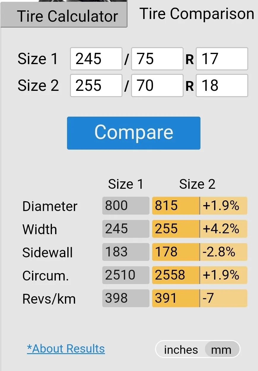

My guess is it's a money savings thing. But ya, kinda weird so to speak.
Not really much difference between the two. Nothing a few pounds of air pressure couldn't even out. Not to mention tread wear.
For comparison...
Jeep Gladiator Spare tire trickery!! Screenshot_20240317_091047_Samsung Internet

Rudejeepin, nice chart! I really don’t care hope not have to use I? It’s the point of it! Jeep maybe should be called cheap! After 28 of then I should not be surprised at anything to save a buck!! LOL NOT SO MUCH!
