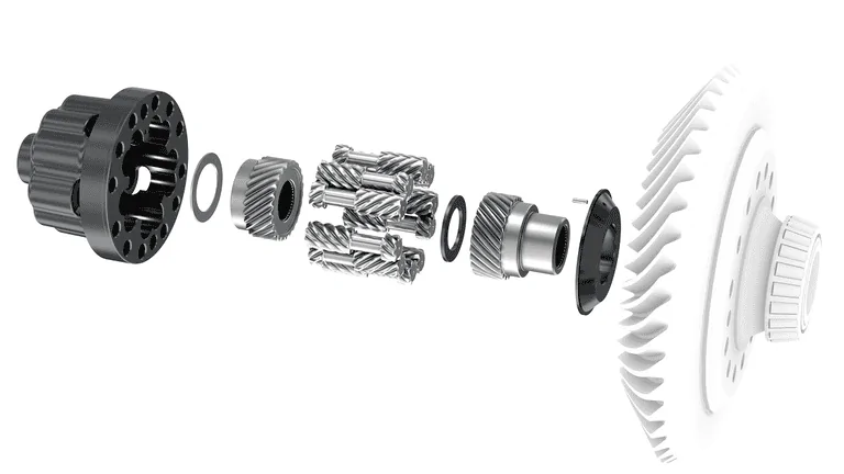

Trac-Lok 100% still has clutches. If they had torsen (Truetrac) it would be a different story. Truetrac is a helical gear style LSD, they never wear out and should be the only kind of LSD used IMO. Trac-lok is a clutch style LSD, the clutches WILL wear out, just a matter of when depending on use. If they are babied and the gear oil is changed regularly they may last 100k miles. If used off-road regularly and abused you’ll be lucky to get 30k out of it before a rebuild is necessary.
2021 MY has the new version.
Jeep Gladiator Sport S vs Rubicon trailerbodybuilders_11680_spicer_traclok_lo
If only the aftermarket would have these available. I check the tranny/gear thread almost every day hoping something has come out for a LSD.
