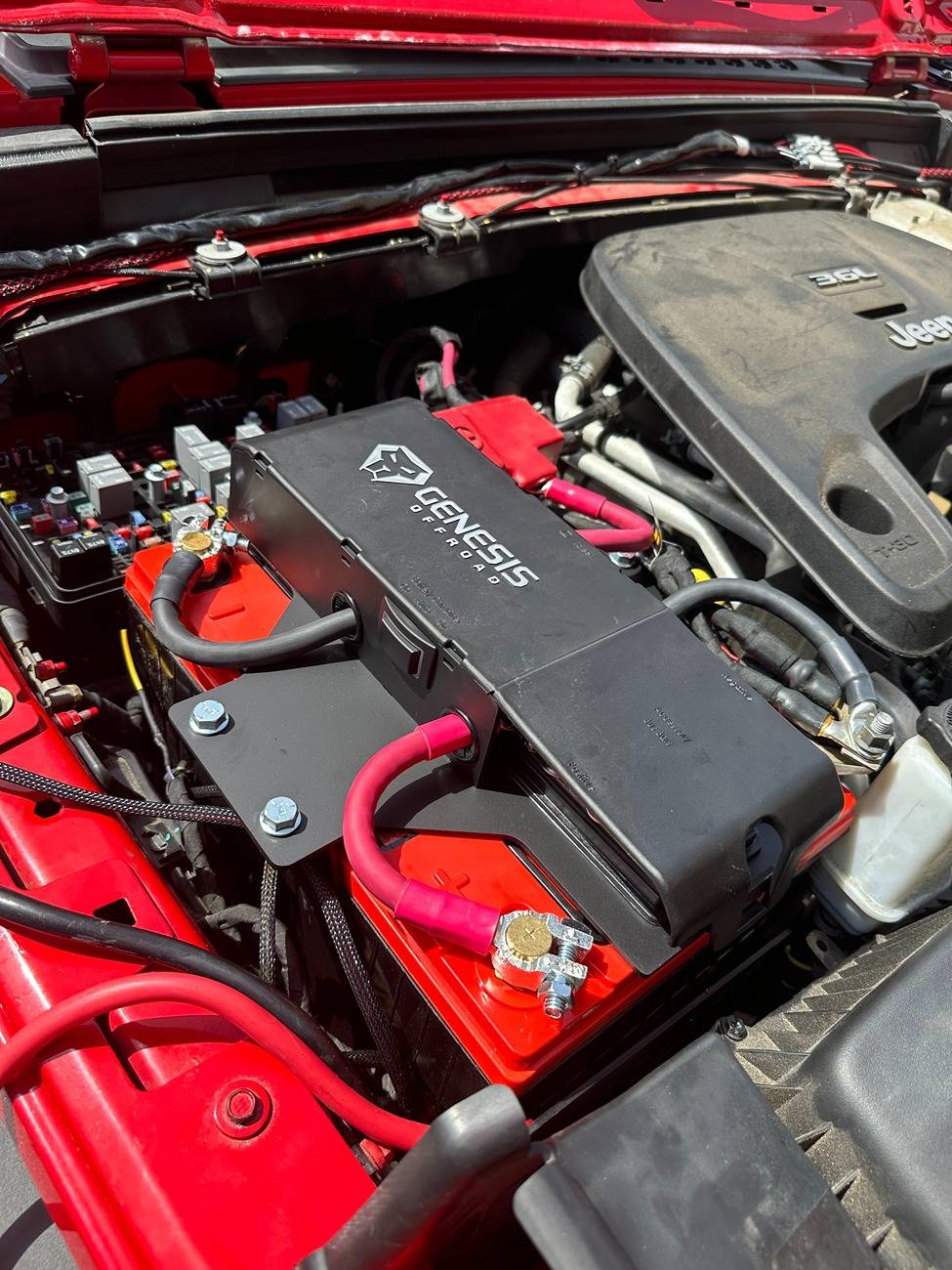

Wow so you mounted two full sized premium batteries, I would imagine wired up like the originals, just matching sized instead of one motorcycle sized?
Pretty much, it's not cheap but well worth it in my opinion. It also provides posts for hooking up lights, controllers, compressors, and more.
Videos instructions for installing are online. It takes a little while to get it setup.
Kit link (batteries are sold separately)
https://www.genesisoffroad.com/prod...VA2ONMElyOw_X-CeXRYyt92Y_9Jn_S9lL8Nc2e-cXFZxz
Yes expensive but $$$ well spent. That’s a great way to feed all types of electric, accessories like lights and winch.
