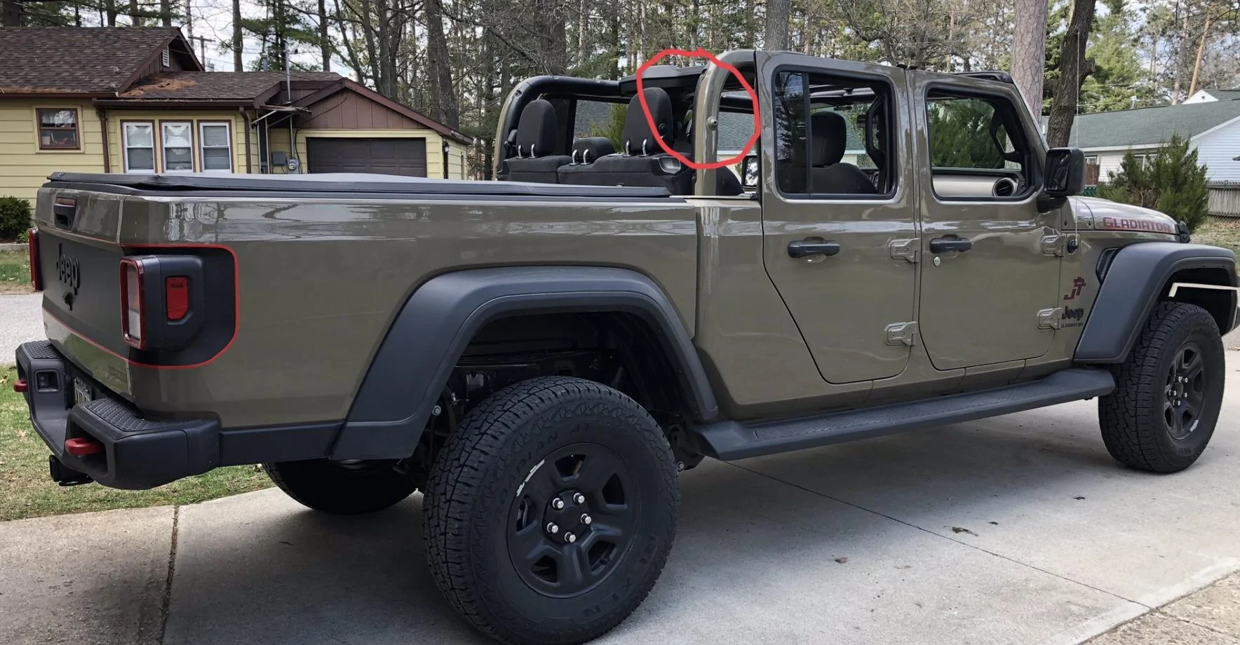

I’m going to relocate my stubby to the bolt location for the soft top with a homemade mount. I’ll test it in both locations top on/top off and see how it does. I have a hardtop and it will fit underneath when top is on.
Jeep Gladiator Stubby Antenna Install - Testing the loss of gain in the radio 20211008_105504_HDR[1]
Do you ever get this done? Wondering what the results were...

Nope. Ran into a supply problem for the connectors and wire I needed. I did find you can run wire through the top bar to the back instead of the floor. I’ll get it done as soon as clips are available.

Maybe you can locate what I need for this location project?
