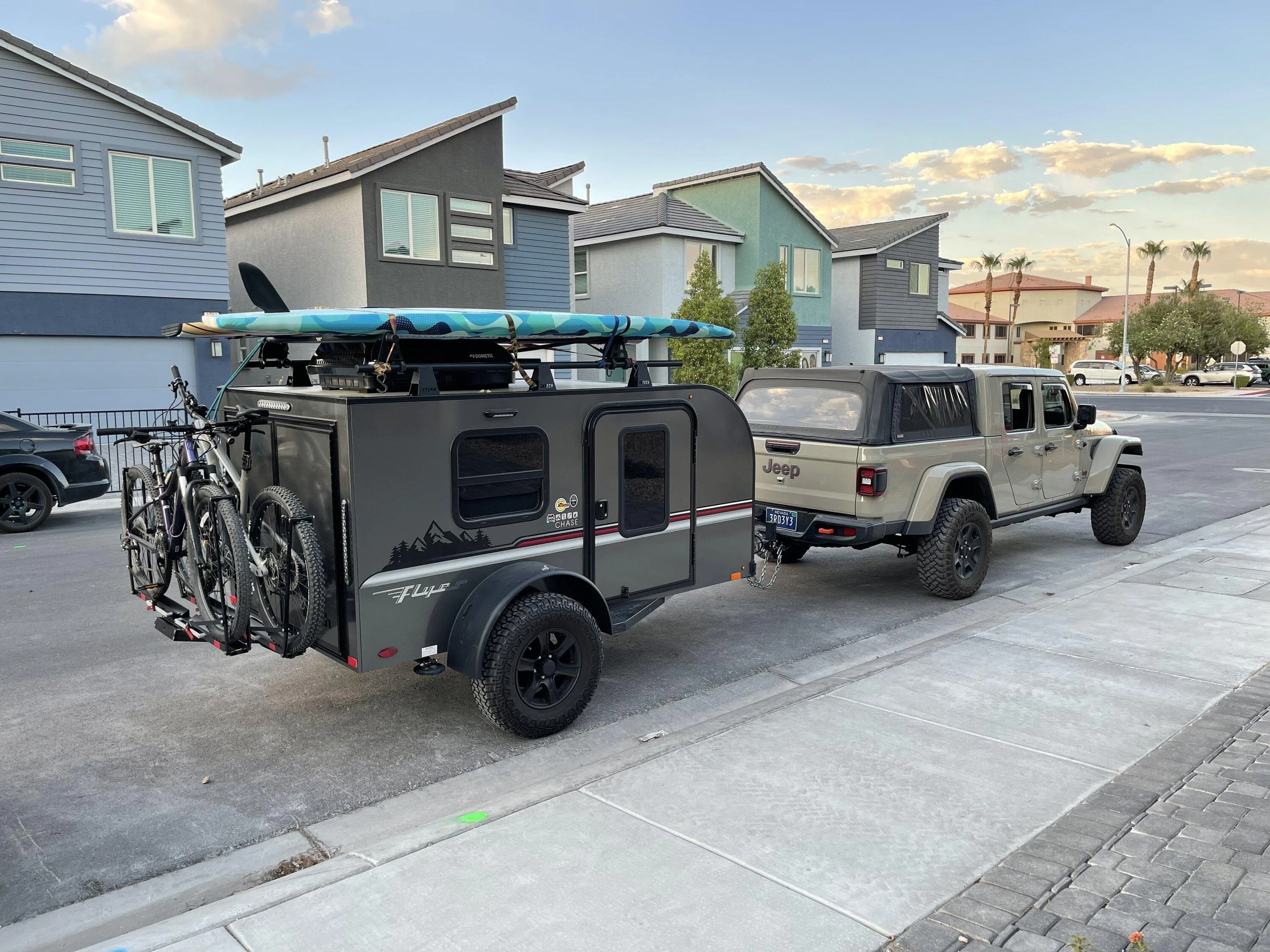

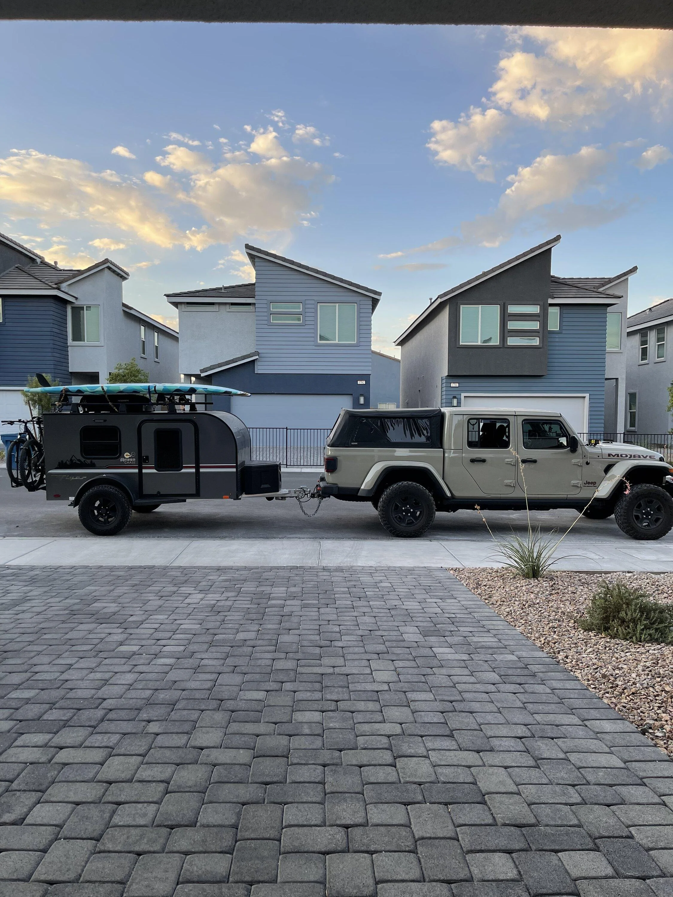

Which Timbrens do you have? The SES or the off-road bumps? I need them for the rear sag when towing my lil camper trailer. Pretty sure I need the SES.
I have the off-road bumps but yeah if you're going to use them for load control I'd get the SES.
Thanks I think so also. I’ll probably pull them off and put the stocks or buy the Timbren off-road bumps for when I’m not towing this thing.

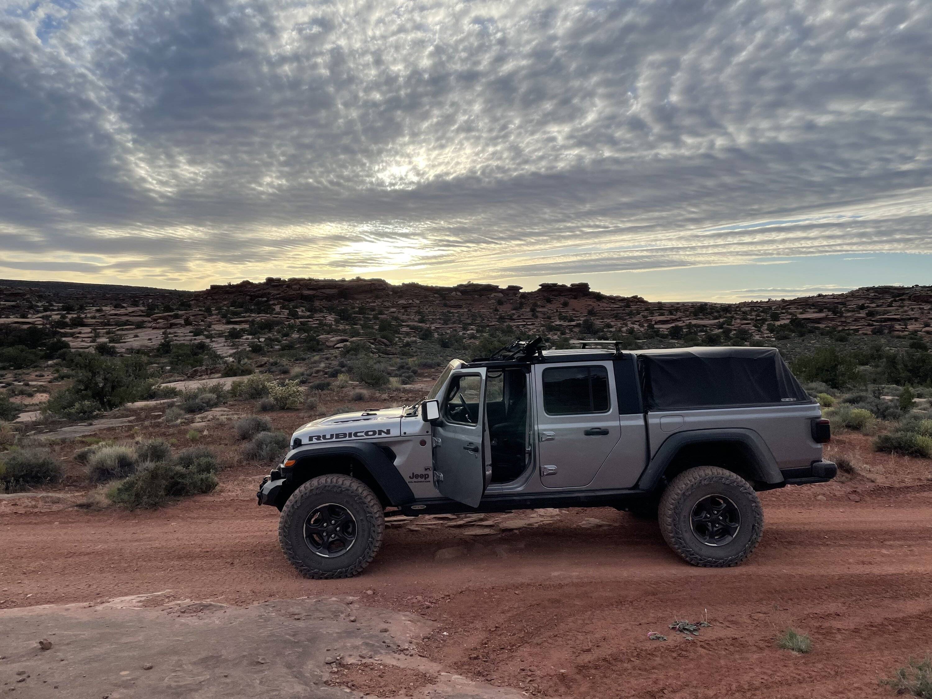

How much rake are we talking? Do you have any pictures?
I’ll try to dig something up. But I estimate close to two inches.
This is off road, as most of my pictures are, but shows the rake pretty well.
