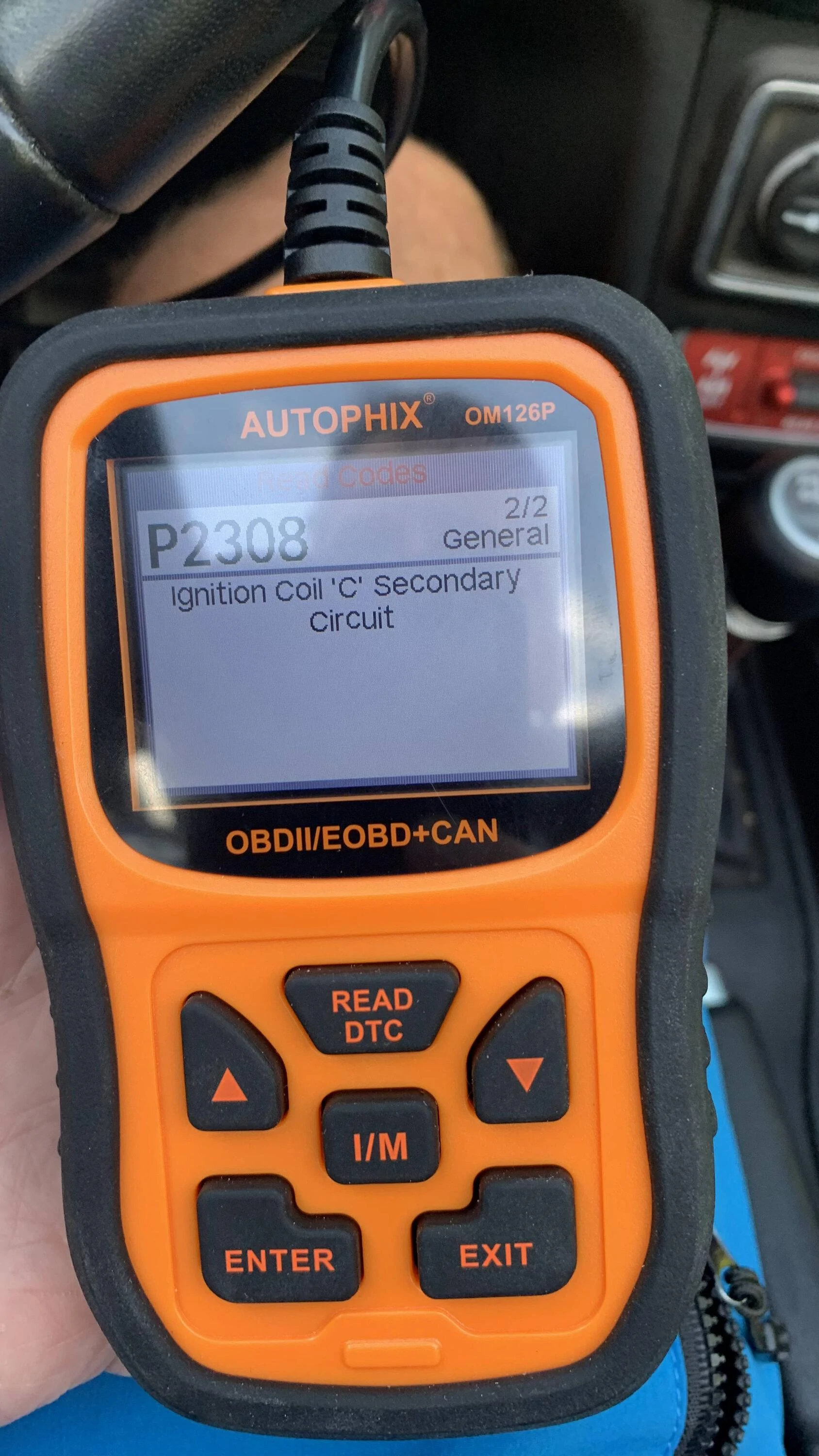

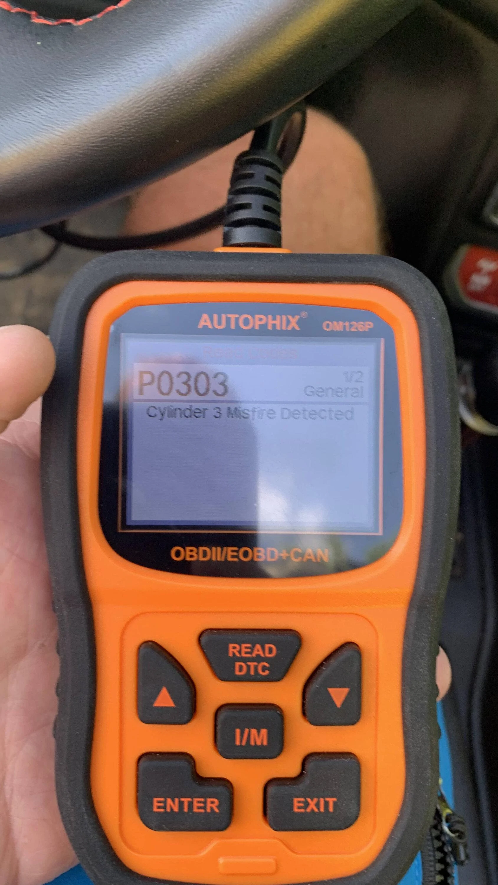

Build date: 10/2019 Rubicon, 6MT, stock.
Mileage when it first occurred: 23,500
How many times has it occurred: This was the 3rd time. 1st time @ ~12,000 miles; 2nd time @ 19,500 miles.
What exact codes did it throw: Had my OBD reader in the console, pulled it out and plugged it in while engine was still running and check engine light was flashing. 2 codes: P0303, Cylinder 3 misfire and P2308, Ignition Coil 'C' Secondary Circuit.
Is the issue on going? Unknown
If so, what has been done to try to solve the issue? Nothing yet other than to check/seat all relays/fuses in fuse block.
Was the issue ever fully resolved? Unknown
Description of misfire: Driving along a SE Alabama 2-lane highway (minor hills to level) at approximately 55 mph, 5th gear, with cruise control set. Outside air temp ~80F, oil temp ~190F, coolant temp ~194F, voltage ~14.3, all of which are normal readings for my vehicle. Cruise control deactivated, ASS light illuminated, and a notable misfire was noticed as soon as I gave it throttle to maintain speed. 3-5 seconds after noticing the misfire, the yellow check engine light began flashing. Maintained 55 mph in 5th gear with a continuous misfire (felt like loss of a single cylinder as the vibration was a constant frequency). Pulled out my OBD reader and plugged it in and read codes (while maintaining 55 mph). After approximately 2 minutes, with vehicle still misfiring and check engine light flashing, pulled off road and shut down vehicle. Restarted vehicle and everything was normal. Both previous instances were identical except I kept driving and the misfire stopped after 2-3 minutes, check engine light stopped flashing and check engine light remained off.
