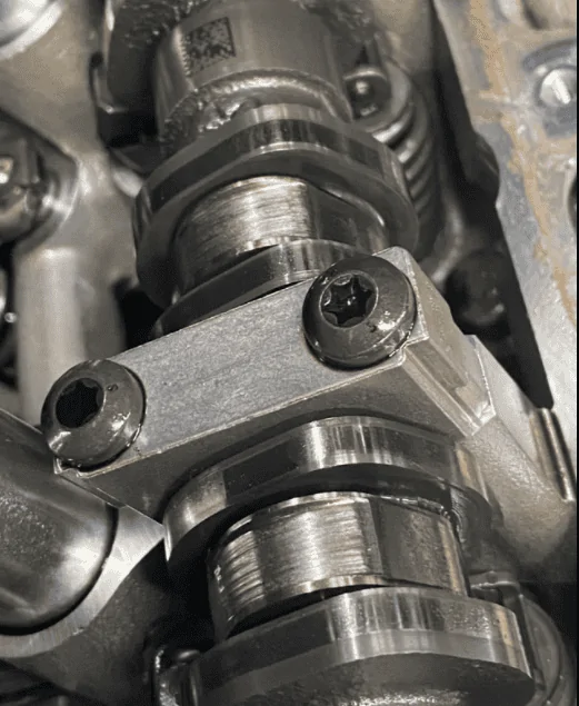

Yes. They weren't aware of that TSB until I brought it to their attention. They inspected and compared the new and old cams and could not see any visible difference. Their conclusion was it's probably a tone ring issue.

Hope they got it - but it makes me wonder - did they mic it for the profile or just look for appearance?

It was just visual observation, he said there was no visible wear of the lobes. Inconsistent readings from the tone ring seems to match my symptoms.

Most of the time you can tell, especially if there's no galling, etc. and there is the area on either side of each lobe that doesn't get wear they can always compare to on these so it makes sense.

Well, things went downhill a few days after I got it back with misc misfires on all cylinders and a uneven idle. Back to the dealer and after a few more cam related parts replacements it looks like the problem was a defective Cam Phaser Actuator. Fingers crossed.

How was the cam (or were the cams) themselves? Wear?
Lifters ok and correct parts?

There were no visible issues with any parts until they got to the Cam Phaser Actuator and noticed that the plunger was sticking. I'm still live monitoring the misfires with Jscan and it looks pretty good after a few short trips.

Got my Gladiator back from dealer this afternoon. Camshaft replaced, no visible damage, scoring, etc. No other parts replaced per the RO.
Maybe it’s my imagination but the idle seems smoother during my ride home. Fingers crossed ?
Under the hood all seems to be back in place so let’s see what happens over the next few thousand miles and I’ll update the forum.
Mine is definitely smoother after the camshaft replacement and the followup repair. Silky smooth idle now, barely hear or feel it.
