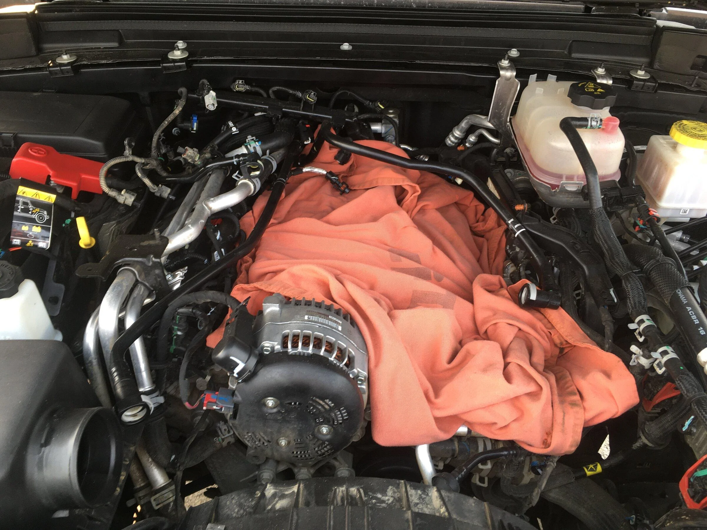

Drove around town today. A lot of stop and go and about 50 miles. These are the conditions that usually set off the CEL in the past. I can now say for certain the idle is much smoother than before the cam was replaced.
I’m guessing the cam was just enough out of spec to set off the CEL on occasion. Certainly JEEP wouldn’t have issued the bulletin and pay for the cam replacement unless it was required.
Somewhere, someone at Jeep knows what the problem was - serial numbers, production dates or something. In any case, fingers crossed to see what happens but I’m pretty convinced it’s fixed.

Another day and no CEL. Idles like silk now. What a difference. Not that it matters much at this point but, was the cam profile the problem or indexing of the lobes?
Whatever the manufacturing “defect” of the camshaft was, it must have been minor - but enough to set off the occasional CEL.
I hope I feel the same relief a month from now….

I can happily report that 2 months after the right intake can was replaced - and more than 100 stop/starts and more than 2,000 miles - there are no more CEL or ASS faults.
In looking back the idle was lumpy which I had thought was “normal” before the can replacement. The idle is so smooth now, I can hardly tell if the engine is running.
That is not to say that if your Jeep has P0300 faults it needs a camshaft. There can be many causes as elaborated by many on this thread.
I guess what I’m saying is, diagnosing this problem needs to follow a logical process, which thankfully the dealers I worked with in Alabama and Florida did. It was frustrating and painful to go through but it has ended at least for me.
Hang in there guys, with a capable dealer technician, the problem can be fixed!
