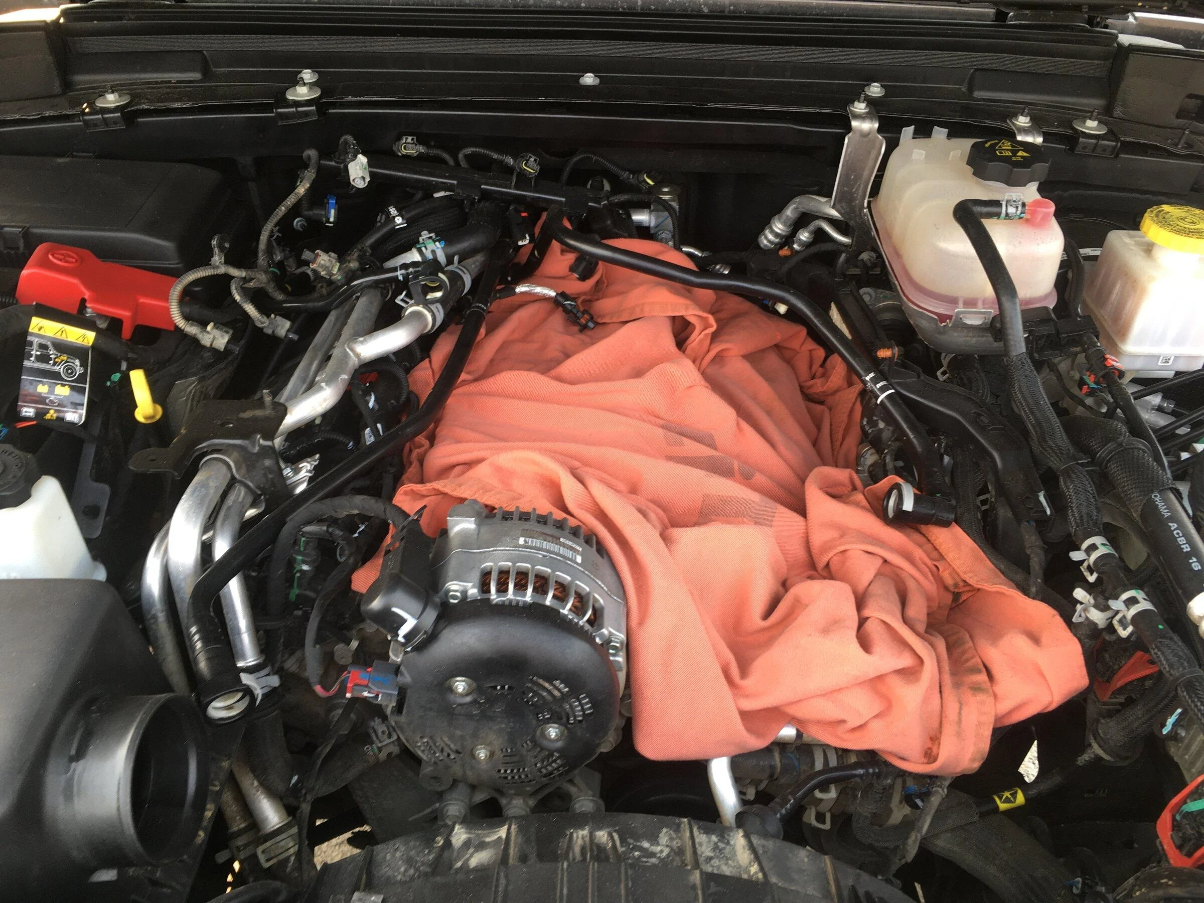

This is how mine sat out in the parking lot for 50 days in July waiting for my cam shaft with air so thick with smoke from wild fires blowing in from BC. The air constantly filled with fine ash. Could have even had rodents running in and out of the rags for a month and a half.
