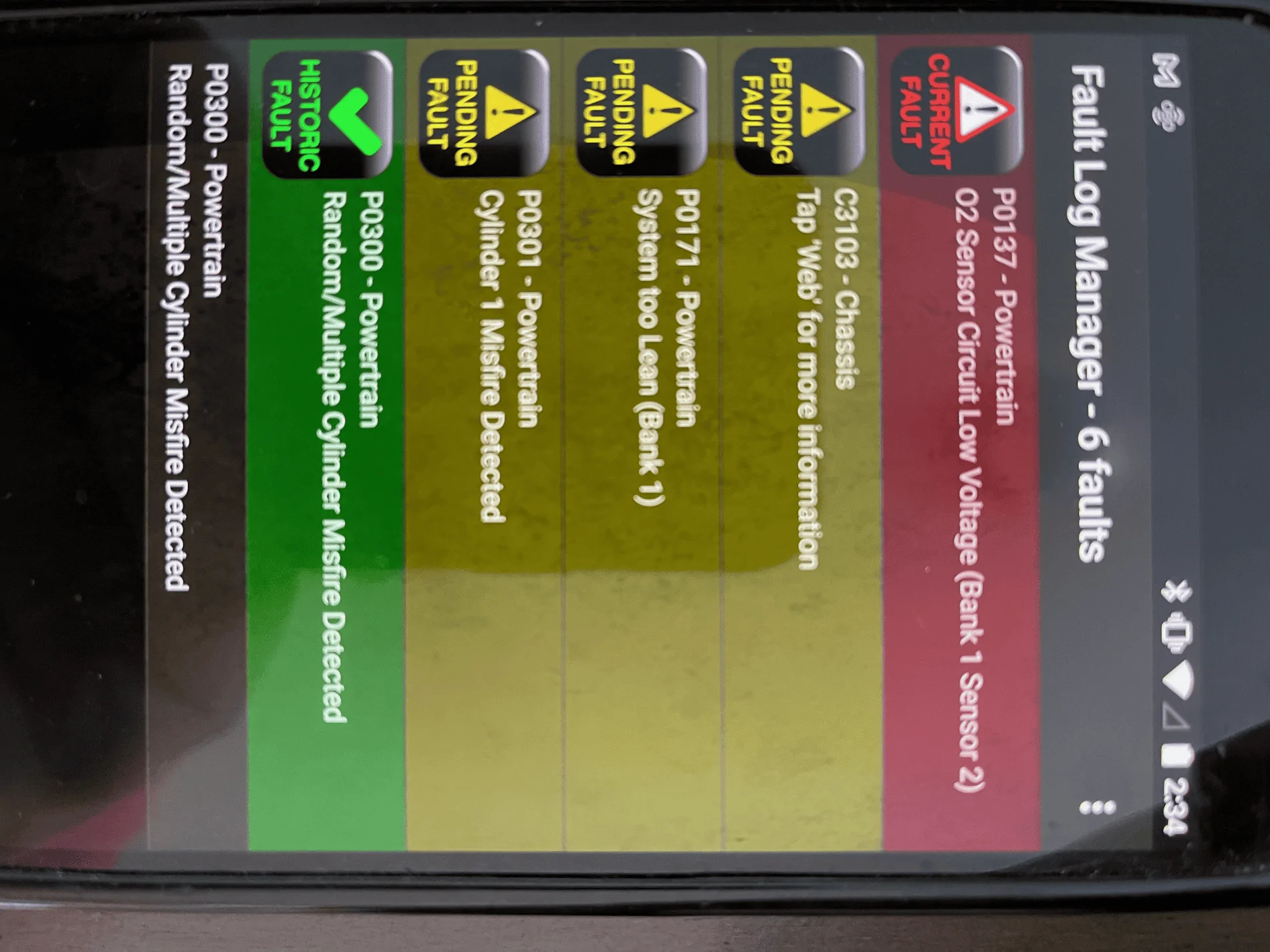

2021 Sport with 3.6 got the dreaded codes yesterday with 3400 miles. All dealers are backed up for weeks. Running really rough not sure I should even drive it to dealer on Monday. Here are the codes it is throwing. And a link to the TSB 18-024-21
Jeep Gladiator Survey- For those with misfire issues IMG_0215

Dealer called today and said it is the valve cover. Bad news is they said the covers are not available and could be over a month before they can order one. That is ridiculous and I would have never spent money on something sold "broken". My wife has a 2021 Wrangler from Feb. So 100K in Jeeps in this house but I can't say I am happy with my decision on this. I called Jeep today and the customer service rep said they would expedite the part but ask me what the part number was. Like really? That pisses me off more than anything as if they don't know about this problem.
So frustrating! If my brand new vehicle has to sit in a shop for 30 plus days to get repaired I will be working for lemon law and getting legal involved if necessary. No excuse. Take a cover off one on the lot and let Jeep pay the dealer while it sits there because it can't be sold.
